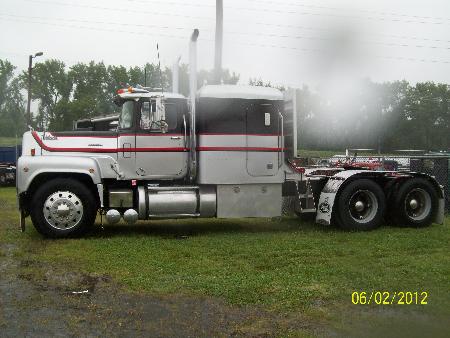

  11. speaking of outlaw Fetterly, here is a pic of his old R700 from the springfield Mass show
