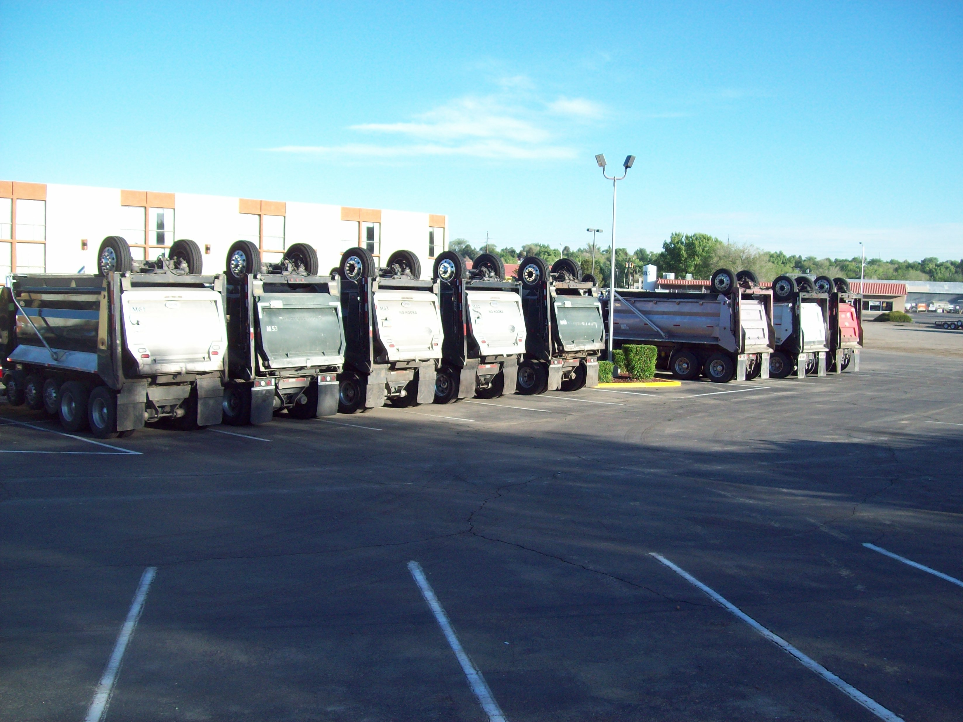

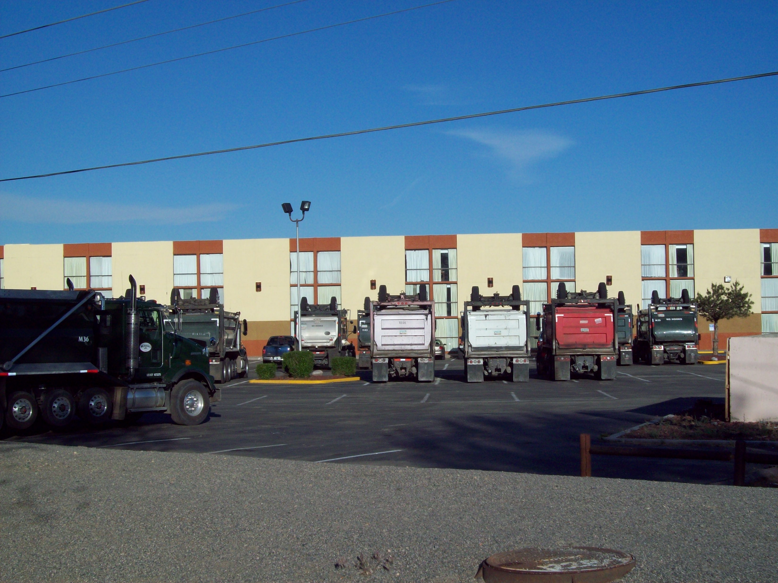

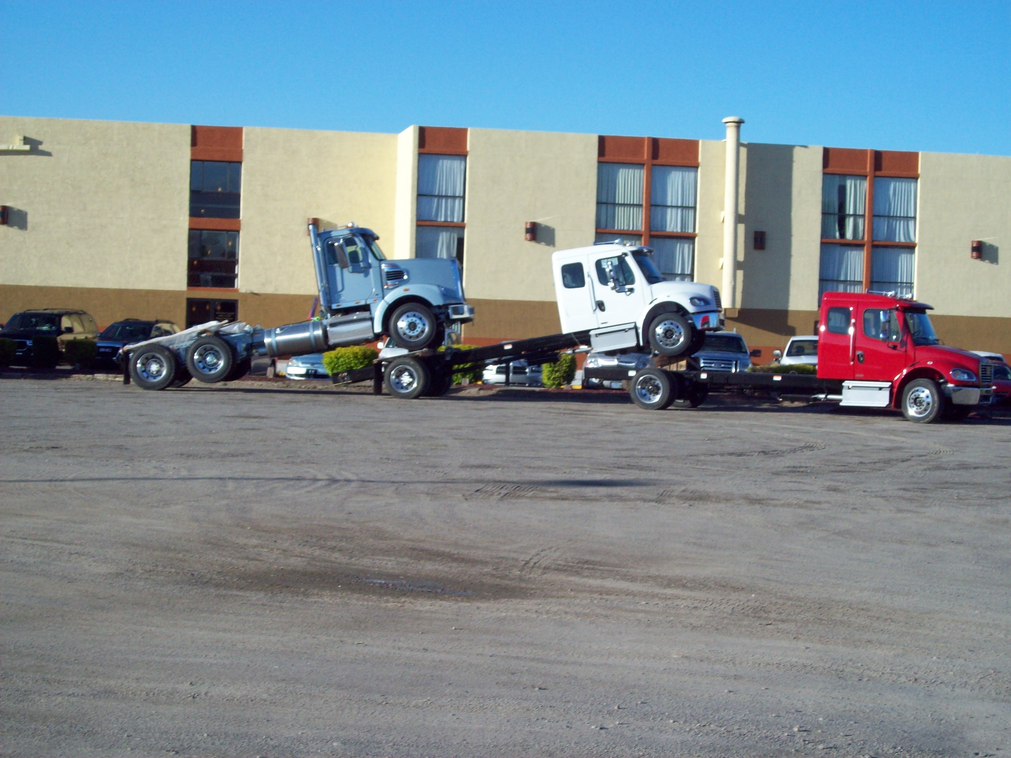

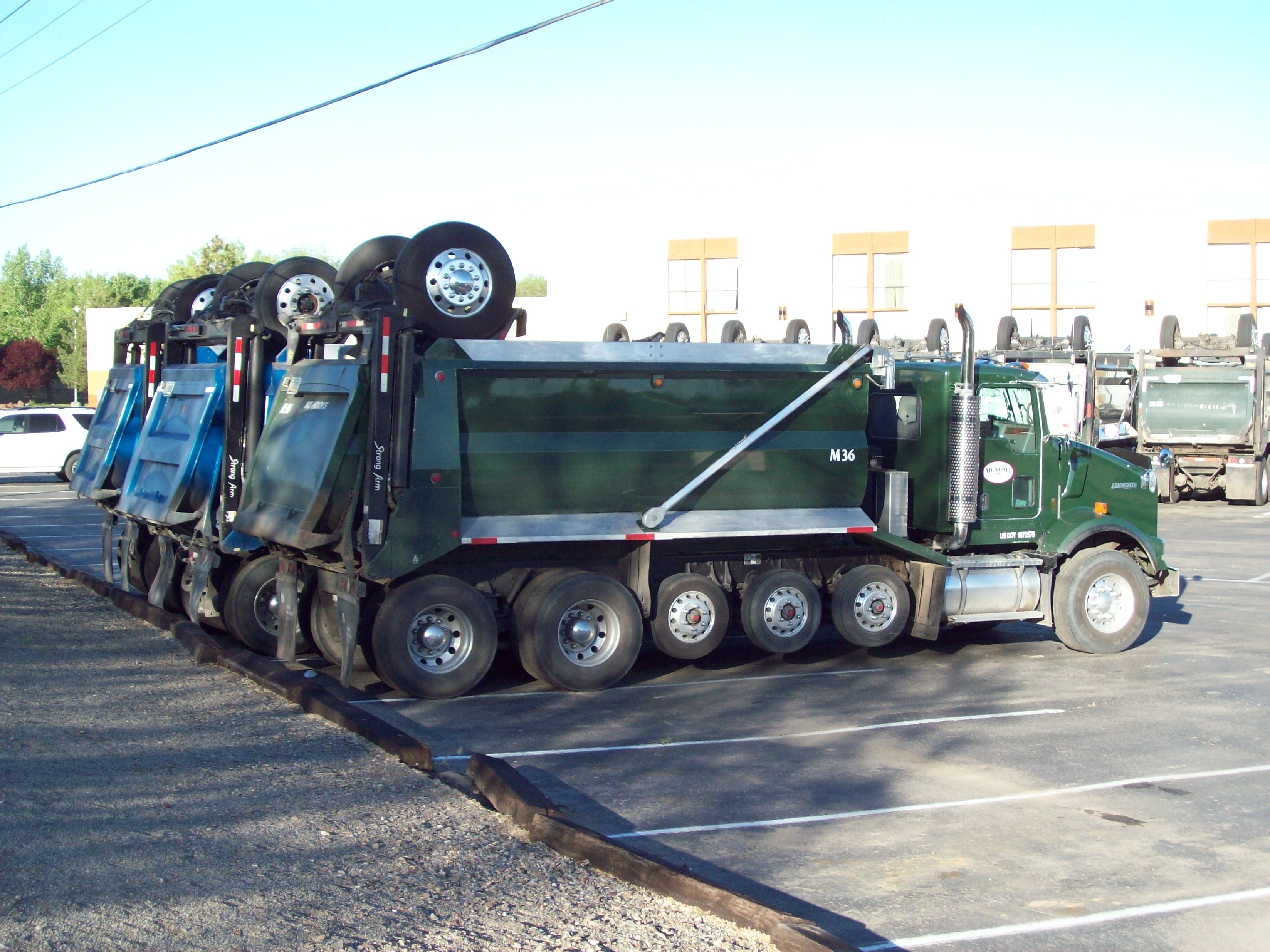

  5. Saw one of these a few days ago but had no idea there were this many of them running around here. I also saw some more Freightliners, oddly enough thee were stacked the way I'm used to seeing trucks transported. The odd thing is that the Coronado is on the back and the lead truck is a Business class (?) chassis.
