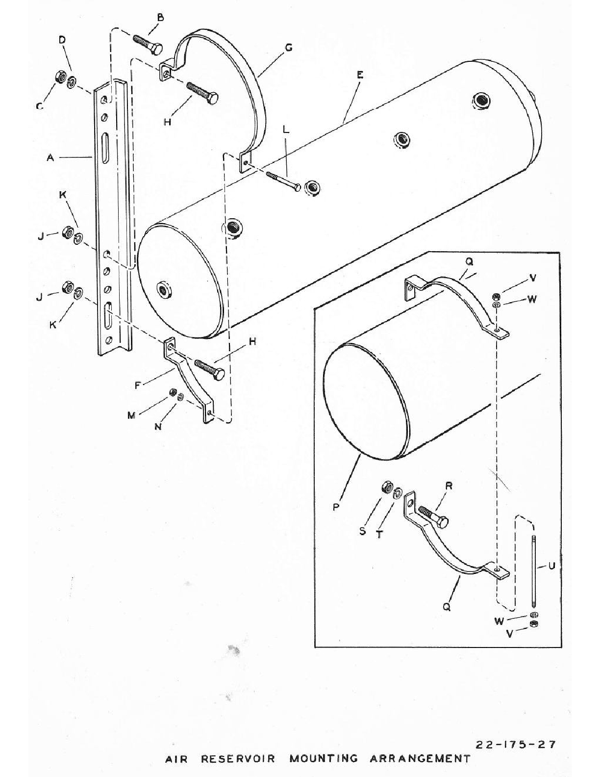

  1. If I remember correctly that is just a length of 5/8" UNF all thread running through a schedule 80 or 120 pipe that has some really heavy washers welded to it. Same setup used on RD and DM chassis.
