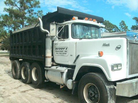

  17. my brother said it would be unamerican to let that icon of a mack truck to leave the states. After a little thought (10 seconds) i think ya'll are right . That nice truck would have chickens and cow shit all over it. And just to think what smell in the cab would be from the steering wheel holder, Whew!! this is the new steering whell turner mun!
  18. sounds like a plan. I probably will have work as long there is someone with a pile of CASH to buy the truck. I have a couple of flatbed trailers w/piggyback fork lifts that i use,but that business is slow also. see at www.buddystransport.com
  19. I have thought of this and would have to follow a truck like yours arund to get loaded. The problem is if these guys are for real they offered be way more than the truck is worth and work is so slow i might call them on it! As it goes i have some work for next week but have not worked with that truck for 2 weeks prior. I am going to see what happens. I am having trouble letting go with that truck to a country like that. It is a real cool truck and i have worked my but off getting everthing to work on it if ya know what i mean
  20. hatcity knows whats up!!
  21. 2 haitian gentleman approached me today and asked if they could look at my superliner dump 1987. I said ok but dont touch anything in the cab. They had me open the hood and they checked it out and were surprised how nice the truck was and it was cold inside also. The stereo was playing a tobey kieth song i think and they had no idea what was up with that. they asked me if i would sell it and i asked what their plans were first before i answered them. they said it was going to be shipped to haiti to work on the earth quake. I started picturing 5 haitians trying to figure out how to start and stop this thing and most of all how to shift the 12 speed air shifter after a couple of minutes, i gave them my card and said call me later that i will think about it. so in the end whatayado??
