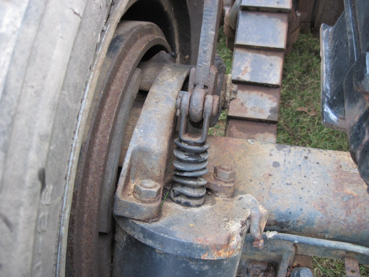

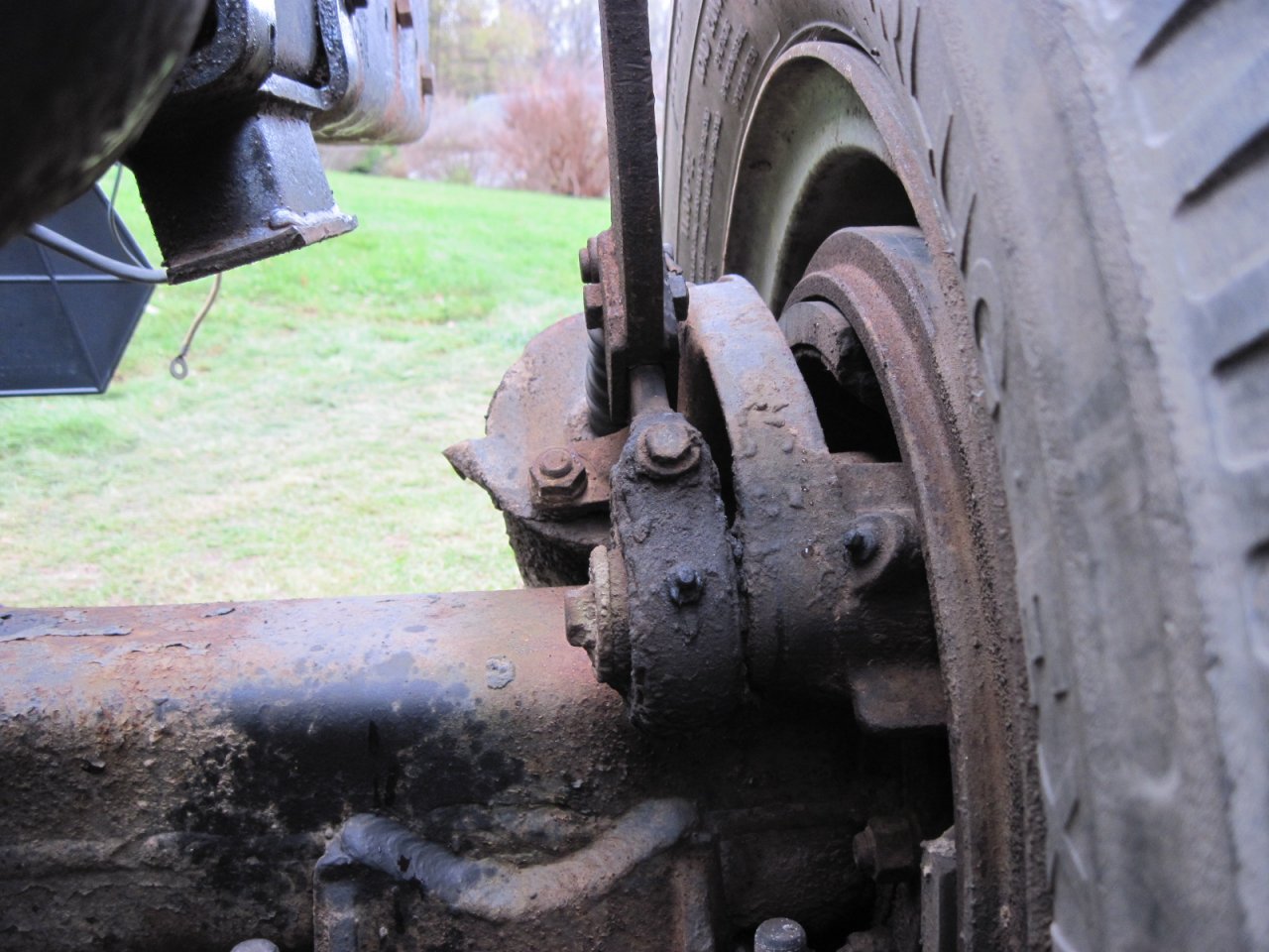

  6. All of my the mounts for the brake actuators appears bent, with the rear of the actuator toward the brake drum, are these bent or are they made that way?

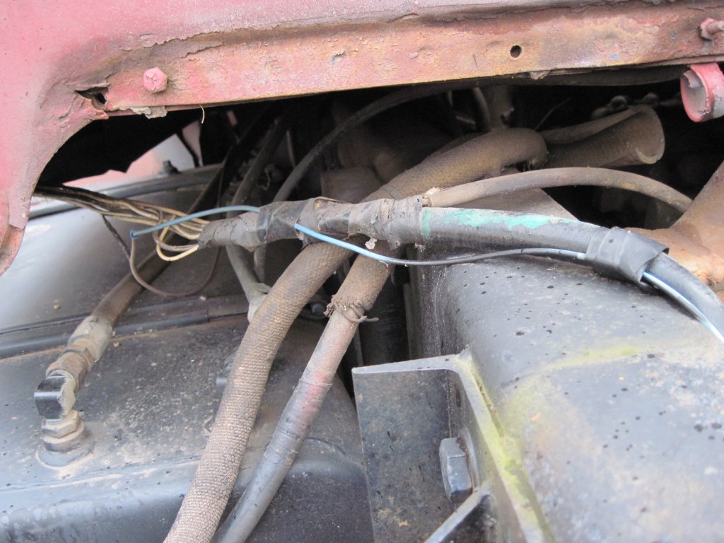

  11. Can someone post a picture of thiers? Looks like mine is MIA...I do appreciate the time it must have taken to pull those wires through a green garden hose! I will purchase an equivelent juntion block and rewire correctly... Thanks
