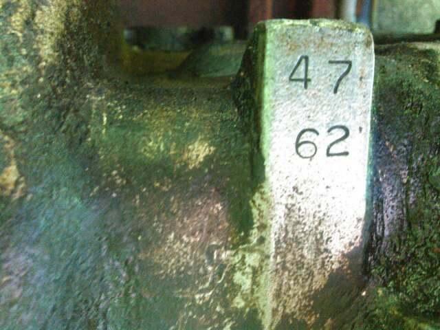

I crawled back under there this afternoon, the only number I could find on the driver side of the transmission was a little flat boss on the bottom side of the main trans, just ahead of where it bolts together with the back box, it reads 47 over 62, does this mean anything? Thanks Keith
