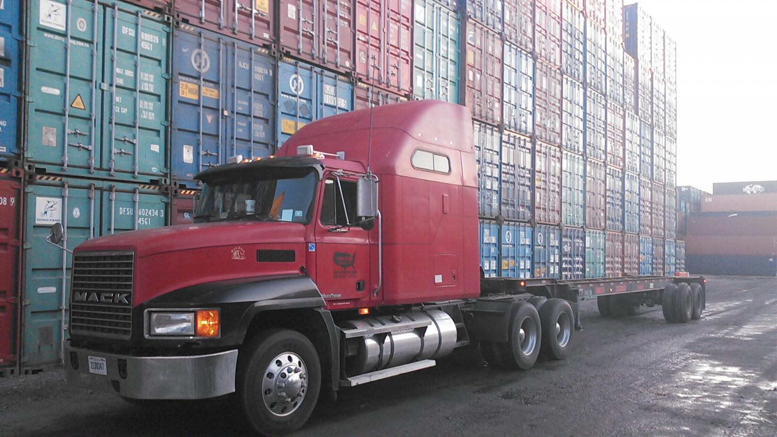

  1. The first picture of the red with black fenders is how mine is painted now, another idea I have for my truck ( perhaps your too?) Is to repaint bright red, with silver bumper and side skirts, and a 2" painted silver stripe vertical passing just under the window. My aviator is of my dads old truck, but thats what I want to do with mine.

  15. Well I'm running regional, whats you 20? I run west to Roanoke and south to Greensboro pretty commonly.
  16. I priced the bumpers from eBay at around $600, 1,400 from dealer, $150 headlight eBay, $400 dealer, plus paint and body. But its really my fuel tank, it was pushed up in the middle, thats where all the money is. I know its just a truck but life's too short to drive an ugly truck.

  19. Two tone fenders? I just hit a deer and plan on doing away with my black fenders.
