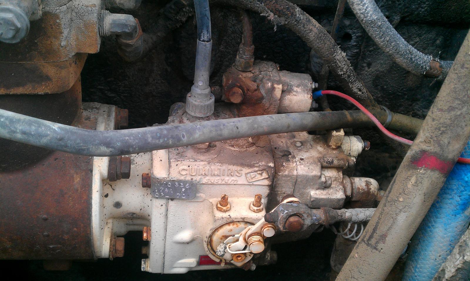

  18. Here's one of the video's we took. The compressor doesn't work so I have no breaks. The Aux tranny won't shift. Next time I'll try to get some speed. http://www.youtube.com/channel/UCr3xwJhOpvRRdXxRj8MLgTA?feature=guide Ben
