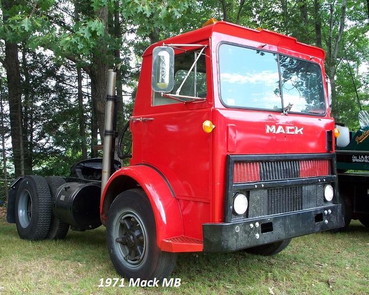

  9. U model started in 1964 and the R and DM started in 1965.
  10. Yellow DMM driven front axle offset cab. Blue RM driven front axle center cab.

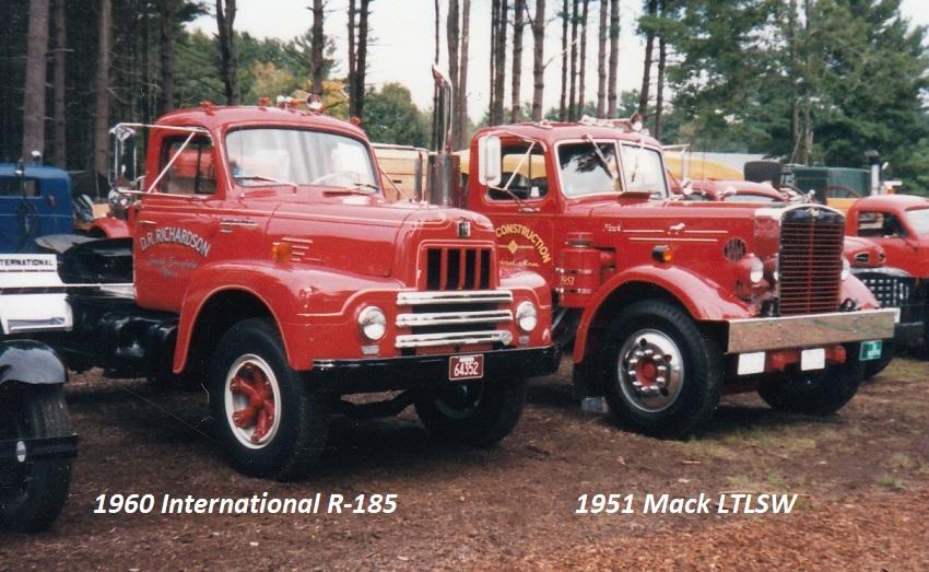

  17. Pictures from the Rutland, VT truck show in 2000. Bright red B75. For Matt Pfahl's green 1955 B61, this was before an engine swap and lengthened frame rails for the soon to be installed bunk.
