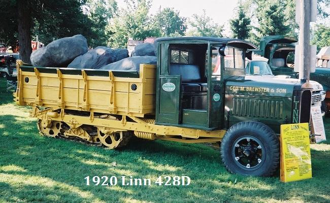

  7. Built in Morris, NY the crawler is rated at 12 tons.

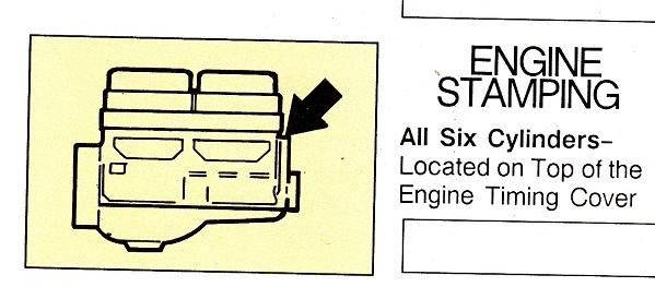

  15. Check for the letter/numbers per diagram for engine block identification. If you can get the full Mack 313GC number off the pump tag, might be able to do some figuring that way as well.
