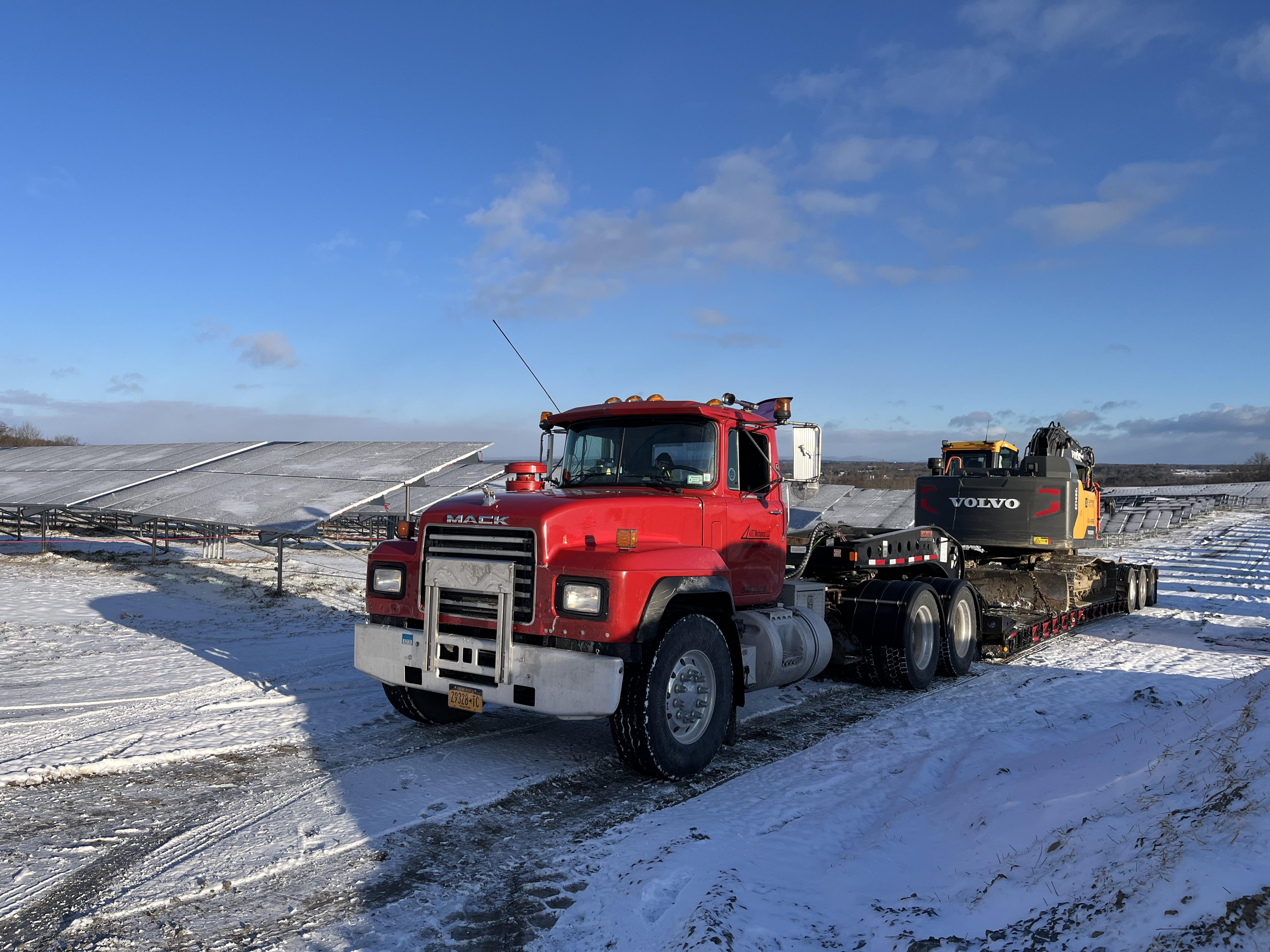

  5. Not much solar power this morning after last nights snow but plenty of Mack power. Truck and trailer get a FULL wash every time after running in the slop. 2000 RD 400 w/ stage 2 Rochester injectors 460 Turbo and ECM, Eaton 18. 2021 Fontaine Magnitude 55L.

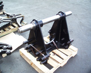

  15. Trunnion stand that is installed from underneath. No need to remove x members, pintle plates, bodies etc. Pic from Stengel bros website.
