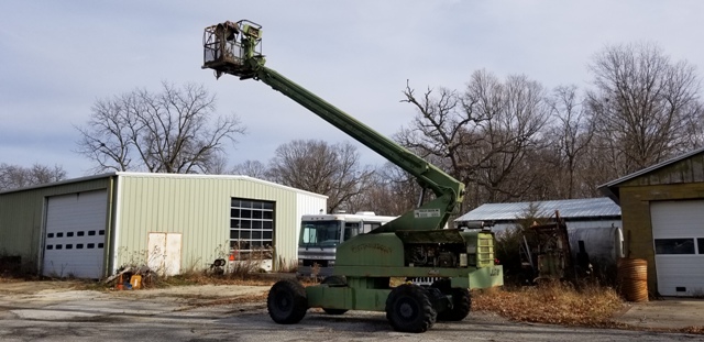

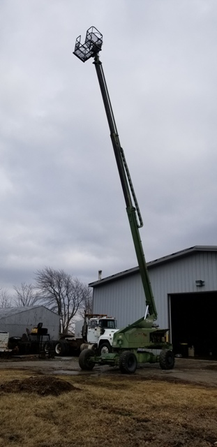

  3. First trip to near full extension. Quite windy so didn't want to go the last 12' or so. The peak of my building is almost 28' from the ground for reference. Very smooth and linear operation from either the ground station, or the basket after rewinding all six proportional control coils. I'm happy but now need to "gut" the original wiring harness(s) out of it and replace with new wire before something burns down. Everything electrical works, but a lot of insulation has been compromised or missing from exposure to the elements.

  5. Rode my manlift all the way up, down, and all around today with the freshly rewound coils, and restrung wiring in the engine compartment. All worked as supposed to now. Haven't begun to "tidy" anything up as of yet as wanted to prove all functions prior to possibly inducing additional failure points. All operations are very smooth in engagement and variable speed with the proportional controls working correctly. I should have the cylinder rebuild kits for the 8" bore main lift cylinder, and 3.5" slave leveling cylinder on Monday. I'll then pull the cylinders from the lift and send them in for rebuild. That will take care of the hydraulic oil leaks and I'll be able to keep a clean shop floor again. Right now this is one oil puking pig when lowering the main boom as it sprays oil out of the rod seal and gland. I'll be happy to have that stopped.

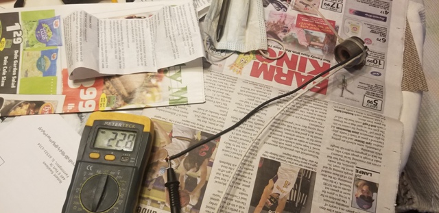

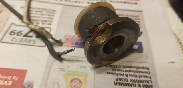

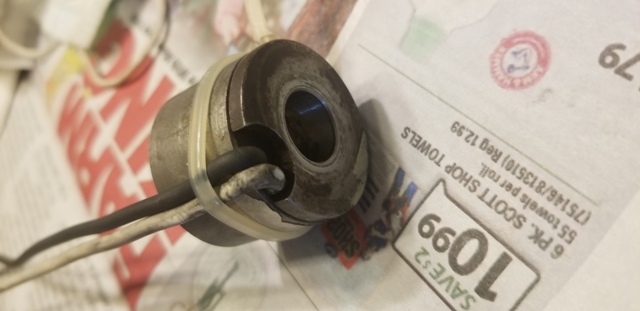

  20. Older JLG manlift I've purchased: 80' reach and they'd been operating it manually from the ground. Most of the coils were open from age and vibration so I now have all six rewired in the proportional controls. Those coils from JLG are $174.00 each without a "kiss". I have about $50.00 in wire and insulators into them and they are all measuring close now. I tell everybody I'm getting too old to be climbing on long ladders any longer but in reality it's just I'm lazy, (don't tell nobody) and this will be a lot easier once the electrical is brought back serviceable. The mechanical, and hydraulic portions all work very well, but the controls were a mess. I muddle through it slowly with all functions now working. Once it warms a bit I'm going to stretch some new wiring as it's mostly deteriorated from age/exposure with insulation readily falling free. There is plenty of 16/24AWG, 12/5AWG, 12/4AWG, 16/5AWG, and of course 12/3AWG and it's all SOOW cord. I've already acquired everything needed, but awaiting warmer weather before going into this aspect. Just last week I was able to secure a point to point wiring diagram so I can rip out the old wholesale and start anew rather than reinvent the wheel.

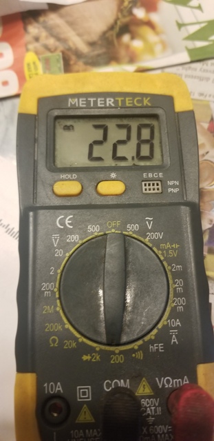

  21. Attaching new leads onto the 28AWG coil wire. The friction tape is some "gummy" crap to work with: Specification calls for 20.5, to 23.5 ohm resistance to operate the proportional controller. I hand wound 364' onto this bobbin to attain this reading:
