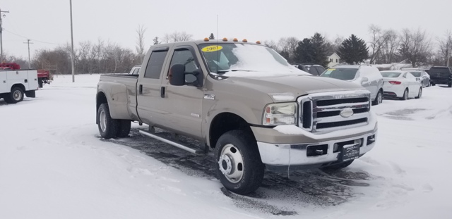

  4. Truck is out of the running. I spoke with the prior owner after promising anonymity and was informed the oil cooler started putting coolant into the oil and the engine started to lightly "knocking". After being towed back to the dealership, it was traded on another truck for his camper, not a car as I was also told. This was last August. Also, this was in San Antonio, TX and not central Illinois as I was lead to believe. "Snowbird"? Nope; never been to Illinois except touring Chicago many years ago so even that was a lie. This truck is obviously an auction purchase they know absolutely nothing about. Been around cars long enough to know some of the shenanigans that take place but this one really "takes the cake". I've learned lots on this engine and am grateful for the knowledge gained as I'm now a lot less hesitant to consider a 6.0ltr engine powered truck. And it all started when I snapped a photo of the vin number to do some investigating of history. Thanks a bunch to all whom responded as I really appreciate it.
  5. This one is seemingly panning out to be an honest unit yielding good service to the prior owner. Unless something major falls out from the deal, I'll wind up with it. Been reading a lot on the internet today about these engines and they really don't seem too bad at all; lot's of misdiagnosis seems to be a common trait. Given the way the coolant flow is through the engine oil cooler, followed by the EGR cooler, it makes sense to me to replace both rather than just the EGR cooler itself only. I've seen my fair share of bad water pumps over the years that don't leak externally also, so I'd think it best replaced when the system is opened up.

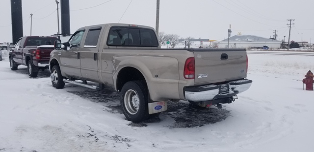

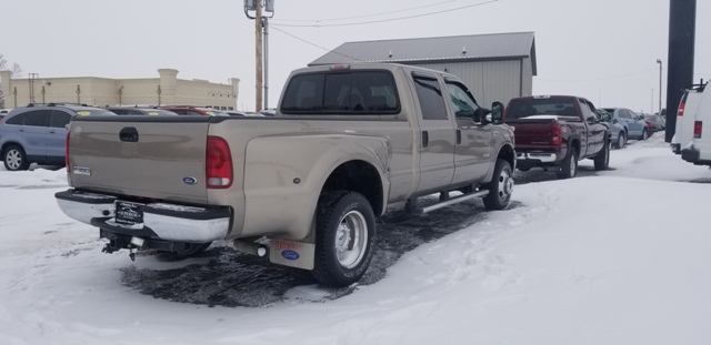

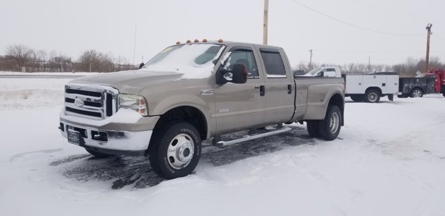

  13. Found this truck as a possible candidate to replace my trusty, but crusty old Dodge which I've been forced to removed from service. The frame has literally rusted in two and the truck is no longer safe to operate; nor worth the effort to repair. I've located this truck which is a 2007, and supposedly from Texas. No other history than that I'm afraid. The selling dealership only knows it is a new car trade and has no history. Odometer shows 189K so one of the better 6.0 diesels from what I've heard and read. It did start right up cold at -2 degrees yesterday but I did not drive it. I'm told it has yet to go through their shop for checkover as it's just been received so not ready to sell it yet. I know these diesels can be problematic if updates have not been done and maintenance routines are kept strict. Also I feel front ends are originally weak but aftermarket parts take care of this. I'm concerned about the engine and whether it may or may not have EGR problems, sticking vanes in the turbocharger, cracked or leaking degas tank, etc. I've not looked into any of this as well as a hot restart problem these are known for before upgrades. I have the vin and going to speak with a couple of Ford dealerships to see if anything can be learned for history today but that won't do much for the aftermarket. The selling dealer tells me he'll get the information from the original owner for me to speak with also. Here are a couple photos. Very clean truck and shows honest. I'm wanting four door for the expanding family and a standard cab pickup is just too small any longer. Length of course does not concern me. Any advice or wisdom to share? Thanks, Not the "showiest" damned thing, but if proven reliable it will fit the need as I need a work truck.
