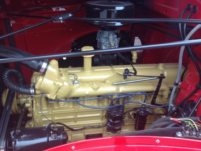

  5. The REO engine only had two nuts retaining the rocker arm cover where the Continental OHV engines used four IIRC.

  8. Both the REO Gold Comet, and IH Red Diamond series were popular engine swaps when these trucks routinely operated. Considerably more power than the EN-401/402 Mack flathead gasoline engines.

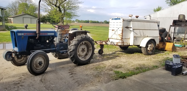

  16. I would agree Paul but I'll not use it for anything except moving trailers around the property to mow. That air compressor has almost 350# of tongue weight to it when horizontal to the ground and it is so much easier to not have to use a truck to move it. I purchased that tractor in April of 1997 out of the weeds as the owner said the engine was blown. All it had wrong was a rusted/corroded starter motor brush holder. After telling the former owner what the problem was and offering the tractor back to him for repair costs, he told me "I" got a good deal on a tractor has he'd already replaced it. Been a good one and I like it but "Honkey" is so much nicer to mow with having the power needed for my mower deck.

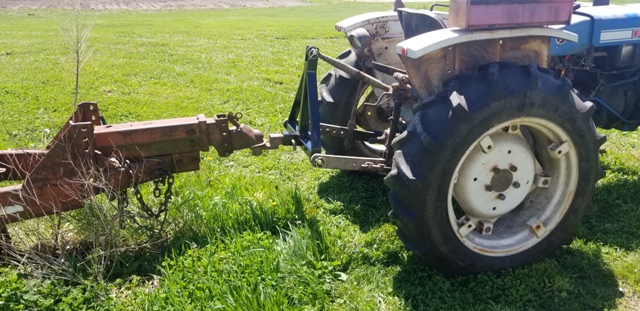

  17. SOB I like this hitch. Makes moving things around the shop so much easier: Back up, lift the 3point and go.
