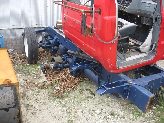

Yup. Probably a replacement front drive and the bolts didn't get properly addressed, worked loose through use, and departed the mount. Looks like an aggressive driving style was the final nail in the coffin for the parts. Truck probably needs greater attention than just the torque arm.

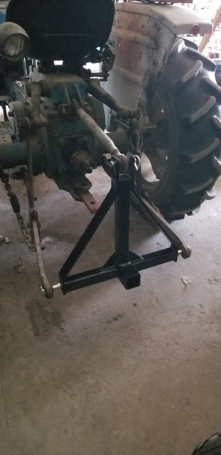

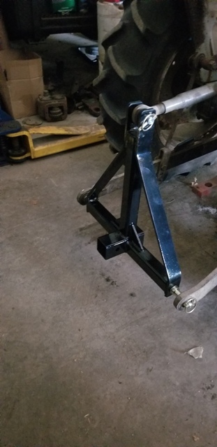

Hitch arrived today and I'm quite happy. Very heavy built and good welds. Maybe China built but it is "Titan" attachments out of Memphis, TN branded. Only thing I didn't like was no lock washers where the bottom pins thread into the weldment for retention. I installed grade 8 split lockwashers and blue Loctite on the threads so it's shouldn't vibrate loose.....

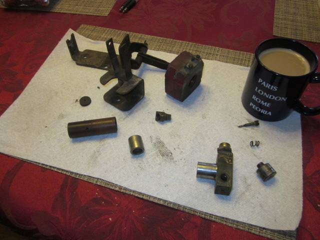

My wife learned long ago that bitching about anything I do falls on deaf ears so she quit with that nonsense. I've rebuilt carburetors, governors, and pumps on the kitchen table and boiled the same castings on the stove. This is the governor for my Hobart engine drive welder: She says it "stinks up the whole house" to where I just think it smells more "Natural". However, I will tell you she really does not like the smell of methylene chloride which excels at cleaning parts not containing rubber. You are correct in the submerging of an air receiver to check for leaks. I too have seen air start systems hold air for months but they use much higher quality sealing valves than this simple Bendix steel wafer disc style. At the shop I have a 60 gallon oblong galvanized livestock watering tank I use for truck tires and such. It is large enough to submerge about 1/2 of an 11R-24.5 tire into to look for bubbles. I usually use a soap solution generally marketed towards the HVAC trades as it is very slow to evaporate and readily makes bubbles being sensitive to leakage. I gotta try the movie ticket trick to get her out of my remaining hair for spell every now and then..... Thanks,

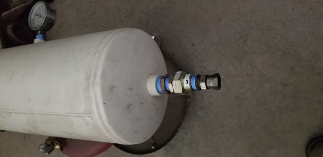

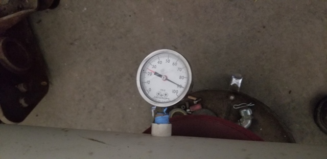

New wet tank. I want to ensure all tanks are good before installing under the truck. This one is new in 2000 but never installed and shows the inlet check valve holding the pressure back for the past two days. It was charged via the Tu-Flow Bendix compressor discharge line of the B-61: Charged to 100psi, (indicated) on Thursday afternoon: A loss of 10psi over two days is probably acceptable but I can't ascertain where the leak would be with soap bubble solution. These tanks were less than a year old when the the truck had a cab fire. The rear rear is under my B-61 after total suspension rebuild: I suppose R model Mack donor cabs really haven't quite figured out how to properly set on a Peterbilt frame???? Needing to grab a few fittings from the hardware store to plug openings in the other tanks to evaluate them later.

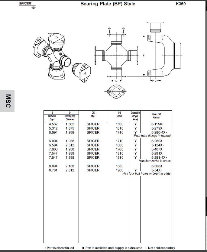

This will help in determining spread. I was incorrect earlier measuring across the inner dimension. It is 6.094 across the outer bearing plate mating surface for the 1710 series: -

Being a hobby truck you could tighten them up with green loctite but they really need replaced. The 1710 series driveline was common to oblong those bores as well as spread the yoke so that should be checked also. IIRC the inner dimension on the 1710 is 3.092" and if spread much they will not retain grease in the joints. On a hobby truck not so bad but a working unit tends to spit the driveline citing lack of maintenance. -
