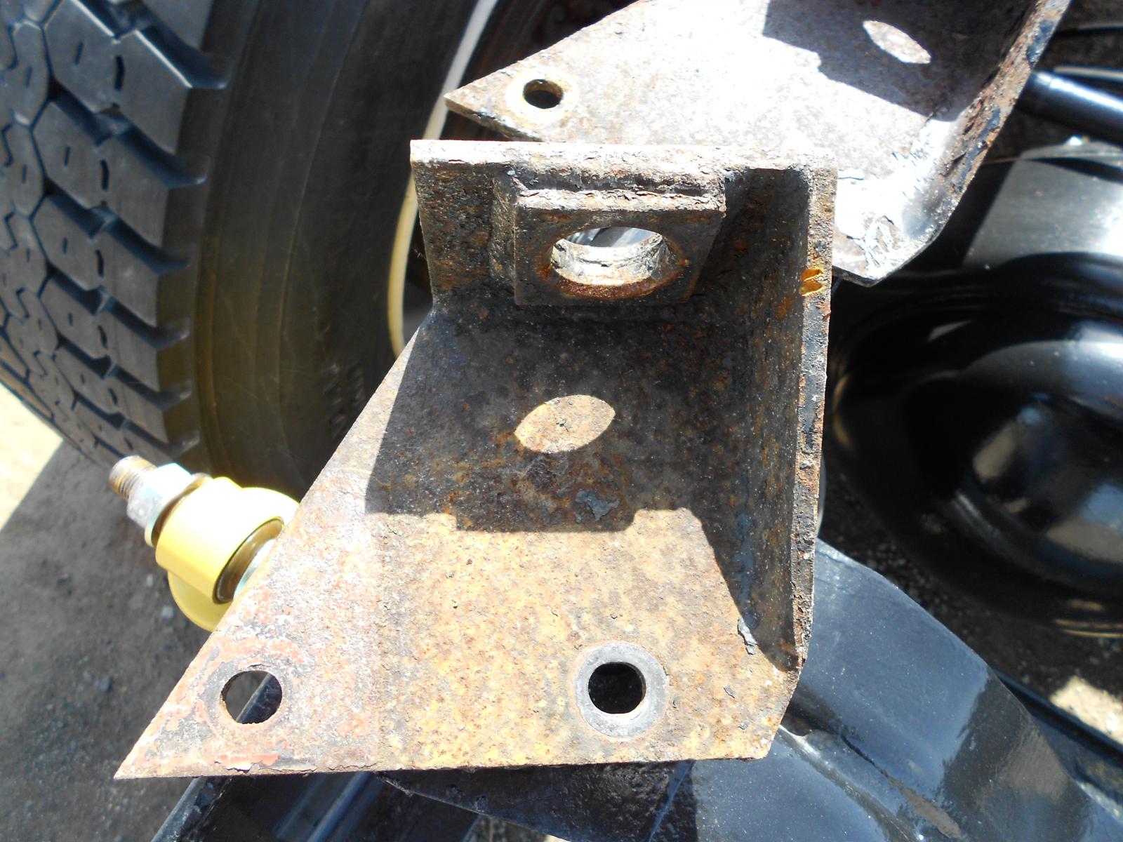

  20. Here's thse pics I promised.These are 5 1/2 inches high, 7 inches at the bottom, and 3 inches wide at top.
  21. I've got mine off, I'll take a couple of pics today and post them tonight.Steve
