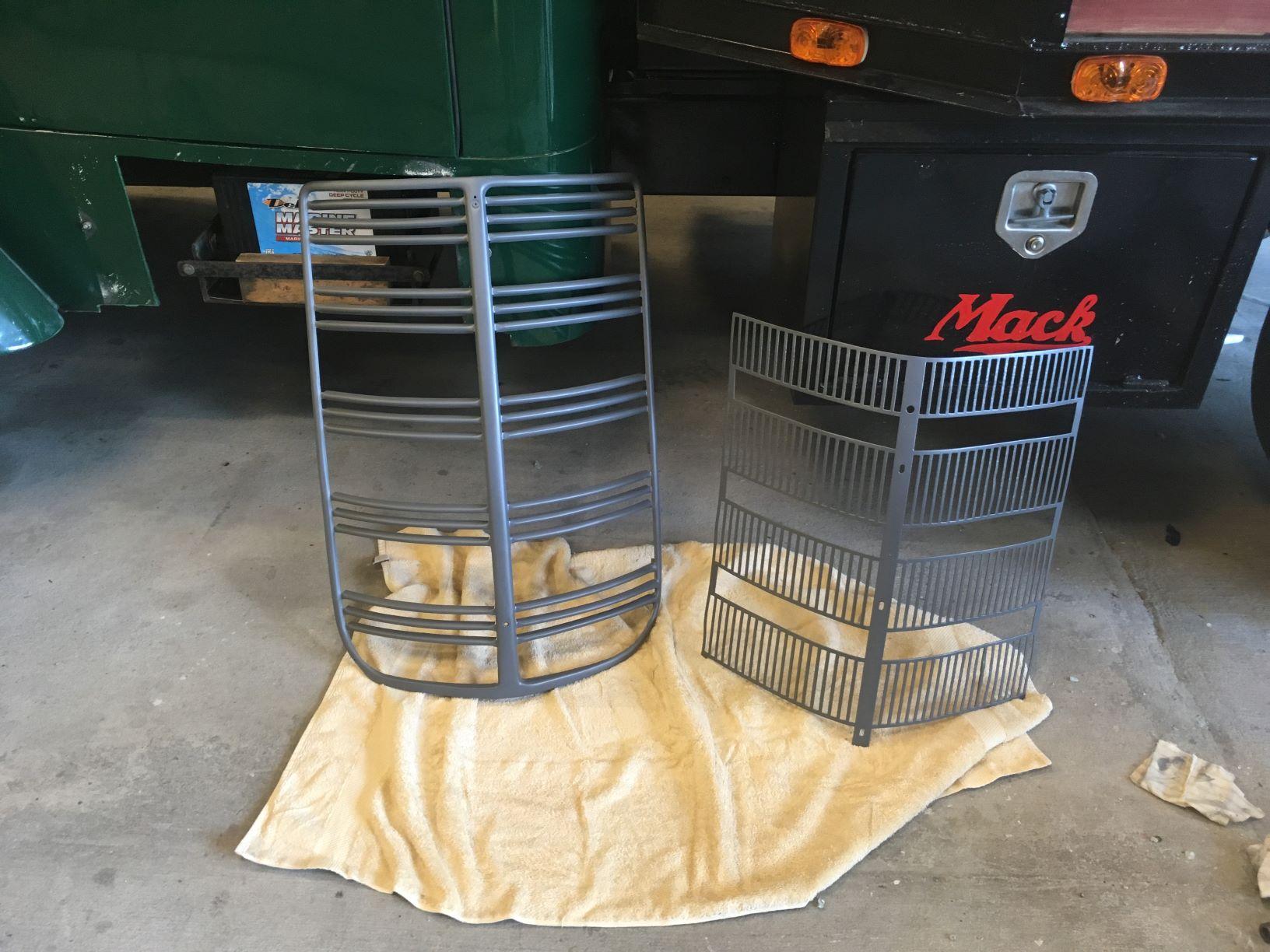

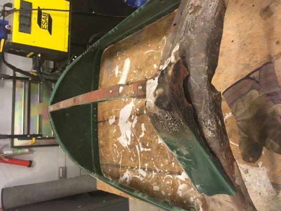

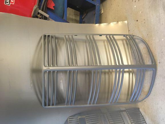

Discovering things may not be what they seem. At first glance the nose piece and grill looked pretty good. In the process to replace the radiator bushings I opened up a can of worms. I discovered the lower end of the grill was completely rusted away and bondo-ed to the nose piece with thick layers of bondo. I am in the finish stages of the grill and the grill back piece having had to make a new bottom for the grill and repair 9 up right pieces on the grill back piece. Working on the nose cone now. These delicate pieces can really try a man’s soul and worth every minute in the preservation of Mack history. In the end I will have a survivor not Concours’ quality restoration! Sorry it looks like 2-pics are on the side
