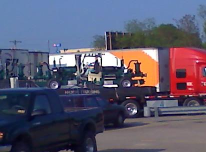

I'm sitting eating breakfast this morning. I looked out the window and saw a guy sitting on an odd machine looking toward the restraunt, a few minutes later I looked and he is still looking. So I watch him for a minute, thinking it's odds he is on the machine "what ever it is" on a flat bed posing. Well he never moved. Why you might ask? Well I'll tell you!! The aluminum wheels are part of a load on the first flat bed, behind that one is another flat bed with gas pipe line fittings and pipes, behind that another gass line flat bed, behind that is a moving van, box truck, with a picture of a guy sitting on a soffa on the side, thats the driver of our mystery machine. Notice the feet position was perfect and his hand is on the wheel. I took the pic with my phone.

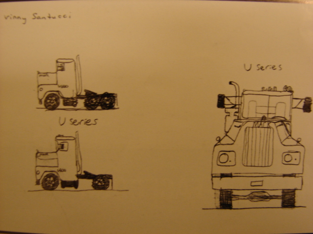

Nice work Vinny, I'll post the only picture I have left I did when I was 17when I get home . Drew pictures all my life but got lost or thrown out. That was pretty crazy reading Bulldog and seing your name. -
