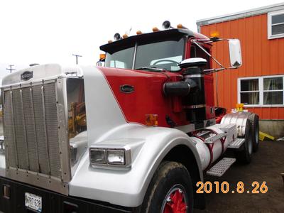

  7. Heavy duty truck, limited edition unit, 425 Cat with a 3 line heavy duty wet system, double frame truck. Fresh paint, come look you wont be disappointed.207-276-4034 it's in Maine not mine just looked interesting for the money. 12k obo
