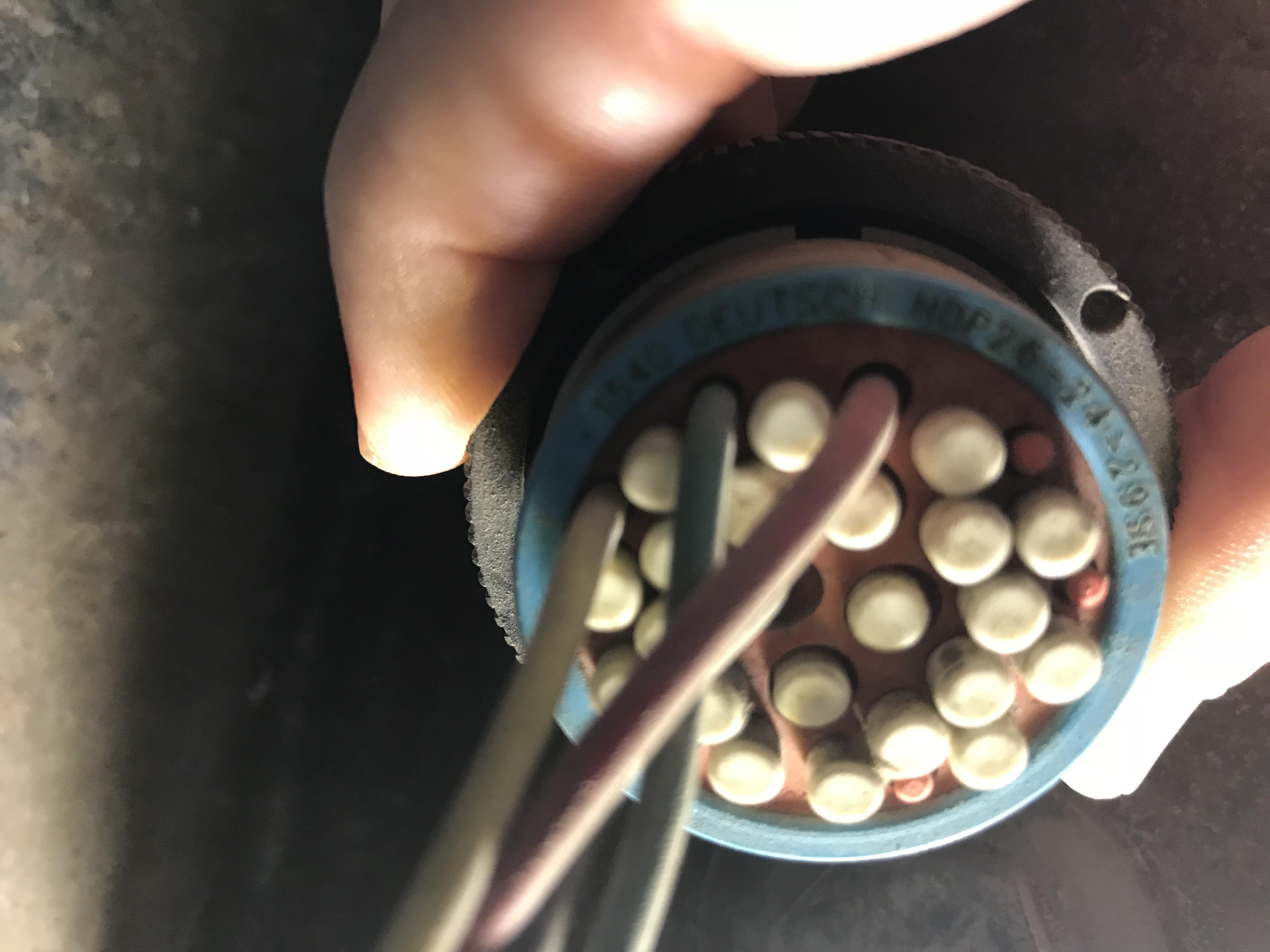

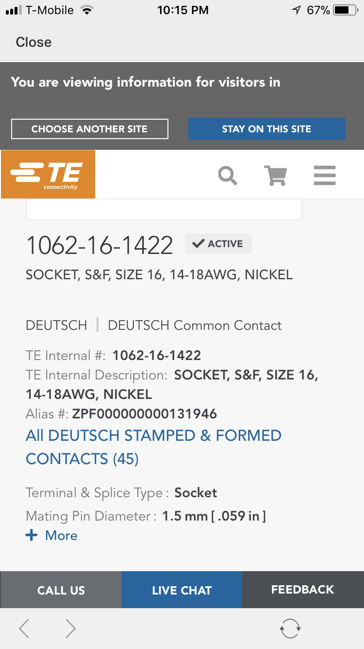

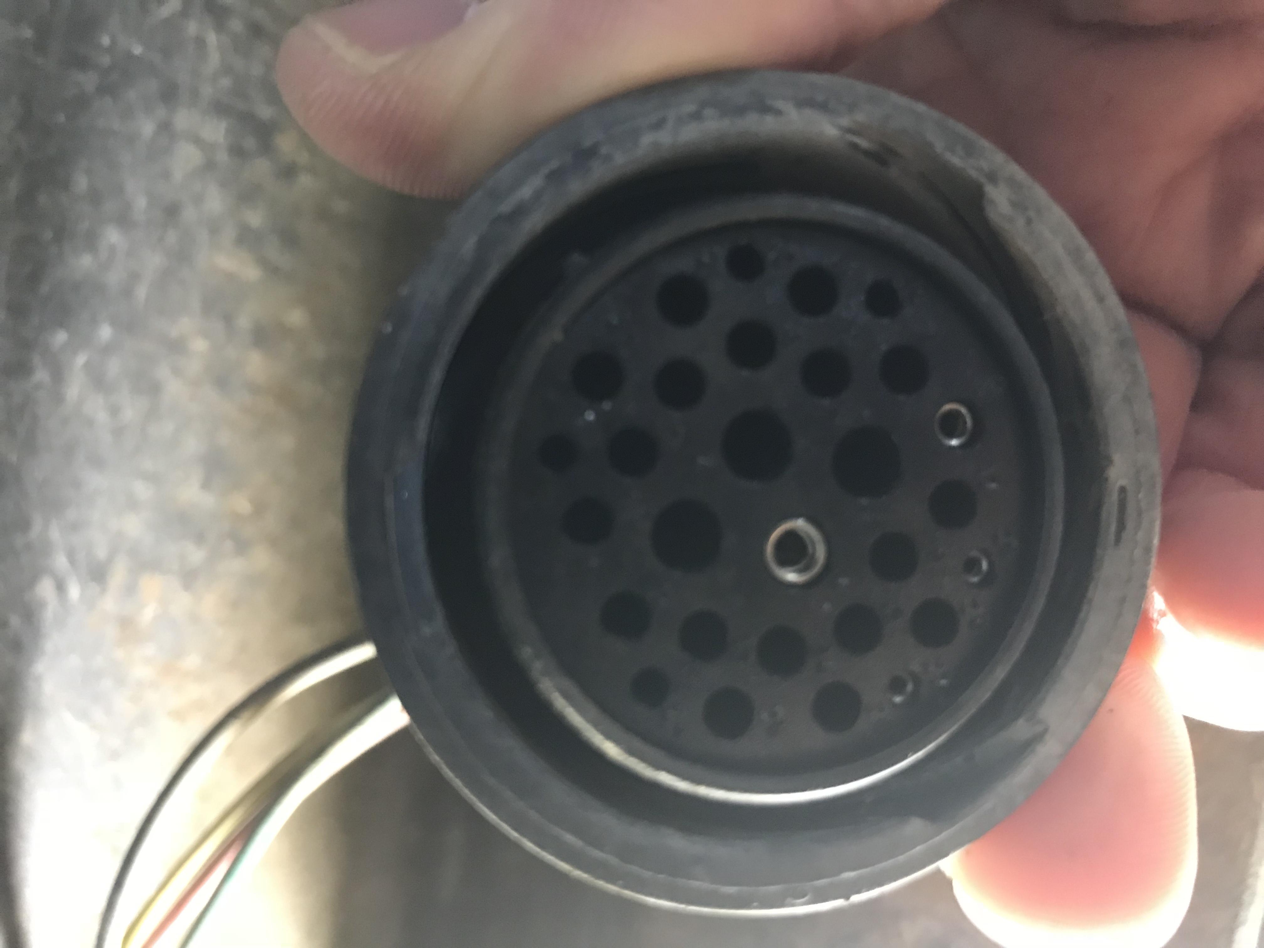

2016 Granite Auxiliary Switches
EWB555 replied to EWB555's topic in Electrical, Electronics and Lighting
I figured it out and wanted to share. There is a body builder connector under the back of the cab on the drivers side. Fortunately they put a label above it on the back of the cab that tells you what each pin is. On our truck only the stop, run, &turn lamps are wired. Ordered the deutch socket online for that particular connector and was able to wire my stobes to one switch, and the plow lights to the other. You crimp the socket to your wire and slide it in to the blank slot across from the corresponding pin. It’s a nice setup. I attached a screenshot of the socket part info and pictures of what the connector looks like in case anybody needs them. -
Can someone please tell me where to tie into the circuits for the key on and battery accessory switches on a 2016 Granite dump truck? Pulled the entire dash apart last week and cannot find the leads.
