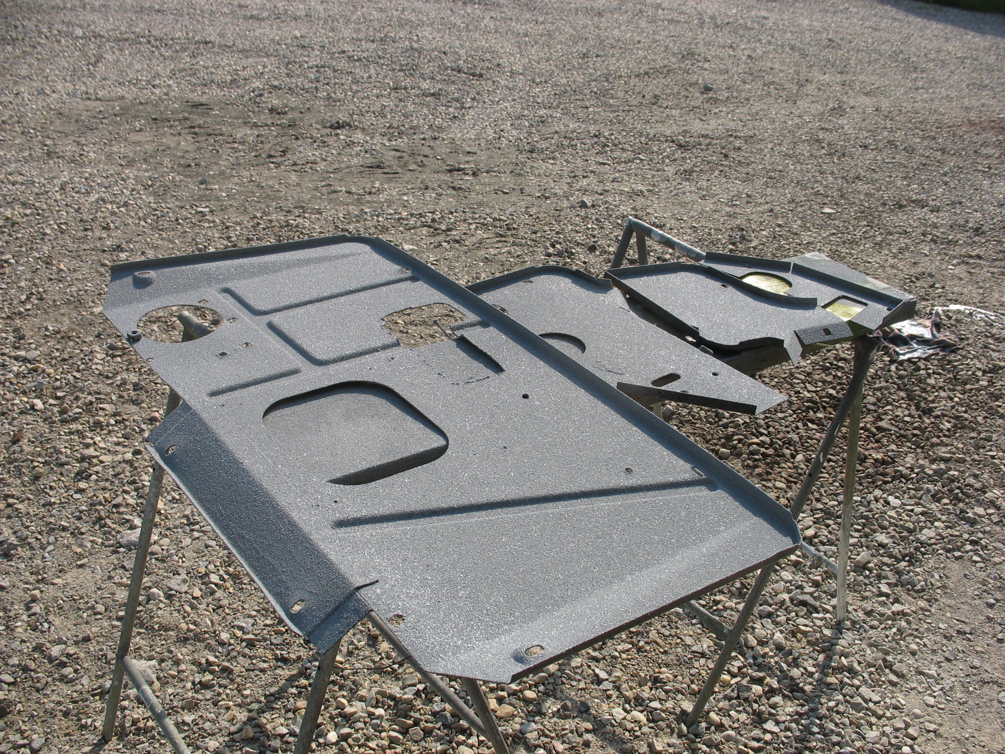

  9. Painted the inside of cab and parts today. Used OMNI 45735 and Ma-Hyde Wet Look Hardener. This is supposed to the correct color but looked as if it had to much metallic in it. I wonder if the original paint was a metallic at all.

  18. Thanks I plan to use Dynamat on the inside when I get it painted . Is there enough room between the firewall pad and firewall to install Dynamat ? I think most of the heat and noise would be from here.

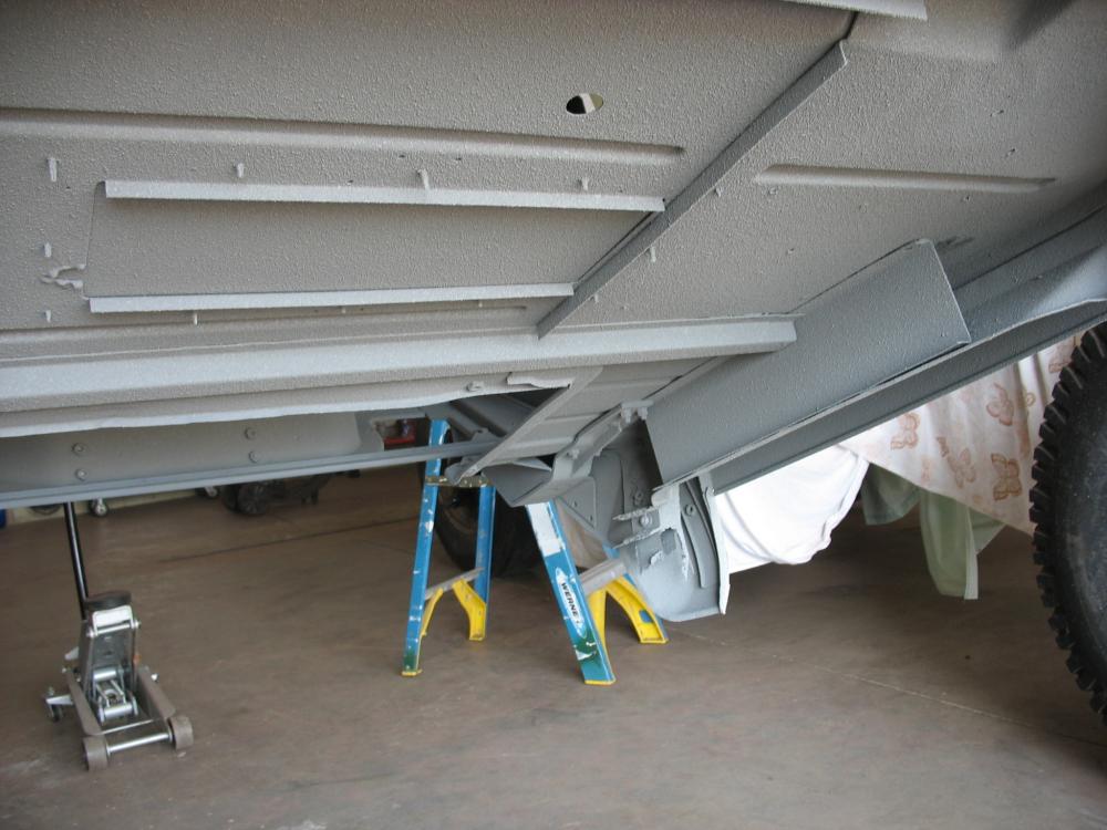

  19. Since I had the cab off thought I would apply some lizard skin to the inside firewall and under the cab floor. After reading the reviews on lizard skin grease ,oil ,fuel, U.V. and some chemicals cause it to lift unless top coated. Decided to try Eastwoods Heat & Sound Barrier coating 2 part catalyzed combination. Should help some.
