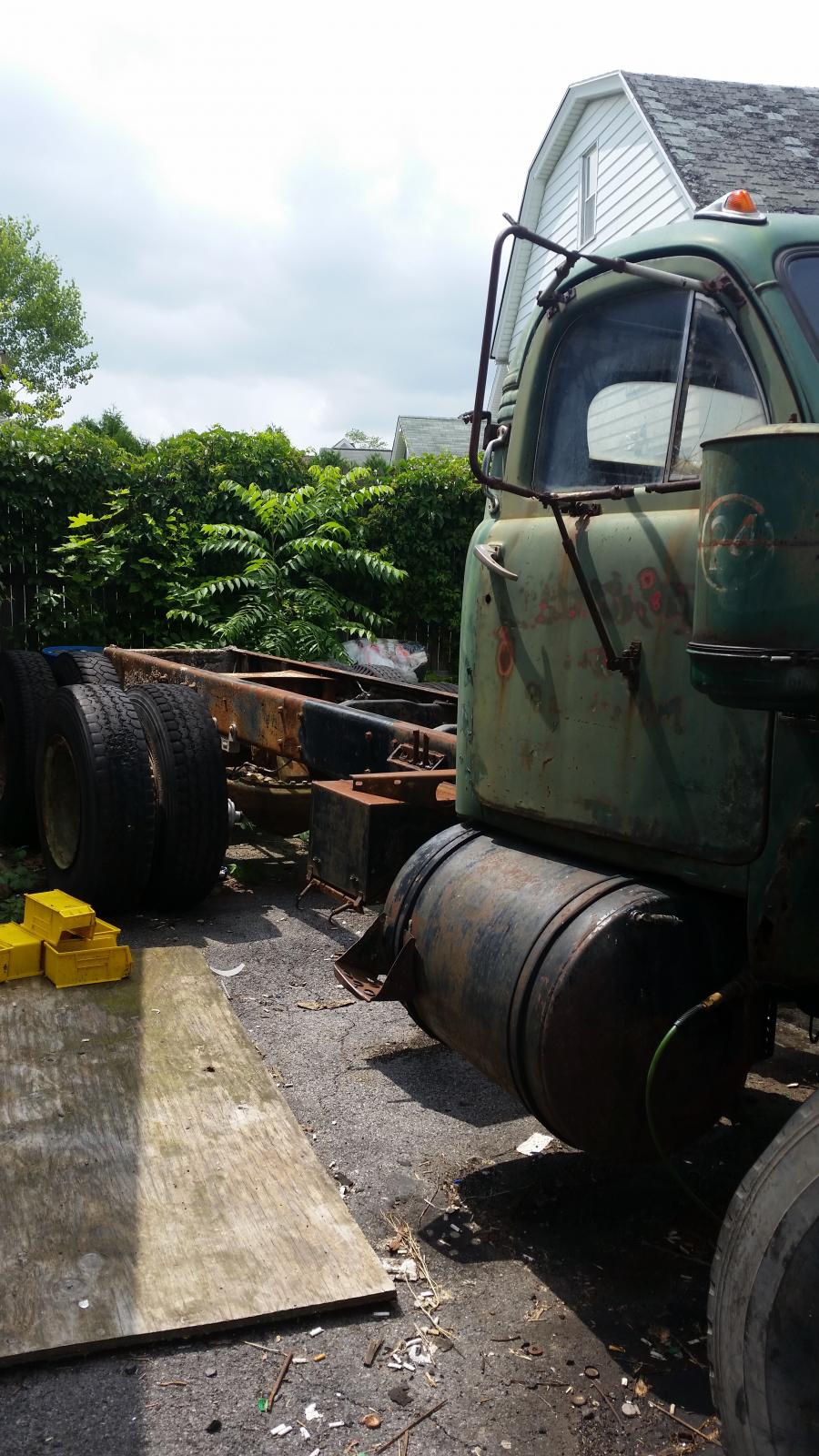

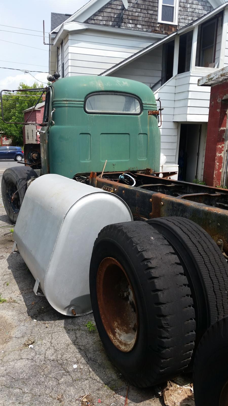

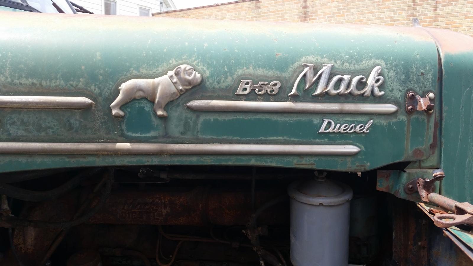

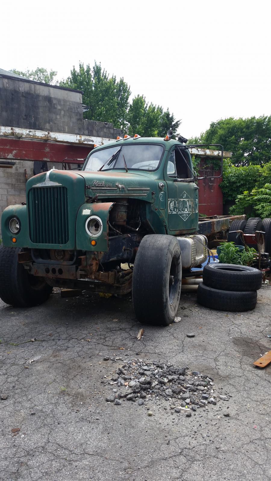

As promised, here's a few pics. The first one in the weeds with the mixer still on, and the second two tucked away in the corner of the parking lot at her new home. -
