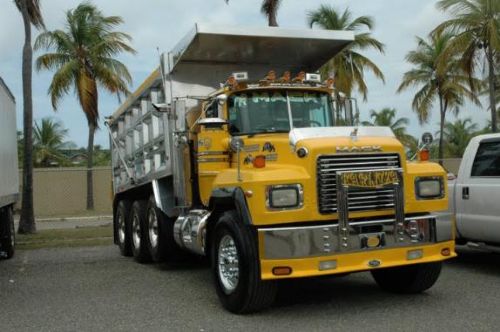

Well...thats not mine... i was asking from the picture where to get those parts? windshield logo, visor with MACK lettering, and the bumper addition. -
getting my own christmas list together and trying to find some cool additions to my RD. Here is a few i need help on. The logo on the windshield? The chrome visor with Mack lettering on it? and is that bumper addition custom?

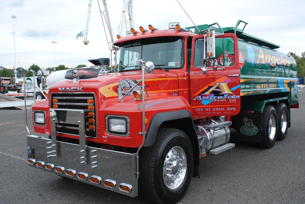

ram for breather
krismoriah replied to krismoriah's topic in Exterior, Cab, Accessories and Detailing
this may be it...very crappy picture but maybe... googled the virgofleet and found this... http://www.virgofleet.com/search_output_two.asp?PRODUCT_ID=CH630&LEVEL2CATEGORY=Air%20Breather%20Inlet%20Hoods&CATEGORY=Mack&MANUFACTURER=Air%20Breather%20Inlet%20Hoods&PageNo=1 -

on the passenger side sticking up is a very nice 'ram air' style breather...but i cant find any that look like this.. any ideas?
