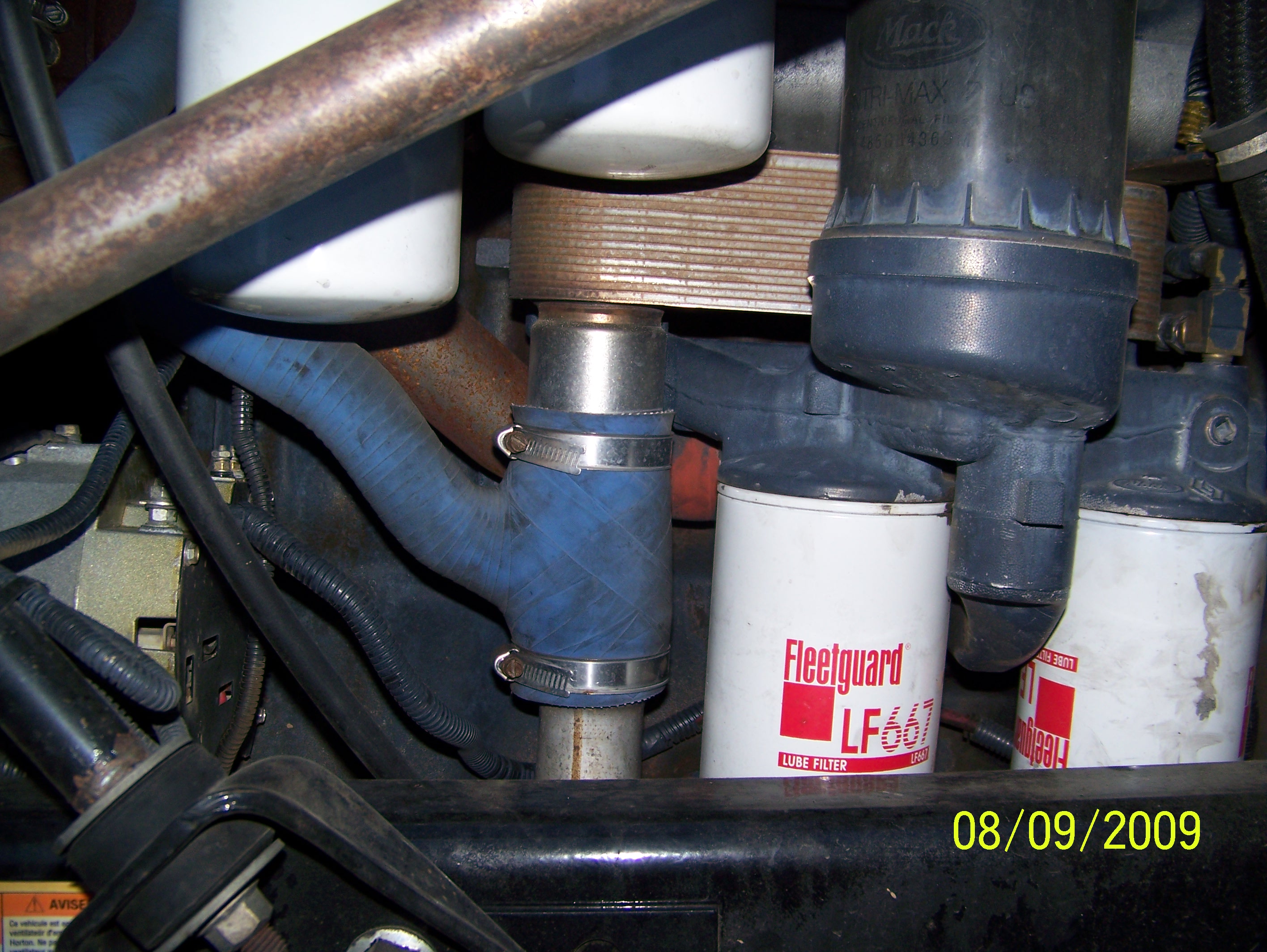

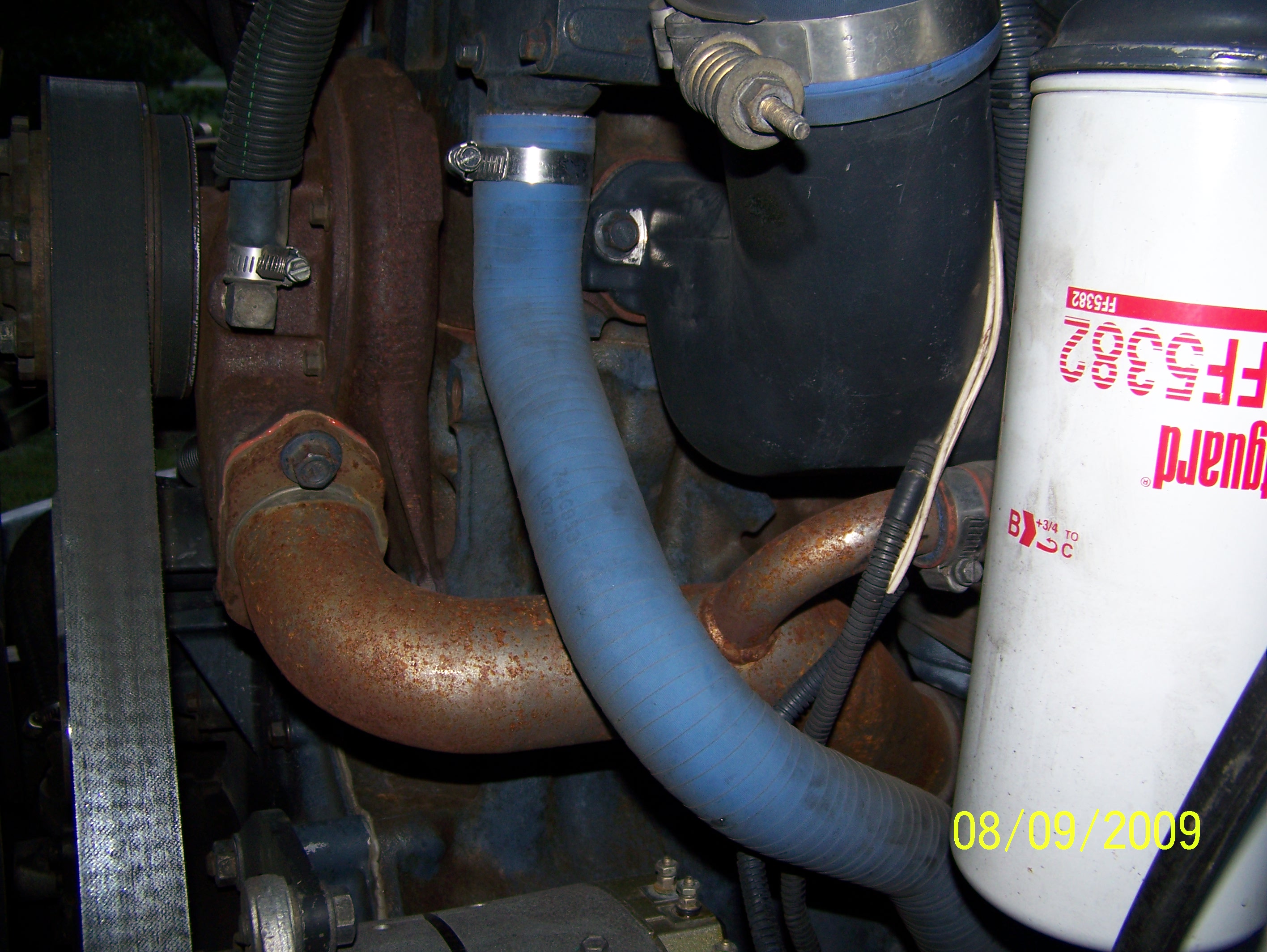

Which cooling fan setup does your truck have?Some of the 01 model truck came with one type from the factory,later with this problem being discovered by Mack they upgraded with what they called a cooling mod kit.This kit lowered the water pump changed the fan,shroud and clutch,for better air flow and so forth.
The only time my 01 Vision has ever run that hot was when I pulled 47000 pounds of copper up an 8% grade just south of Globe Arizona. Later I had to replace the oil cooler and the dealer said there was an upgrade kit I needed to help keep it from running hot. here are some pictures compare to your truck...mine is an E-tech 427 econodyne. Good luck .
P.S. everything without paint is new. The oil cooler and the metal pipe plus the blue silacone hose is the add on parts. my truck does not have a water conditioner filter I have to add conditioner packets to the water.
