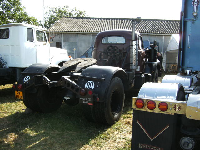

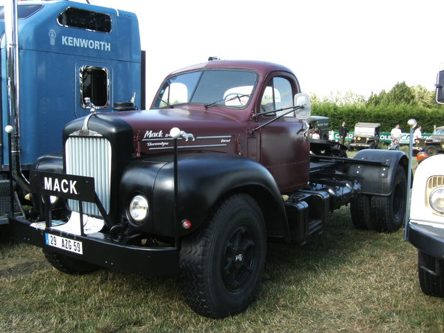

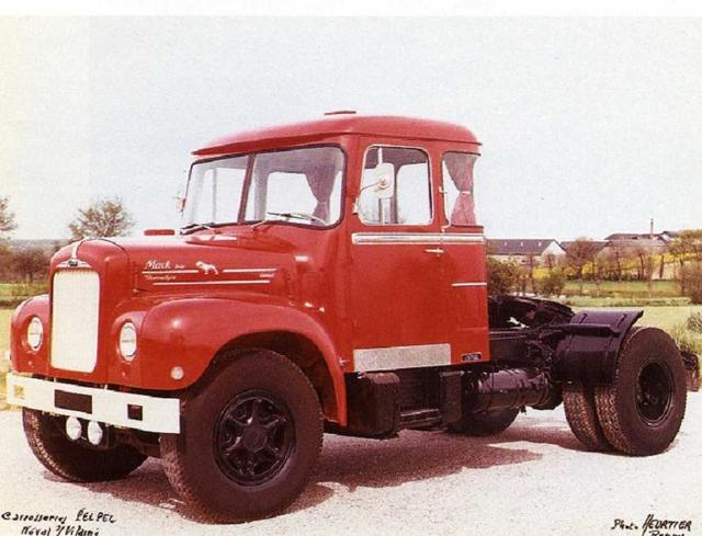

Here is some pictures of Mack B 61 built in France. You have an standard cab with the brown and sleeping cab with the red one. I have an question, in France all the b61 have 5 gear with pneumatic relay do you have the same gearbox in US?
post-3765-1248434010_thumb.jpgpost-3765-1248434026_thumb.jpgpost-3765-1248434039_thumb.jpgpost-3765-1248434055_thumb.jpg
The red truck is a bit strange. Looks sort of like a White cab and doors, but the sleeper is different.

The Mack's that were assembled in Europe were sometimes built with a locally made cab. Back then the US B cab was considered too small for European operators! So French and Dutch built Mack's came with locally built cabs to better suit the local needs of owners and drivers.
