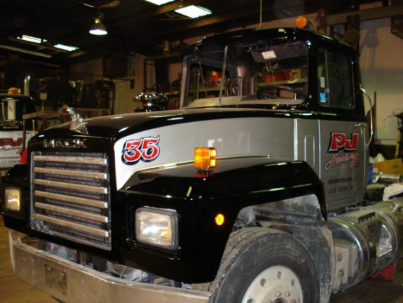

I found this pic in the gallery.
The RD 690 would have this type of hood.
This particular one is a tractor though, so it may be an RD688 (equipped with Econodyne E7 350 or 400 etc.)

I've seen plenty of those around but have never worked on one. I suppose the R690 has the more standard hood of the R model then?

I don't think they made an R690, as the plain R models were discontinued in the late 80's, and the EM7 300 wasn't introduced until about 1990.

as far as the RD part of the truck it refers to the type of frame 3/8" thick 10.5" tall I had a 79RD once you can put the newer style hood on a old R radiator would have to swaped

You are correct, but Rob was asking what an RD690 is, so I posted that photo.
The older RD685, 686 etc. had the regular R model hood from the factory.
