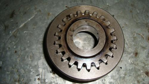

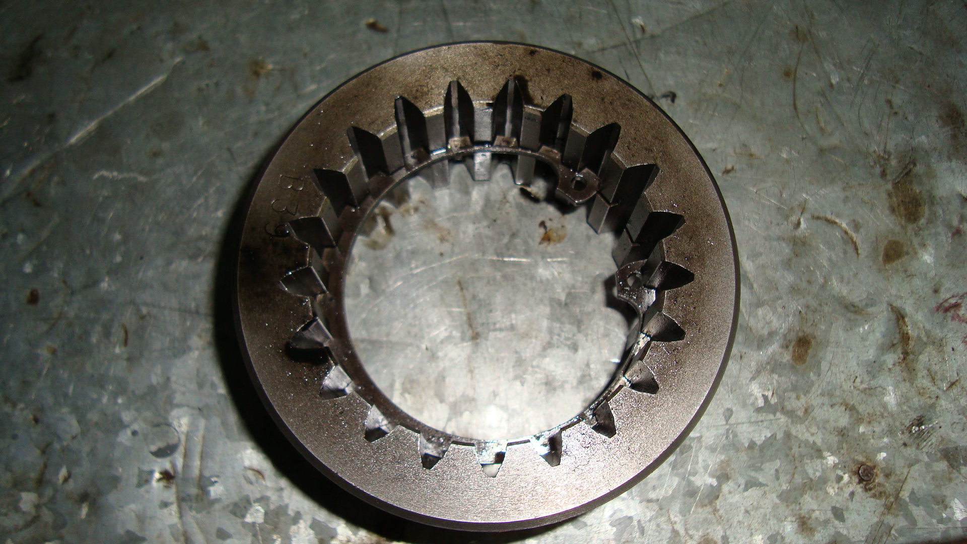

I WOULD LIKE TO KNOW, WHICH THE POINT OF PLACEMENT OF A INJECTION PUMP OF A ENGINE MACK : E7-300 :PUMP BOSCH EDC .
I LIVE IN PARAGUAY AND I DON'T SPEAK ENGLISH WELL, EXCUSE ME IF I WROTE SOMETHING WRONG .
I SPEAK SPANISH IT IS PORTUGUESE
The splines go where ever! the timing is done from the cover on the front of the engine.Remove the front
cover there are 4 bolts holding a gear!Remove those bolts carfully not to drop the washers, remove the gear turn the engine to
timing marks on the flywheel and set on the correct mark for that engine . Then Please post a picture of the fuel pump we will be able to guide you better once we have this!Your speach is fine.Pictures will help alot thou
to guide you thru.
