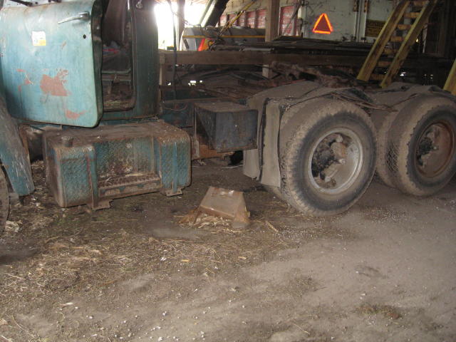

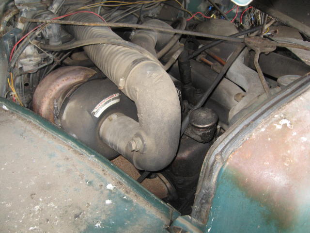

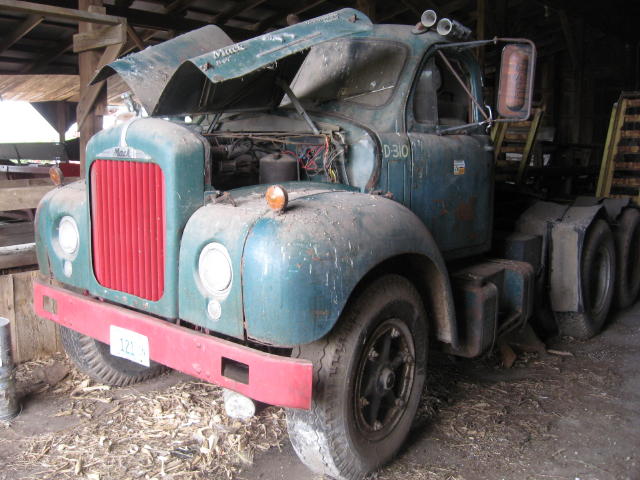

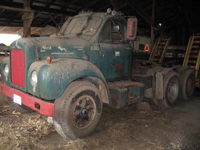

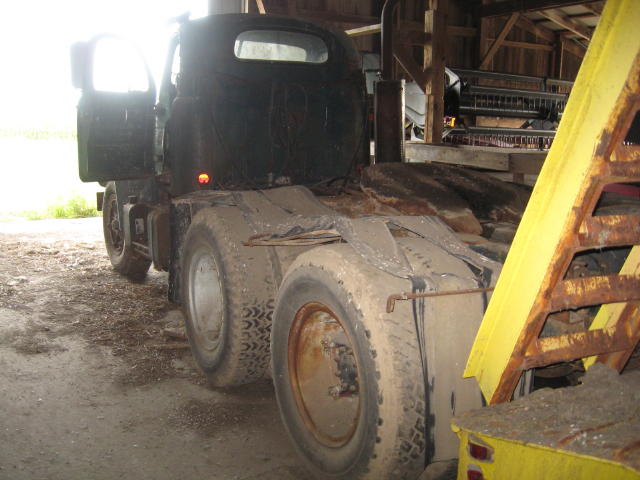

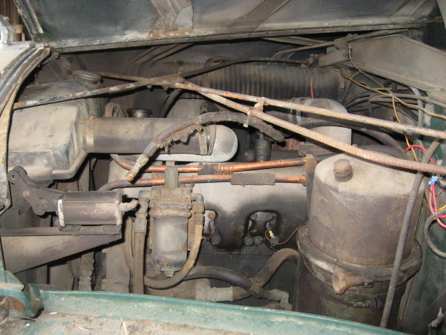

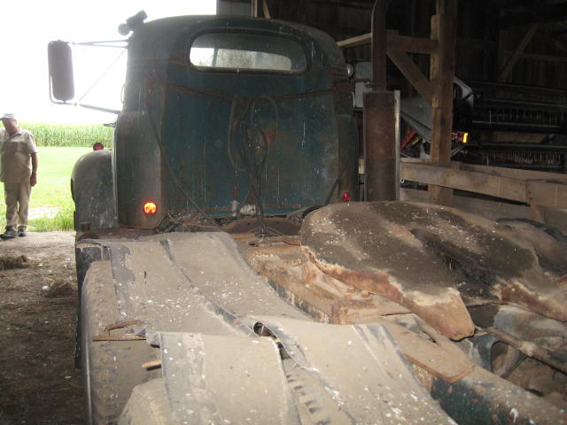

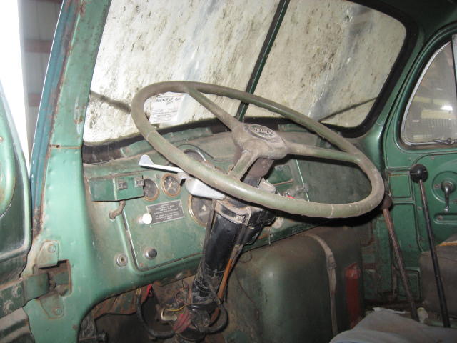

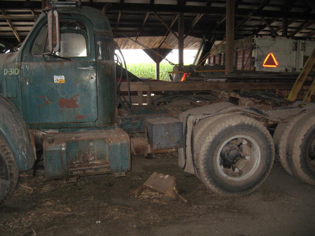

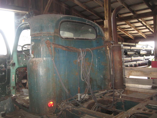

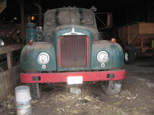

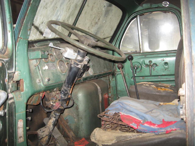

I went to look at this truck tonight not knowing what to expect. It turns out to be a 1962 B-67 with a 711 engine that is turbocharged, and is a factory twin screw. It has 6.34 rears on 20" spokes, and a duplex transmission. It has not physically moved from it's resting place in the barn since early 1999. The engine was not stuck, and it is full of nice green anti-freeze. Mice have reduced the interior to trash as can be expected and there is not a single item missing from the truck. I mean nothing. It is as if he shut the ignition off and never returned.
He used it for many years to haul a dozer, (Caterpillar) on his lowboy trailer and the truck never slept outside. It always came home to the barn at the end of the day. It will need fender, and headlamp panel work due to rust from wheel splash on both sides, and the cab is very, sound. I'm quite sure it would roll right over and start with fresh fuel and filters. I asked about if he ever had problems with the series-parallel switch to which he replied. "This truck don't have one anymore". He had a 12V starter installed when the switch failed on him.
I couldn't get him to give me a price on the thing. Just, "whatever you think it's worth to you, I want you to have it". Damn, I'd sure like to have it and want to be fair so I'm gonna think on it tonight. My first thought is I'll offer scrap price so I don't feel guilty. Hopefully I can get it running and we can both take it to Walcott next year and he'll catch the "Bug".

You lucky Dawg! Neat find, for sure. Rust would have a hard time get'n thru the bird poop LMAO!!! Does look very original, hope momma don't cut them off fully.

Yeah, it had a healthy insulating layer going on there. It was dry too.....
The only appreciable rust was the headlamp, and fender panel about centerline of the headlamp bulbs to the bottom where the two bolt together in the wheelhouse. I would need to make both mating surfaces to both panels. Not many dents in the cab sheetmetal and the aluminum hood is perfect without cracks or thinning. All the badging is intact also. Although I didn't look really close, the gauge bezels do not appear to be rusty either.

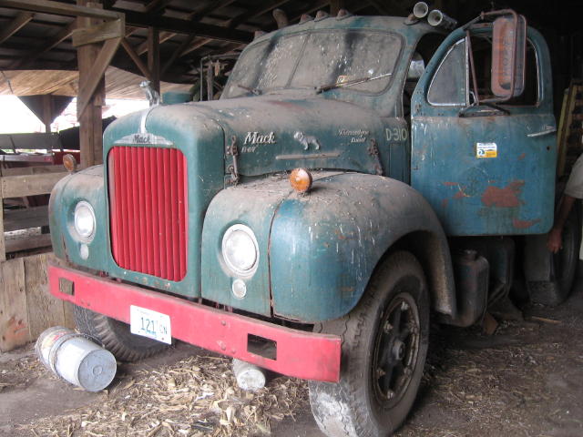

Had to "break down" and take the truck off his hands yesterday. Gentleman would not accept any money and once again said both, "you need that truck" and, "I want you to have it". What's a guy to do? I'll make a spot in the shop and bring it home early next week. Don't want to hook up any electrical juice until I get a look at the wiring due to the mice. Miraculously, the truck does not "stink" like mouse droppings at all, just musty.
It looks a lot better rinsed off with a hose!!
Think I'll stay with Mack green on this one, but may black the fenders. We'll see.

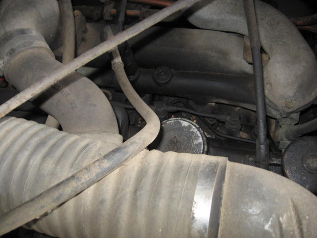

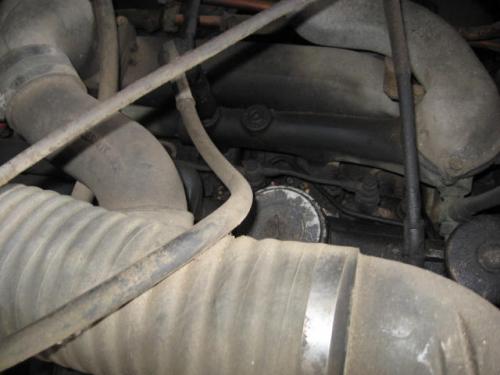

I see that when the turbo kit was installed on that 711 the did away with the equal length intake system and put the old type aluminum 673 intake manifold on it.

I've not driven anything on the road with a duplex transmission so don't really have any sort of plans as of yet. One thing I find puzzling is that he said the truck would run right at 65mph on flat road empty. The rears have 6.34 gears and my 64 B-61 with a TRQ-7220 will only run 57 on the governor so something can't be right. Both trucks are on 10.00X20 rubber too. If the quad is good in that truck I most likely will replace the duplex as I like the shift pattern and sound out the pipe. This 711 does have one of those hydraulic governors on the pump but he said it always started right up without a lot of cranking.
All ten tires on this thing are recaps and are many years old. Although they all hold air, I'll replace them with ready spares from the shop "stock". Some of the caps are "rolling" at the edges so no way to know how far they would run before blowing.
I'm going to trailer it home the beginning of the week. With the oil pump in the front of the trans and having set so long I really don't want to damage any internals. All eight of my heavy jack stands are holding projects at this time so I guess I'll have to work on the floor, (shame). Then again, good reason to get more stands don't ya think?

I had also noticed the intake manifold was the same as my 58 B-61 that is natural aspirated. This truck being a 1962; I was not aware the equal length manifolds were in use yet. The 64 B-61 uses the equal length manifolds. I don't know what the year was of their introduction.

Rob Good Deal you must really be Rob Barker on the price is right.Not a lot of B- Models with turbos let alone a B-67. There was one at our ATCA Show Endless Mountains a few years ago. They really did their homework to fit that turbo in there. Joe Ditchkus.
The one that I had utilized the same exhaust manifold, and therefore the same turbo location, as the ENDT 673 engines and the ENDT 675's up through the 1972 model year.
