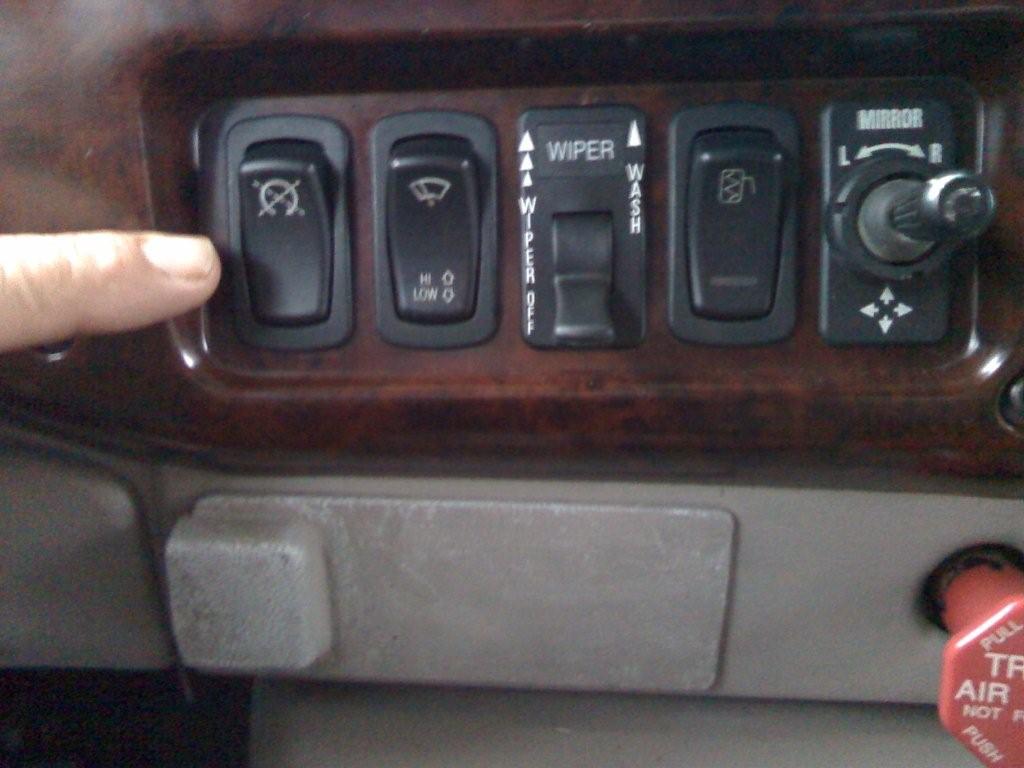

Auto shut down reset? My engine will idle for 5 minutes before auto shut down. Press button and it resets for 5 more. Best explanation I can give you
https://www.bigmacktrucks.com/topic/10936-switch-function/#findComment-41497
If there is a problem with the truck (i.e. overheating) and the truck goes into shutdown mode, a buzzer and an idiot light will come on. I think you have either 30 seconds or a minute before the truck shuts off to get out of traffic. If you need an extra little bit of time, you can hit that button before it shuts down and it buys you another 30 to 60 seconds.
...or at least that's been my experience with it.
