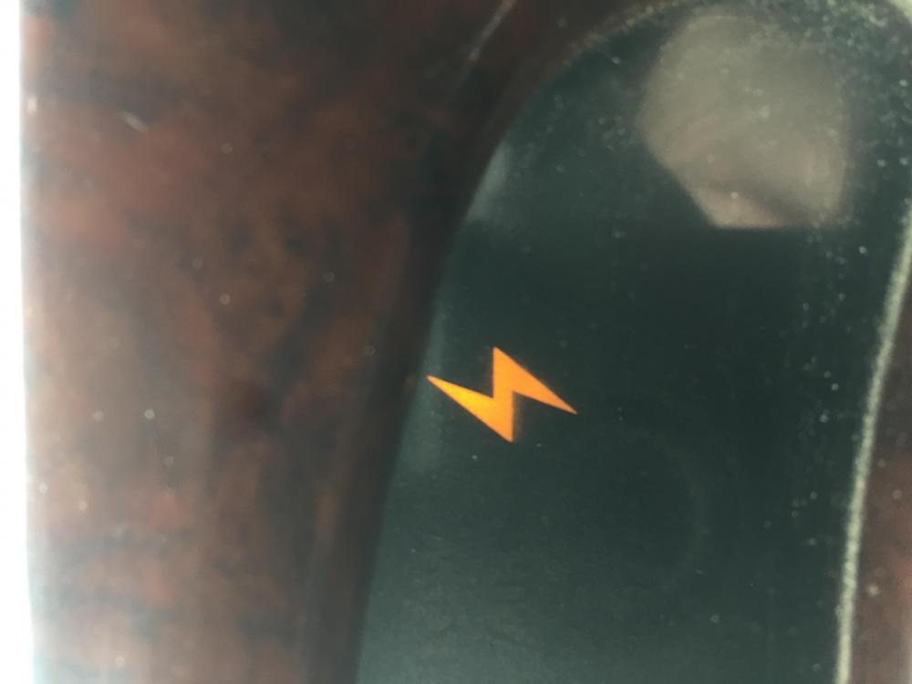

Electrical/Electronic malfunction.
Best thing is bring to dealer, let them hook up computer. It will read the code and determine problem.
OR, with cruise control off, press the set button. Bolt will flash in a series. Count flashes (like 8-3) IF you have the manual, it will tell problem. Or ask here. these guys can diagnose the problem and the fix.

I just got transfered to a 07 Mack Vision about a month ago and now there is a light coming on in the insturment pannel. Called the dealership and they are unsure what it is.... Anyone have any ideas? The truck is running fine, no issues. Just have no clue what the light means.
If your dealer didn't know what that light was all about, then you need to go to another dealer. I wouldn't trust them to work on the truck. Either they are clueless or they blew you off. Both would disqualify them from earning your business.

I just bought a 2005 Granite CV713, and my Lightning Bolt light comes on when under load. Took to Mack Dealer outside New Orleans, LA, and they put a computer on the truck that said it was a "humidity sensor".
I agree with the prior posts... If your dealer cannot tell you what the problem is, the DEALER may be a problem.
Either they really DO NOT know (which is not good), OR, they were blowing you off.

you need to get the code to know. without the code, it could be anything

The mass ground point inside dash on driver side A pillar. Clean and check your grounds.
At least that's what it was on my 2000 CH when I used to have it. Always had the malfunction light coming on and off and the truck randomly shutting off and starting right back up while driving down the highway.
Dealer never could figure it out. They changed all kinds of harnesses and ecm. Was just the mass ground. Found out many years later.

I have an 09 mack cxu613 mp8. I have a stop light and bolt on the dash. After I put it in 8th gear it slowly raises with little power empty. Does anyone have any ideas? The dpf button is flashing also but it doesn't work.
lightning bolt means there are diagnostic trouble codes in the computer.
parking brake on, engine on, cruise control off. press cruise button down to resume and let go.
count the flashes of the lightning bolt. it should give you a two number code.
with that number, you can then find out what the problem is.
