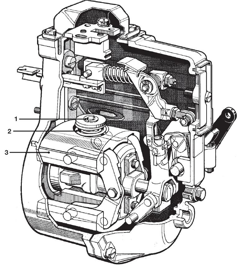

depending which pump he has that will only give you smoke on initial accelation with the feeling of quicker boost, however you will gain no top end power. I agree the bottum end of the motors are reliable up to 350hp, have i turned m e-6's up.... you bet!! I've changed the grind on the torque plate in the bosch p7100 pumps and they lit up like a wild cat. however i've got a melted piston sitting on my shop bench and a couple of locked up engines..... tuner beware..... melted piston was bad injector and stupid operator. locked up motors were also dumb operators.. to many rrrrr's down a hill.... we had an r model with a 300 e-6 we turned up pulled grain hopper with some pretty big loads I would say were pushing 400hp with it never seen the pyro exceed 1000, even got a coplement once from a pete owner wondering what we had under the hood "he said he couldn't keep up with us with his 400 cat...." but I still wouldn't recomend it.....
Don't leave you much advice with this post..... If it was an e-7 I would say go crazy but that little e-6 is happy right their.
post-1247-12607081659115_thumb.jpg right on top is a cover underneath is a plate with 2 screws loosen the screws slide the plate forward towards the front of the motor tighten the screws put your cover back on. Good luck (I have a few used pistons if you need them)...... :lol::SMOKIE-LFT: :SMOKIE-LFT:

thanks for the info
on that e6 300 that you turned up, did you upgrade the turbo as well? if so, what did you use?
my e6 has the american bosch, is that what your picture shows? it doesnt look too familiar to me...

that particular truck also had the american bosch, we switched the pump out to the robert bosch (which is in the picture) only because the american bosch was limping on one cylinder and i was too cheap to fix it but had the robert bosch lying in the shop....
I got to know the american bosch on a customers truck after my switheroo... I kinda prefer the american bosch because I think its a "snappier" pump and if you have an engine brake it is controlled in the pump which makes jake shifting pretty nice (another NO No). same theory with the american bosch pump though take top cover off and slide adjuster towards front of engine.. and no we did not change the turbo. you have to watch your pyro if you have one.
