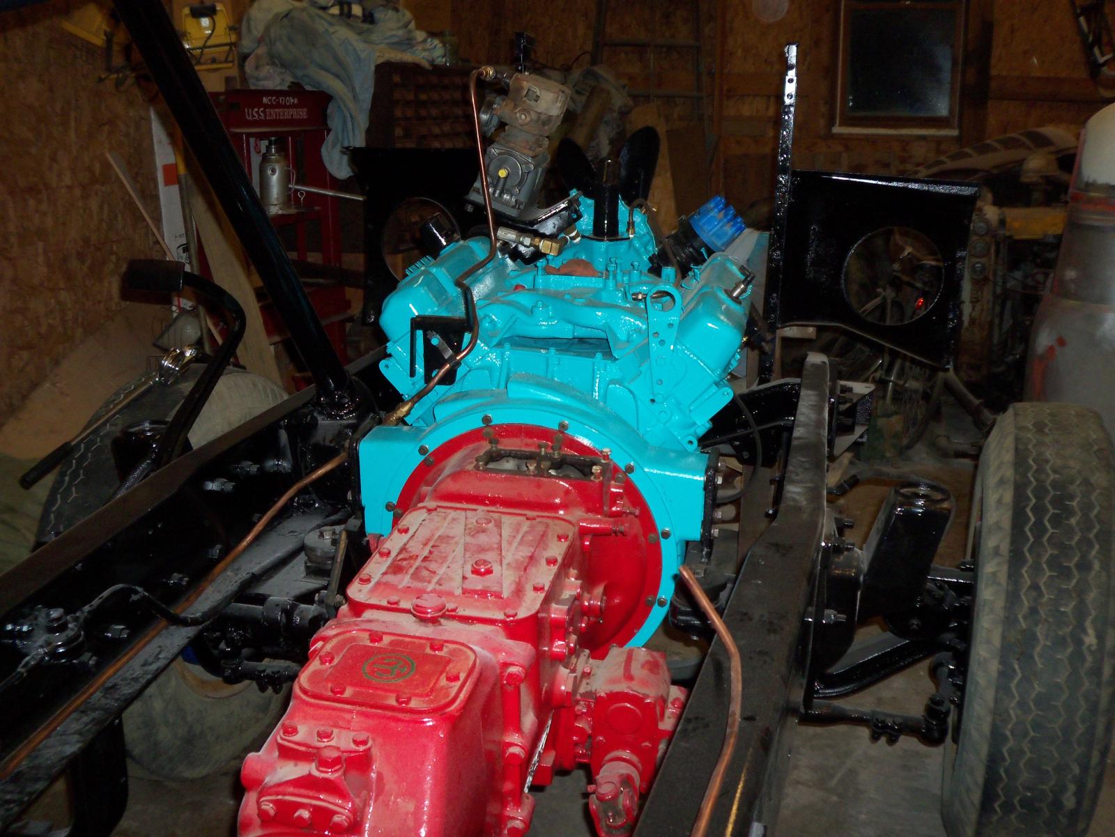

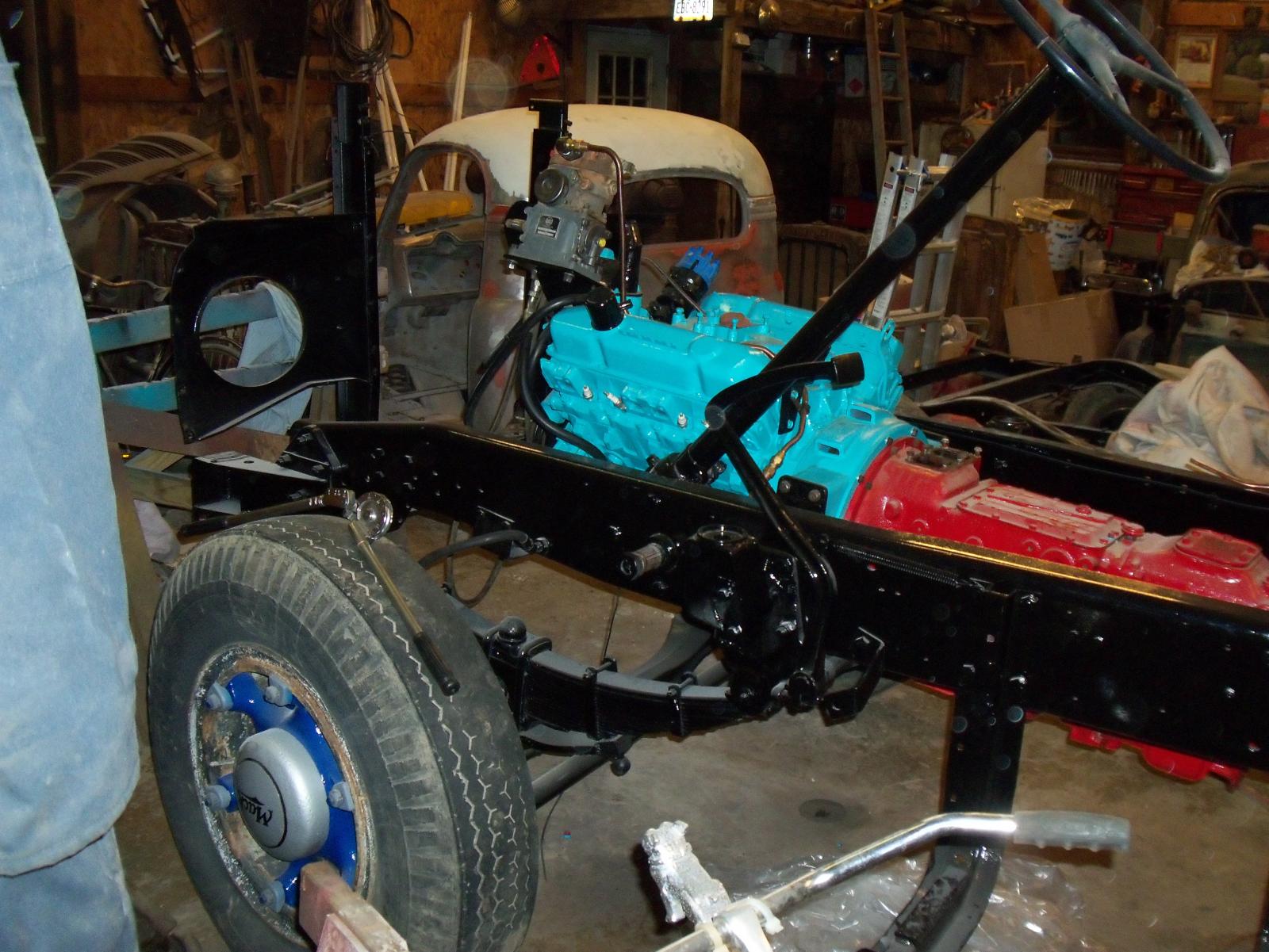

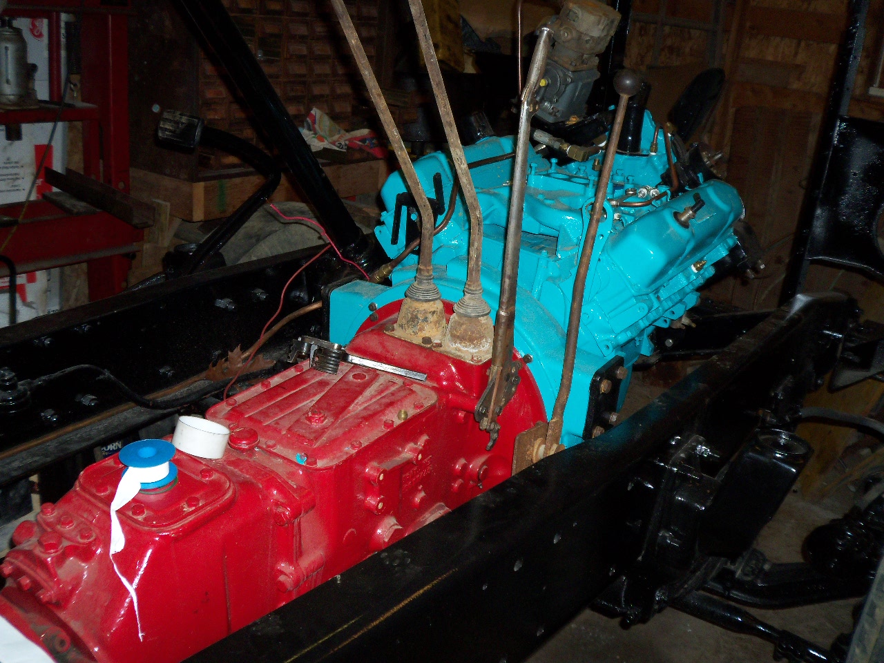

20 speed baby quad is a TRQ77 and TRQ770 is an 18 speed baby quad. they use a smaller imput shaft I think where as the TRD67 and TRD72 series use the same size imput shaft. my B613t had the EN413 and a 5 speed direct wit a 6000 series 3 way auxiliary behind it. the driveshaft was about 6 inches long.... sold the trans setup to Keith on this site who had/has a green R410P with a 413. picture of my B613 when it had the abortioned Chrysler in it..

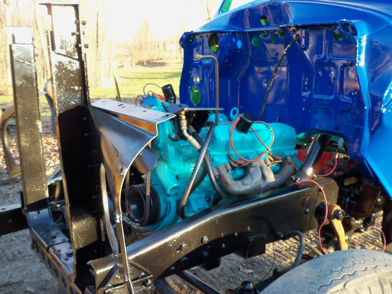

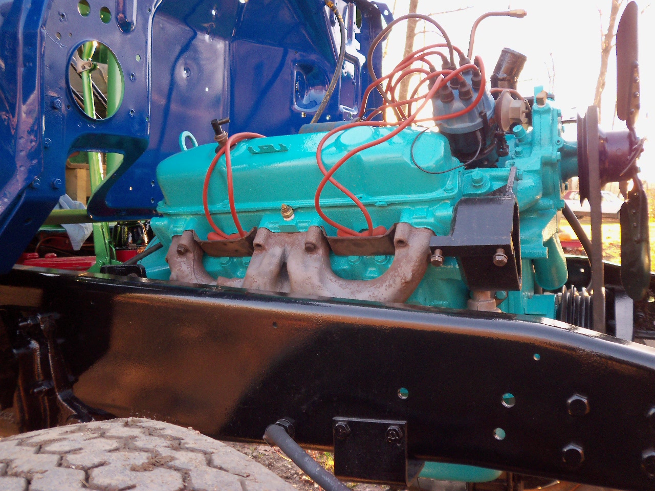

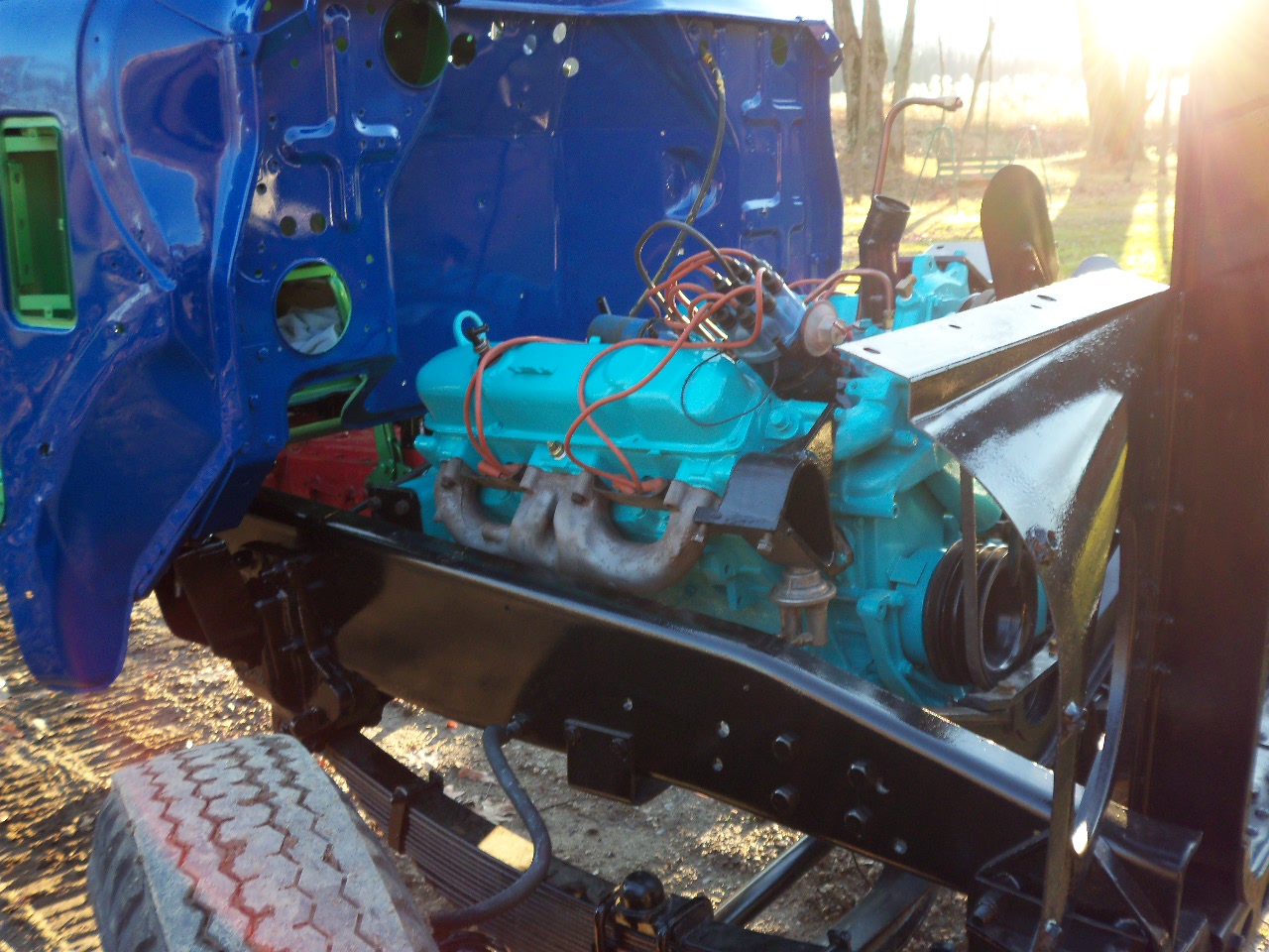

I see yours is the ''blue block'' .the ''orange block '' like was in mine is the industrial block. I dunno what the difference is. its not the true ''max wedge'' block cause it doesn't have the side bolts thru the block and into the main bearing caps. yours also appears to be bolted thru the rear spring hangers. mine was bolted thru the original 401 rear motor mounts.
I didn't think the Max Wedge block had cross cross bolt mains?
BULLHUSK
maybe only the Hemi had the cross bolted mains? maybe that's what im thinkin of? I know the orange block is the industrial version. not sure what the difference it but I know my grandfathers R410s had a blue block in it and bolted directly to a 77 series trans. my orange block had an adapter plate like yours that dropped it down to a #3 bell housing. your B421 I bolted to he spring hangers in the pic by the looks of it. mine had the hangers off the 4 bolts of the front spring hanger.
