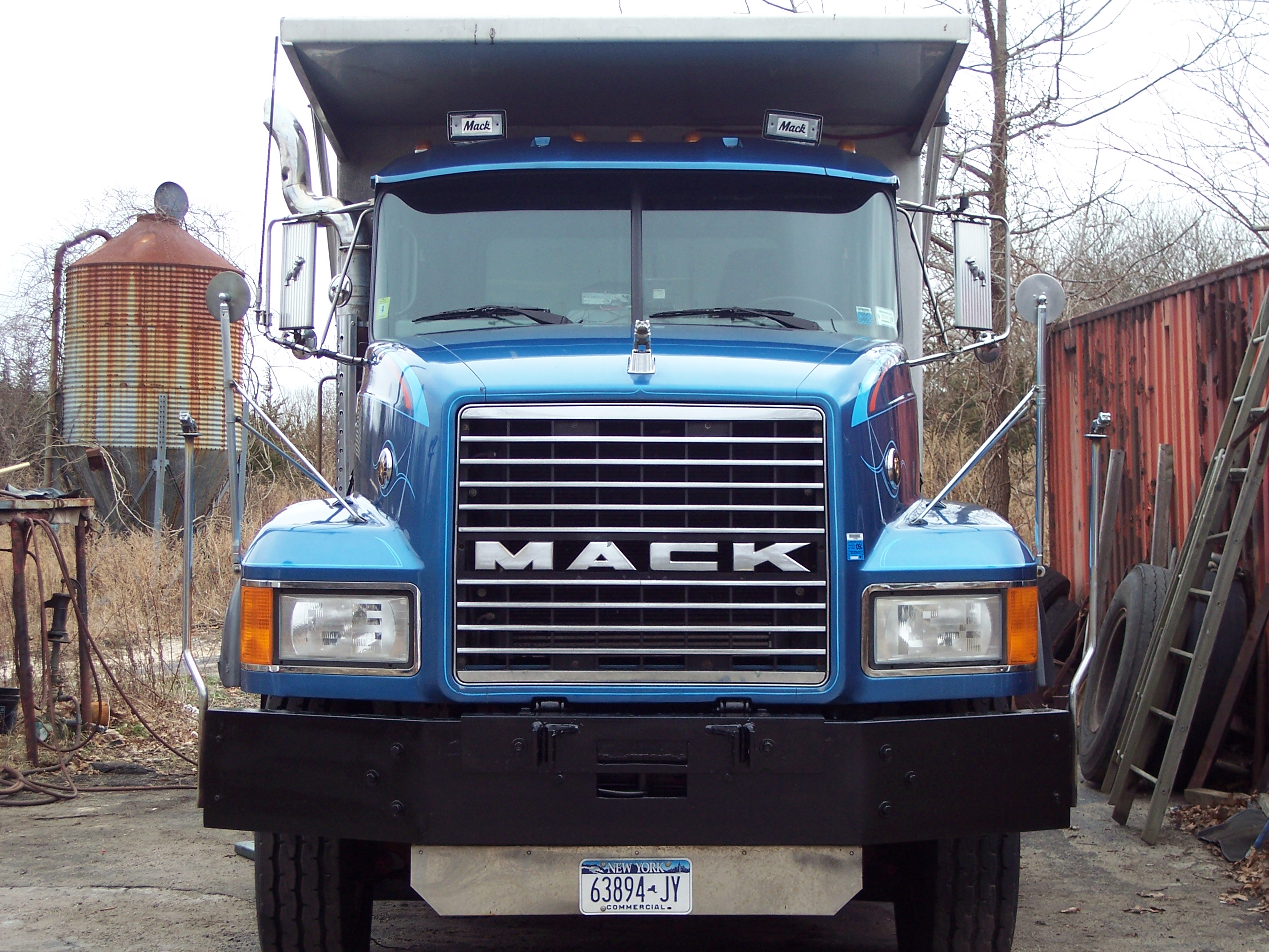

I have a heavy steel bumper on my cl,it was on the truck when I bought it but I know the previous owner had it made by a steel shop,pretty simple for them to do you just need to give them the measurements or maybe your old bumper. post-598-12640363206313_thumb.jpg
That's exactly what I did on the CH tractor that I made into a dump truck, the original plastic bumper hung down too low for off road work.

Just call a "crop shop" and tell them to put two bends (with a break) on a sheet of steel(1/4"). notch in a couple of wings and weld er up. About 250 bucks all said and done. just change the mounting plates to 1/2" and they'll hold well. four deer and two elk, slight bend in the middle, little tremclad, and the dealer still wanted to know where I bought it. Don't shell out an grand , 250 steel and 750 welder, and the welder doesn't hit deer much...
