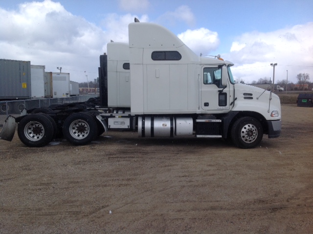

mp8_macky:
Where are you, I am in ND? Work from the MT/ND border, (Williston) to Minot area.
I just bought a 2012 CXU613, when you have time holler at me. I would like to know what you have spotted I should look out for. You heard anything about a oil sensor that somehow leaks oil into the harness and it can end up in the computer? Have you cut any of your oil filters open to look for metal?  That's the two I know to watch for so far.

Dang I just saw this. I am not very often on forums sorry. I get here from time to time, and inform people about all issues I had and sovled them.
Any how
Quote
I had a problem with oil leaking into ECM and shorting it. So do the preventive checks.
I didnt cut any filters to look for metal but you can do that, if you find metal - you are toast :) (engine rebuild is about to happen).
