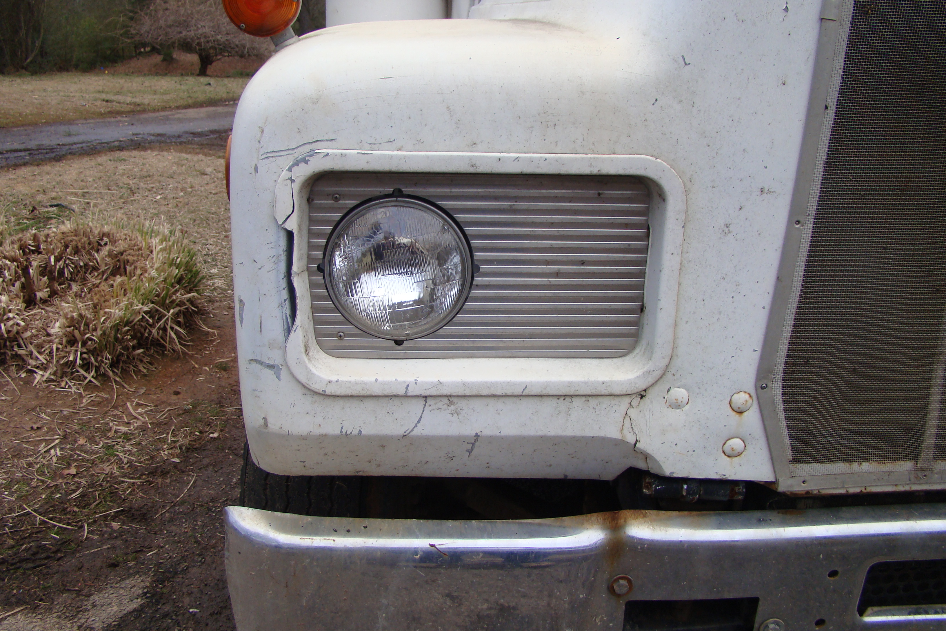

post-4330-12662004948898_thumb.jpgwell rowdy, i dont get a "copy image location" I just get copy, I have the pic showing in the attachment section at bottom, but keep getting error message saying no image selected,,anyway,,will keep messing with it,,thanks,,randy
https://www.bigmacktrucks.com/topic/12656-posting-pictures/#findComment-49715
well, I will be dipped,,,I think I did it,,,,there ya go Rob,,,see that little trim around metal plate? Thanks rowdy
Yes the perimeter moulding. All of them I have are a stamped metal piece. I've never seen them plastic as yours must be to allow a chunk to be missing. They should be readily available new, or used. Remove the screws that retain the aluminum escrutcheon plate, then remove the screws from the perimeter moulding. These screws will be set into a nylon nut that is recessed into the fiberglass the hood is constructed from. I would lock onto the nylon from the back side with a pair of vise grip pliers as the corroded screws will not want to back out readily based on past experience. Now of course no one else has these problems, just me.
The crack to the passenger side of the hinge area looks to be from impact and not corrosion/rot. It is a stress crack from the fender/hood being bumped which probably broke the moulding at the same time but was not severe enough to take the fender off the truck, or possibly fracture the structure further back.
Rob
https://www.bigmacktrucks.com/topic/12656-posting-pictures/#findComment-49719
Rob
Thanks Rob, will get a pic of the other side tomorrow which has bolts missing, hinge crooked, and ugly crack,,,thanks again,,,randy
