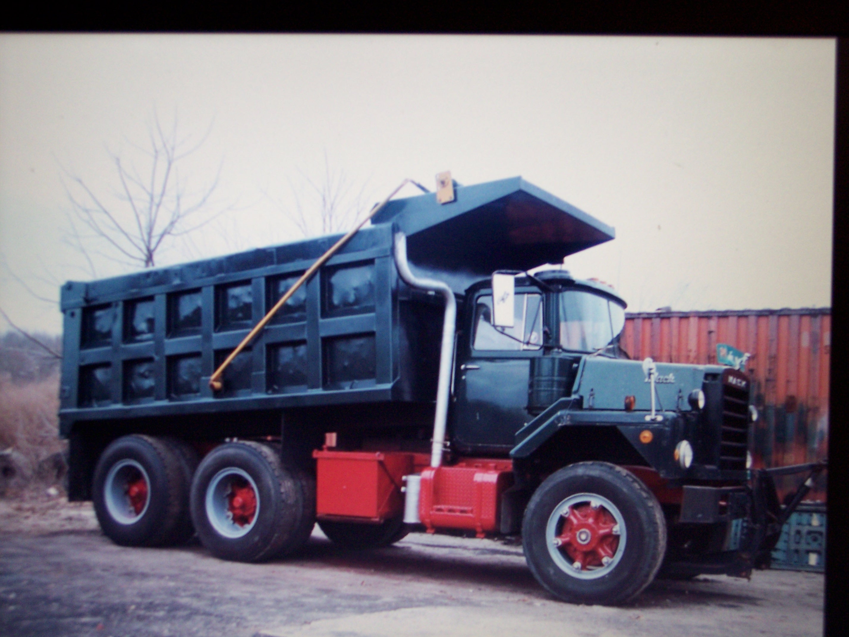

I had a 1970 dm with the 55 rears,its been a few years but never had a problem getting brake parts,your not gonnna be able to swap the shoes out for relined ones you have to buy the pads and bolt them on yourself,drums should be readily available and as far as the axle and rollers I don't know what you mean,my dm had an s cam and no rollers just wear pad that got pined to shoes.post-598-12664545664964_thumb.jpg
