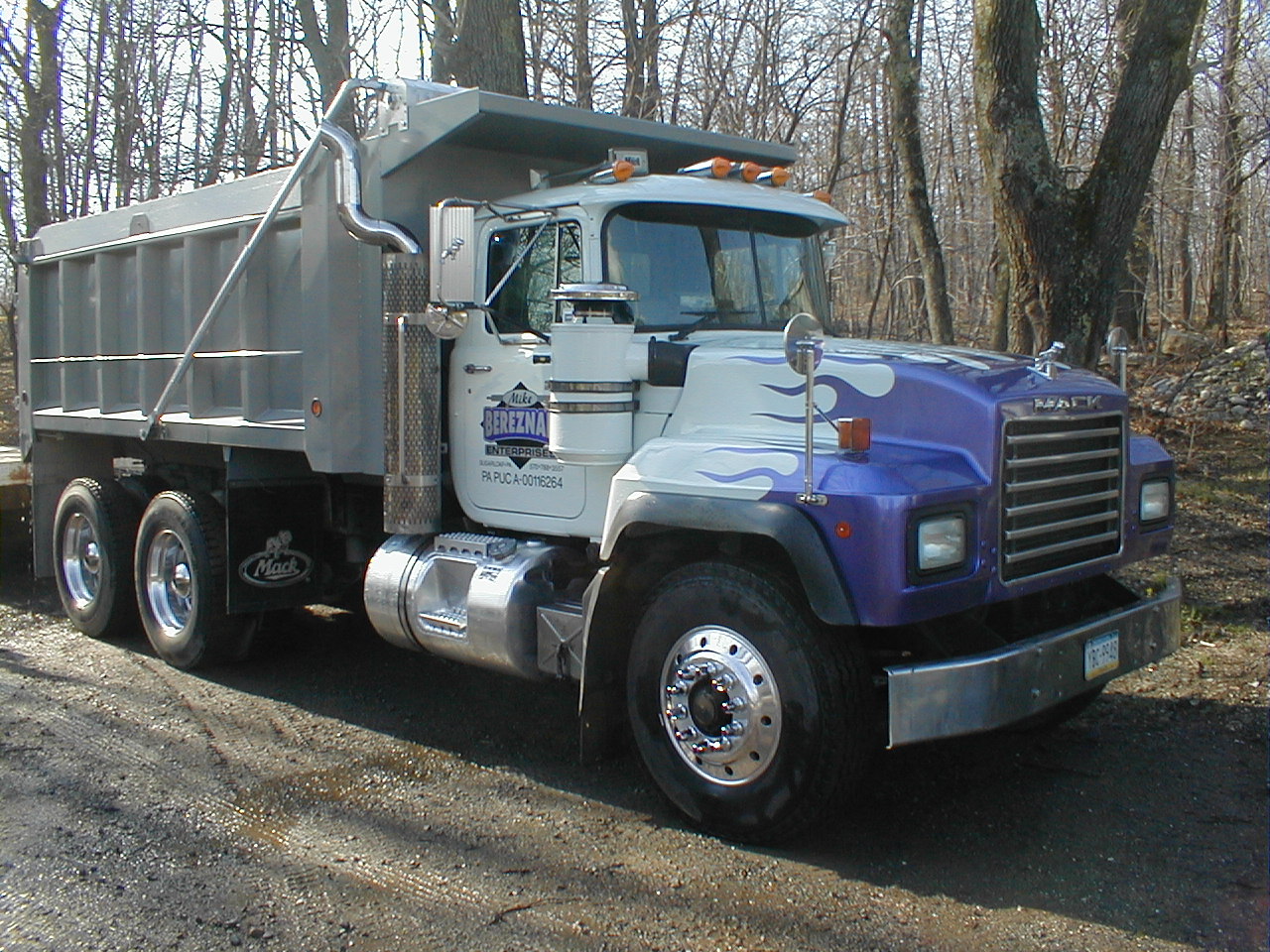

THEY WERE A BIG HELP FOR ME WHEN THE CARBIDE WENT ON THE LIFTER AND ATE THE CAM, KEPT THE COST DOWN,,,,,,, WHATS IN YOUR RW FOR A ENGINE, NICE LOOKIN RIG
WHAT IS THE TRUCK ON THE LEFT SIDE IN YOUR POST, IS THAT A HUSKIE OR A RW.
