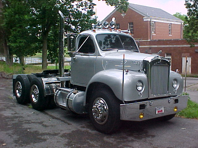

DALE: In the course of fitting out my boat building shop in anticipation of retirement, I came to the realization that I needed a big truck. Naturally the sensible thing to do would have been to go out and buy a used Freightliner- but that wouldn’t have been the cowboy way. So, I eventually tracked down and purchased a Mack B-67 live axle tandem tractor with the 673 turbo charged motor. If any antique truck could be regarded as truly an icon of the American highway- this was it. For 2 years it sat behind the shop intimidating me- as I had never tackled anything on this scale. Finally increasing pressure from my buddies caused me to roll it into the shop and start on a full-scale restoration/improvement project-which would allow upgrades to modern day technology and creature comforts. This was not to be just another restored dinosaur.
A 673 Mack Thermodyne had replaced the original 711 sometime in its life, and as it had excellent compression- I decided I would not need to open the engine. The old duplex transmission- truly an iron- clad coelacanth- had to go. It was swapped for a 15 speed triplex which gave me an honest 70 mph road speed at 2100 rpm. . The tin work however was another story. I could handle the front end sheet metal, the fenders and doors- but the cab would have to go to Terry Stegal- the Doctor of Sheet-metal Science, the Wizard of Welding- who eventually would have to fabricate 40% of the cab from new steel. The day came when a back hoe showed up at the shop door with some half dozen usual suspects who would help lift off the cab. Just 4 bolts plus 2 more at the radiator hold down this bubble cab to doughnut-sized rubber pads on the frame. We passed a chain through the door openings and around the bucket and started the lift. This process was gut-wrenching to witness, Years of accumulated rust, corruption and various detritus fell from the cab as it pulled away. Among that- a small slip of yellowed paper fluttered to the shop floor. It turned out to be a 1974 registration slip- bearing the name Tom Bianconi, Stateline Transit, Nashville, Tennessee. Hmmmm…
TOM: I received a phone call from a rather articulate sounding fellow who claimed to have just purchased my old B Model. I had called it The Ugly Puppy when I drove it, ugly because it was painted orange and white and puppy because it was a Mack. A good name for an odd truck.
It seemed reasonable to be leery of some stranger who calls out of the blue and tells you that they are happy to have purchased a 40 year old truck and are going to refurbish it. Sounded like a guy that needs a job! However Dale was very polite and again impressed me with his easy style and common sense approach to the task at hand. I was glad that my old truck was out of the weeds and at least in a dry shop. Ugly was a tried and true friend, a real honest hard working companion of countless hours in pitch dark night. He was my tether line to the world. He never let me down. He deserved a better place for his final days.
Months passed and not a work from this guy in Murfreesboro. Then one day the phone rings and it is Dale again. He now tells me that he is near completion and would like for me to see the “new” old truck. I was almost speechless as he tells me of the many things he has changed. I know now that I must go see my old friend, ugly and meet his guy Dale.

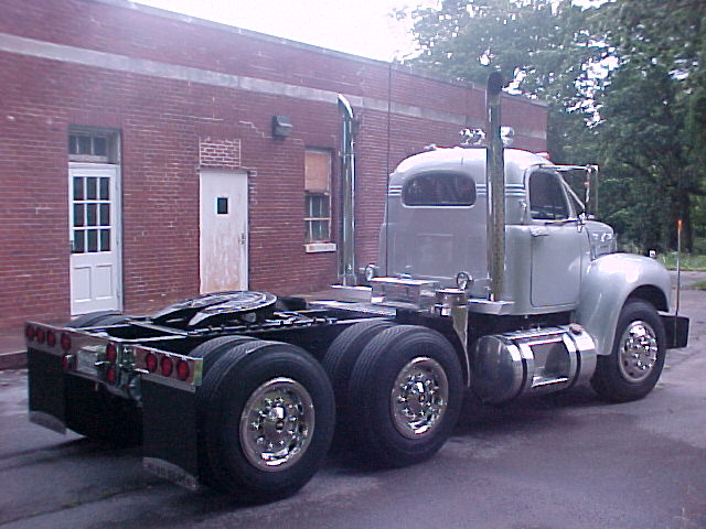

DALE: With the engine fully exposed, I undertook the grafting on of modern technology. The old luber finer was scrapped in favor of spin-on filters. The fuel filters were also discarded, replaced by spin-on’s mounted outboard of the frame rail just in front of and behind the right side wheel. I fabricated a multi-purpose bracket from 3/8ths steel reaching from the timing case cover to the valve cover in front of the engine. This would hold the AC compressor, the power steering pump, and the alternator replacing the generator. A new starter was also added. The old injectors were literally pried from the head and along with the turbocharger-sent to the diesel shop for rebuild. Eventually I would take the completed truck to this same shop so the fuel pump could be built. Curiously, the diesel guy found his original seals and cartouche still in place from 25 years ago.
The old Mack’s ride was improved by the addition of air bags from Load Air supporting the front axle springs. A Garrison power steering system was added at this time. The original square steel fuel tanks were scrapped- replaced with round polished aluminum tanks. All fuel lines were replaced as well. In stripping out the fuel system, I noticed the original steel fuel pedal was worn nearly in half- in fact, someone along the way had riveted a piece of plywood to the pedal to keep this from happening. This had to be a high miles truck.
The chassis was cleaned and painted and all new symtex air lines replaced the original copper. New brake drums, slack adjusters, maxi chambers and all inline valves and connectors were replaced as well. The original split ring wheels were replaced, new rubber and polished stainless Eagle Flight wheel simulators completed the road wheels.
A quantum leap in rideability was achieved by cutting down the rear spring stacks. Mack used 3 full-length leaf springs and 6 steel stiffeners on each rear tandem. I cut the ends of all 6 stiffeners leaving only their middles pinned under the U bolts- so the chassis height would not be altered. This modification- while limiting the absolute tongue weights- allowed the 3 remaining springs to actually work and deliver a very comfortable ride.

DALE: By the time the cab was returned I was ready to paint. Everything was given a good layer of high-build primer and finished with base-coat/clear coat in astral silver pearl. But before reassembly, I insulated the whole truck with marine-grade lead foam from Soundown Inc. The firewall received 1 ½” outboard and 1” inboard. The rest of the cab, floors, doors, roof received 1” material. This is a layer of 2 lb lead sheet, surrounded by acoustic foam and topped by silver mylar. The idea is for the lead to absorb and deaden the sound vibrations and reflect the heat. I gave special attention to the cab floor just over the 6” exhaust- which was bound to get real hot. Here I bonded ceramic floor tile to the sheet metal- if they use ceramic tile on the space shuttle to shield from heat- why not here too?
The cab was reunited to the frame, new smoked glass was installed all around, and a complete new wiring system added. This last was based on a Painless breaker box with integral firewall interlock and pre-wired with the labeled, correctly sized wires. New SW Wings series gauges were added to an engine-turned dash panel insert. Engine turned stainless also highlighted other parts of the cab. Power windows were installed, and a beautiful rosewood and stainless steering wheel added. The entire cab was upholstered in gray tweed, as were the GM Astrovan seats mounted on Bostrom seat bases.
Finally- the most fulfilling stage arrived; bolting on the shiny stuff. A new chrome Texas-style bumper, a train horn for the roof, chrome Vortox, two 6” monster stacks, light bars for the rear, and some Billit items for the cab. The mud flap weights proclaimed “HI YO SILVER…
