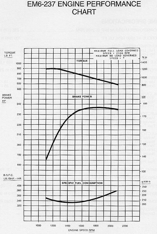

With all the info floating around this forum, someone can,
off the top of their head, tell me the best RPM or 'sweet spot'
to run a 237.
I've got an 18 speed Quad and so have lots of gears to play with but
no idea of what might be the best crusin' RPM for best economy.
Fuel has gotten a little cheaper but still not where a guy would like
to see it!!!
Packer
Keep a clutchin'
https://www.bigmacktrucks.com/topic/1306-torque-curve-mpg-curve/
Lmackattack,
Looks like 1400-1600 RPM does it all!!
THANKS!!!
Packer
I went to Walcott, Iowa,to the truck show, coming back i ran 70mph in Iowa and 55-60 mph in IL,IN i got 11mpg bobtailing with 300+,13 speed overdrive,3.87 rears, cruising around 1500-1600rpm didnt think that was to bad. Ron
