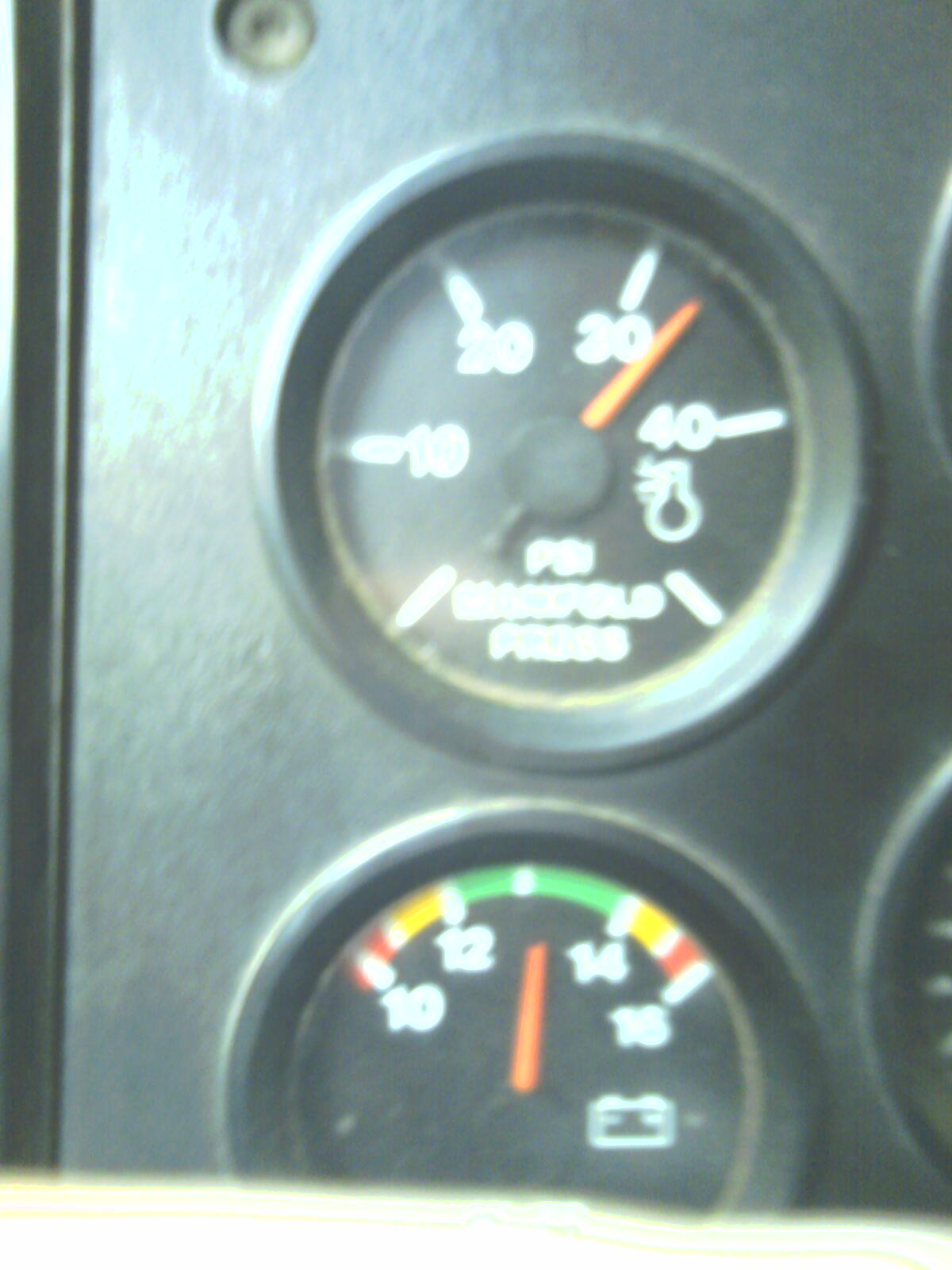

Took this pic on the second load today, climbing a hill at 15 or so mph. On the first load the boost gauge was wrapped around to 35...but I didn't think to grab a pic, I about pooped my pants when I saw it.......I'm excited, she goes now...!
