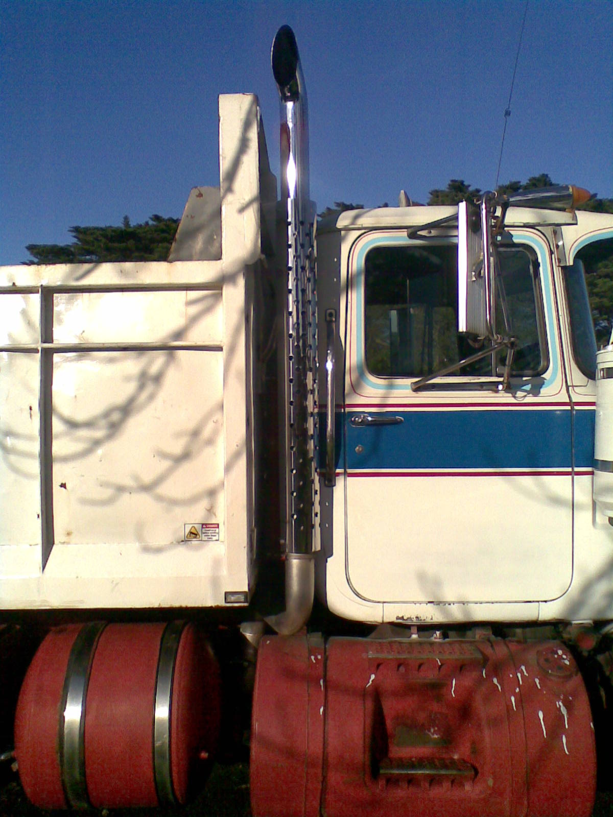

I am thinking of changing a few things on it, not least get a pair of four inch stacks, to keep the exhaust out of the camper - the current weed burner turns down just before the axle and the smell gets into the camper. I kind of like stacks anyway. Problem is there is no room for the standard arrangement - the camper is too far forward, and would take to much fabrication to put it further back. I am reckoning that I could put internal spiral muffler 4 inch stacks with a 5 inch expanded guard round them and they would fit pretty well. The curb side door isn't used - my lady prefers the camper door.

you likely can fit a straight 4" stacks between the cab and camper body and put a muffler under the truck. looks like the hardest part will be getting a 90 deg bend at the cab corner. that engine is not to loud with straight stacks so a mini muffler should do the trick. just make sure the exit its well above the cab or your truck will be black on the top sides.

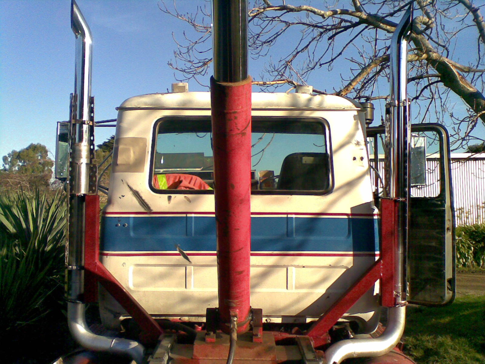

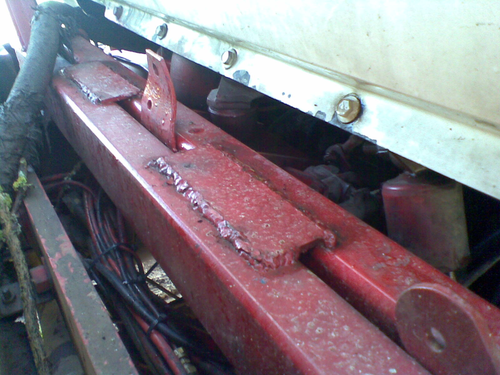

i just put duel 4" stacks on my 84 r 600 tipper,my truck only has 3" between the back of the cab and the tipper body so the stacks are mounted beside the cab. the muffler was already mounted beneath the cab.i used 2 90 degree bends to make a y peice and 3 90's each side and ran the pipes outside the rails the up over the rear of the fuel tanks.my stack end only a foot above the cab and is very loud,espeacialy with the window down.

Do you have any pictures or means to take a couple, to let me see how you mounted them please?
https://www.bigmacktrucks.com/topic/13652-my-mack-rs600l/#findComment-54855

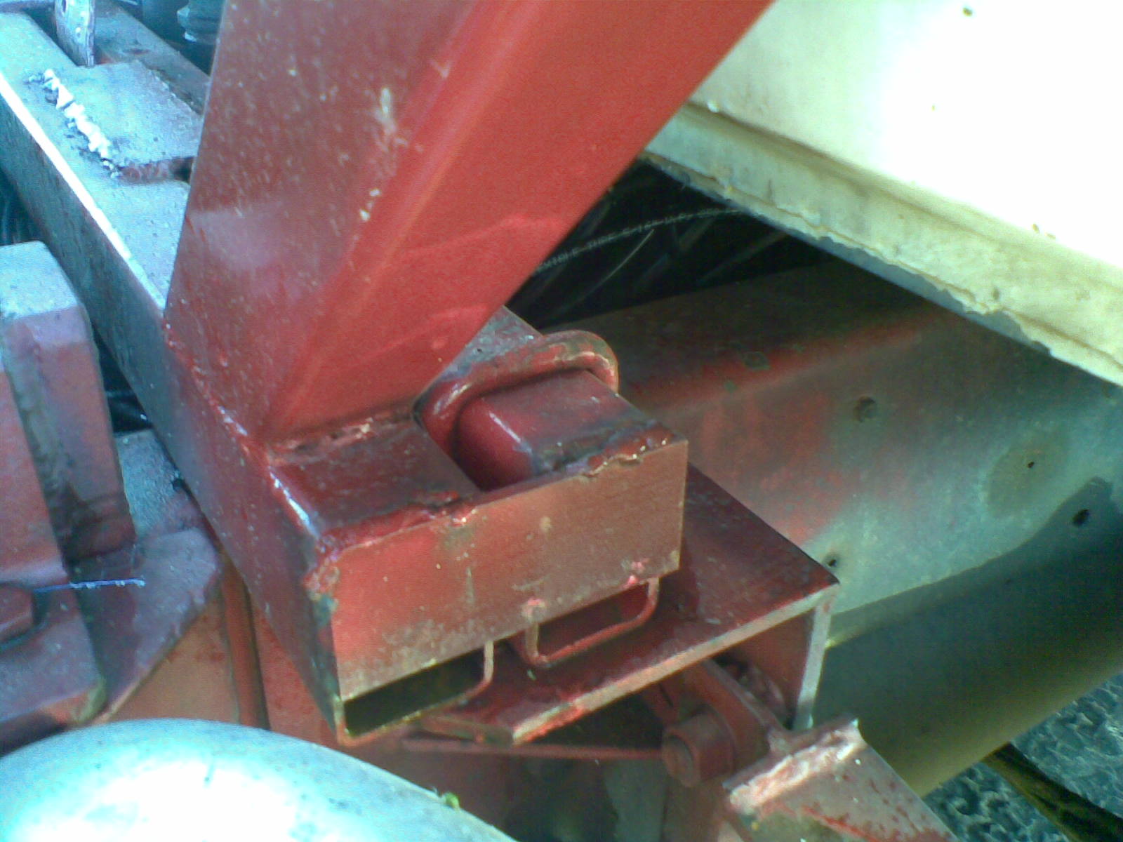

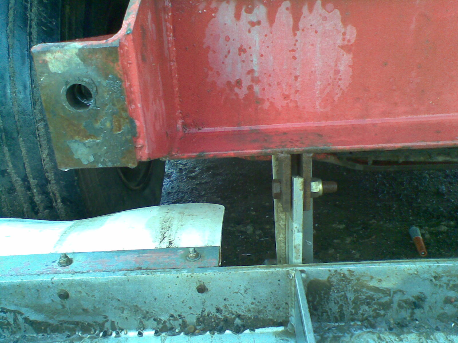

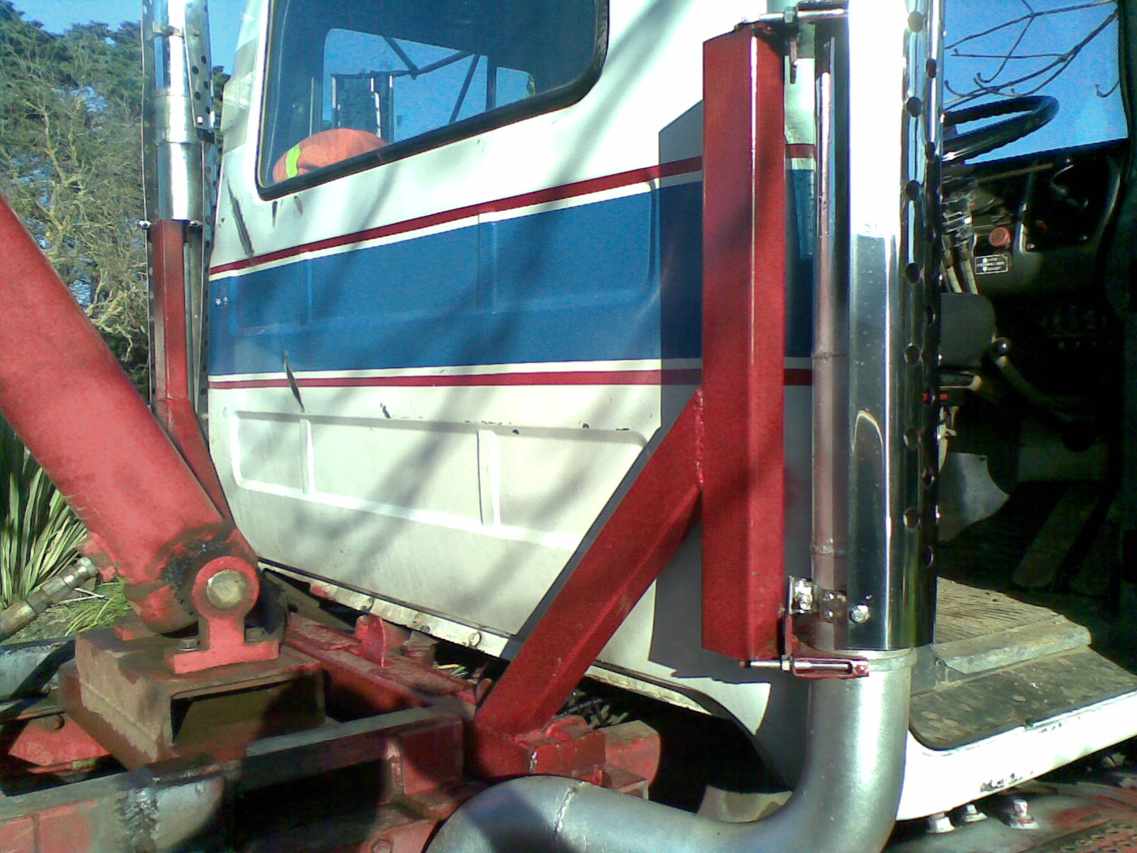

i finally got around to taking some pics of the stack mounts i made.i hope they help, as you may or may not see i dont have much room between the cab and the tipper body so the stacks are slightly on the side of the cab with a 180 degree style gaurd and my mount is attached to the existing croos member via steel plates welded to them. if i had the room i would have mounted it to the chassis with u bolts like the original cross member.post-3922-1273990721_thumb.jpgpost-3922-127399076792_thumb.jpgpost-3922-127399086479_thumb.jpgpost-3922-127399091058_thumb.jpgpost-3922-127399097988_thumb.jpgpost-3922-127399081779_thumb.jpg

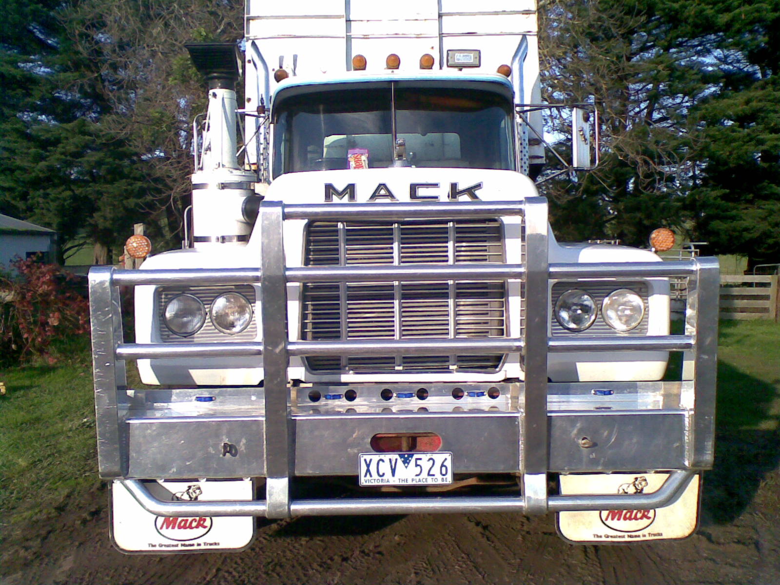

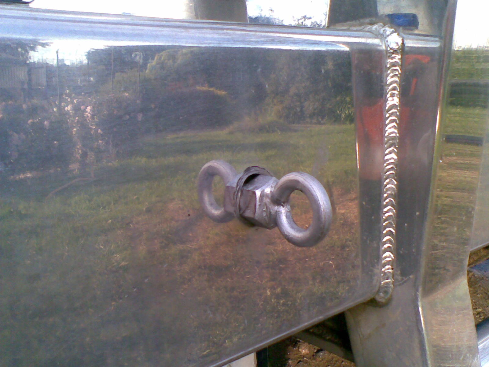

the snorkle setup no my truck is original mack but i believe they are an australia specific setup to keep the intake up out of the dust, we must have more dust here than you guys do so maybe you could one through mack otherwise i think donaldson make the same thing, they may even be the the original supplier to mack australia.as for the gaurd do you mean the exhaust gaurd or the bull bar on the front.the exhaust guard has a clamp that goes around the pipe with captive nuts in it the gaurd bolts to, the bull bar has a fabricated cross member that either attaches to or replaces the original one that have two peices of steel each side of it that the lower bar mounts fit into with a single bolt each side to let it fold down so the bonnet can be opened, when it is up it is held by two 7/8 eye bolts through the front into nuts welded to the cross member.i will take some pics and post them for you so you can see what i mean.
https://www.bigmacktrucks.com/topic/13652-my-mack-rs600l/#findComment-55375
The bull bar - a very useful thing, I think I just have to have on the front of my rig.. That and the snorkel. Photos would be very much appreciated.

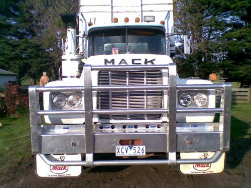

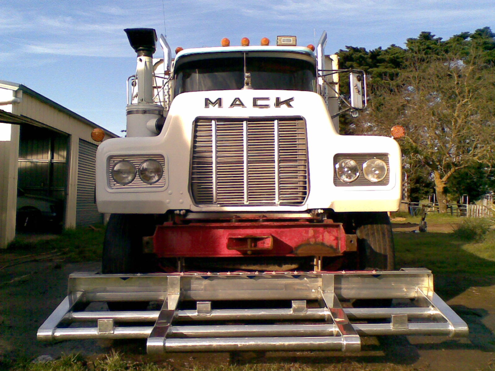

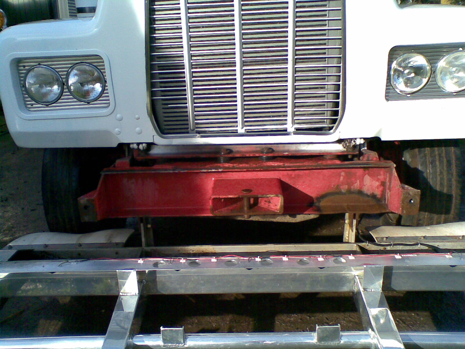

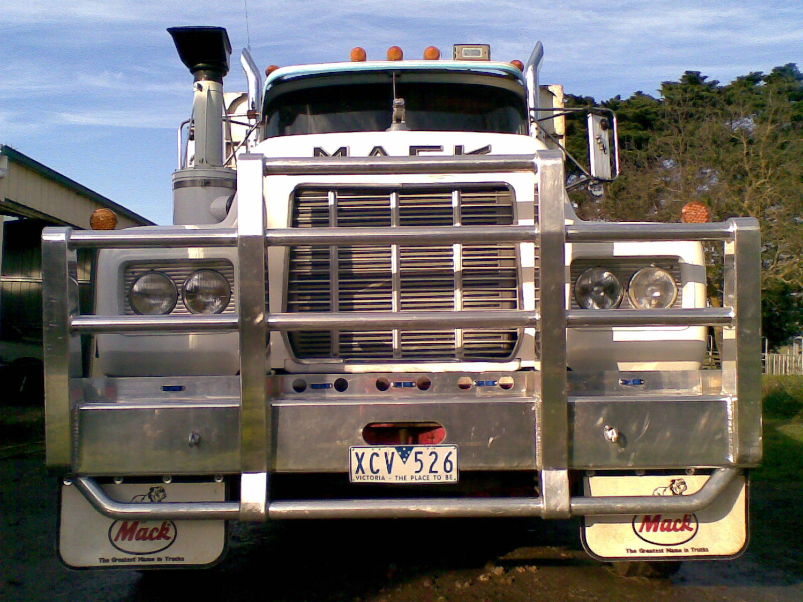

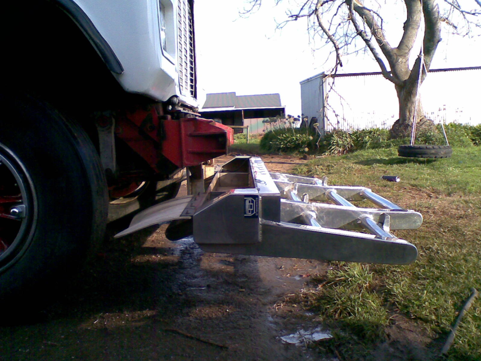

here are the pics of my bullbar mounts, i also took a look at that web link, i wonder if anyone down under make the quick release eye bolts they use . my bar cost me $3500 the guy who made it starts with a set design and modifies it to the customers specs thats why the bottom kick rail is angled up and back at the ends because i didnt like the road train look of the straight rail with the end uprights protruding downwards, it also gives me a slightly better aproach angle for the onsite / off road work i do . in my personal opinion my bullbar is one of the best ive seen on a r model, others ive seen are either a full heavy road train 5 post style or a big pipe rectangle type which i think look awful . a bullbar also squares off the looks from the front almost making it look like a superliner from a distance, it really does completly change the looks as you will see in the pics with the bar down and up. if i can help out with more pics or anything let me know.post-3922-127452235067_thumb.jpgpost-3922-127452239941_thumb.jpgpost-3922-127452259761_thumb.jpgpost-3922-127452243888_thumb.jpgpost-3922-127452249766_thumb.jpgpost-3922-12745225477_thumb.jpg
