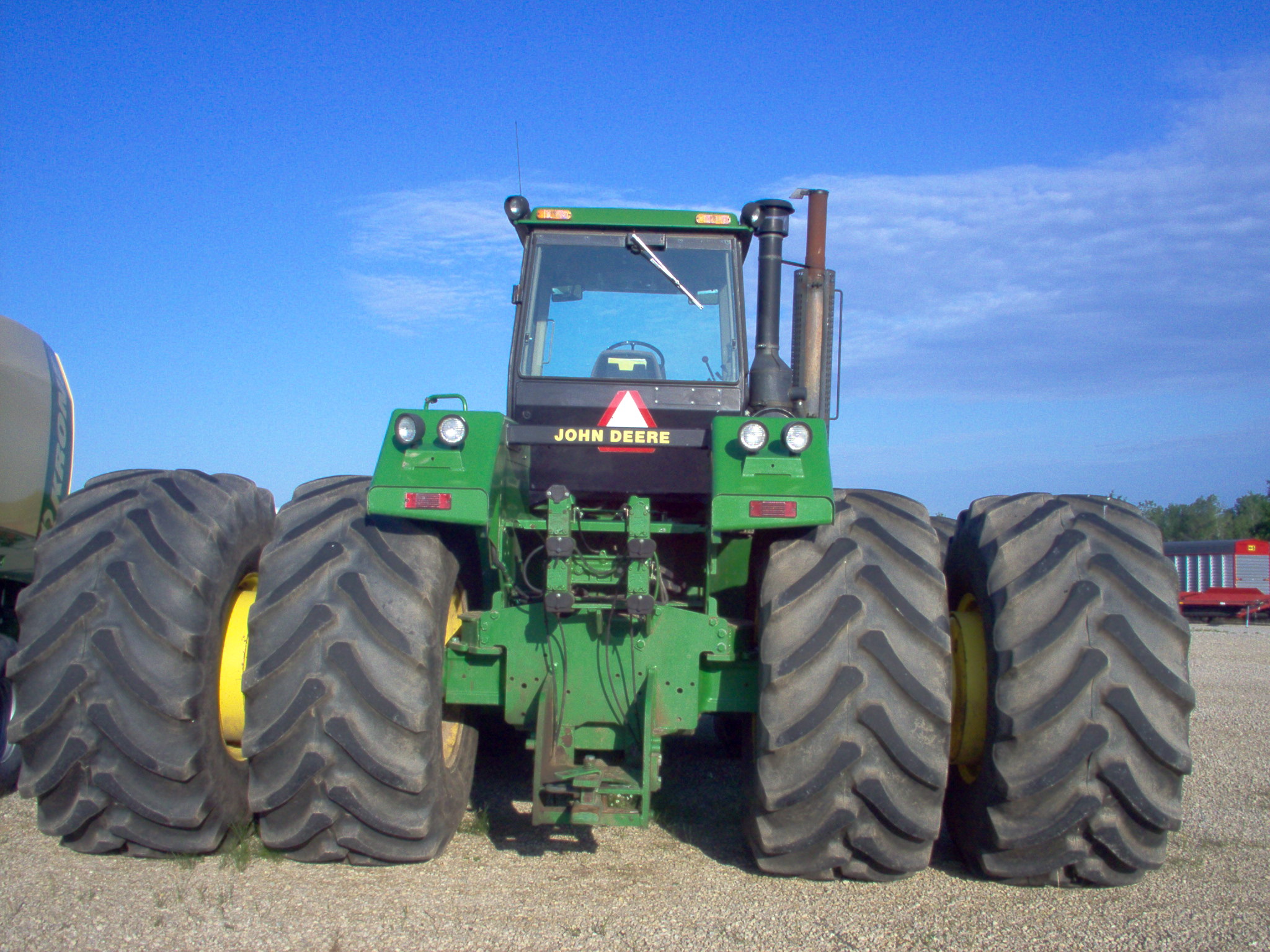

With the increasing price of steel, I save every usable piece, because I would rather build something out of material that I have on hand. Several years ago, when having come face to face with the task of mounting 8 new drive tires, I made my own tank with all new stuff from the local hardware store. A new 10 gal. tank, a piece of 2 in. black pipe and a new gate valve were about $55. I still remember one of the last times that I used ether. I remember standing with my eyelashes, eyebrows, and all the hair on both forearm's singed off, laughing and saying thank you Jesus, I am still alive and I can still see.
I've singed the hair on my arms more times than I can count...but NEVER while seating a bead with ether. I've even got the hair on my face and head a few times...but again, never while trying to seat a bead with ether. For as much as I've played with fire, it's amazing I don't have more scars than I do...and amazingly enough, the only fire scar I DO have is when I burned off a mosquito bite that was buggin' me. I've had my fingers charred by a mapp gas torch...nearly started my room on fire...been knocked on my ass by a large ball of fire...
Yeah, I've had some fun. The guys I hung out with in school didn't mind fire, either. I remember one buddy laying under his 77 T-bird fixing a leaky fuel tank...fuel running up his arm....lit cigarette hanging out of his mouth.smoke.gif
You know what's really fun, watching the tire guys seat tires like these using ether...a LOT of ether.
