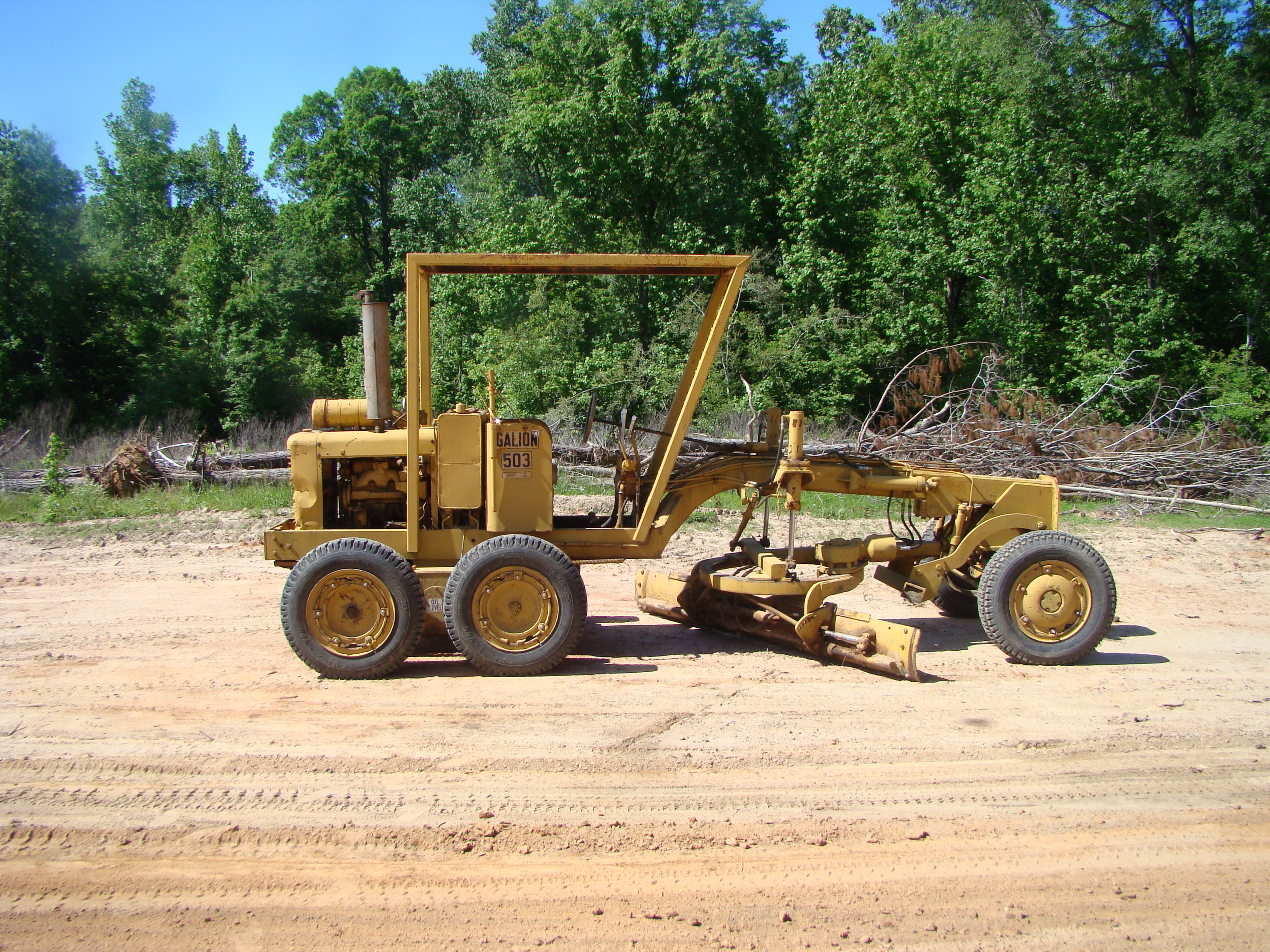

I recently bought a Galion 503 series A with GM-353, 3 speeed forward 1 reverse manual, according to serial number either late 1968 or early 1969. I was checking it out before putting it to work, both tandem boxes a little low, no check plugs on side but atamping on side says where oil level is supposed to be, large 1" fill plugs on top of each tandem box, so devised my own wooden dipstick to get oil levels up, now then, there is a large drain plug at bottom of transmission,but there are no check plugs on either side anywhere I can find, and ii have crawled under it all day looking. The trans has a side mounted shift tower if that helps any, and there are small drain plugs at bottom of each tandem box and a large one in center at back where is guess you would call the differential. I cannot find any other place to check oil in trans, or differential. My question is,,is it possible that this trans, differential, and tandem boxes all share common oil? I have really scratched my head over this one.,,thanks,,,randy

dont know if this helps any but oil level mark on side of tandem boxes is about the middle of the axles,,randy

I love it when a plan comes together, Im in texas, was given a number of an establishment in springdale, ark., called and I had the honor to get to talk to the "GALION GURU" or the "GALION STALLION", and whatever other honors need to be bestowed on him, he got me lined out on above mentioned problem and questions. He even has a few salvage parts I need also,,wow,,so ever need anything galion, or probably anything else too,,,call Meusers tractor and salvage in springdale, ark. Thanks all,,,,randy
