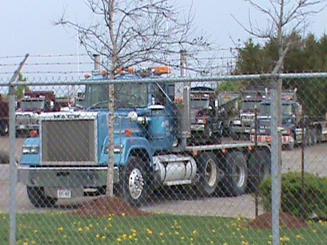

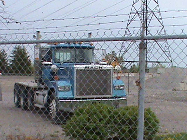

IM gonna stretch it, it needs about 40" put in it. How soon might you have the CH, I will need at least 1 if not 2 cross members, if they are the same? I could use them, help you off set your cost right bobo post-2423-127345810122_thumb.jpg
The frame of the CH is deeper than the RW and will fit over the RW as a second rail. You could use it as a double over the drives and reinforce the splice of your extension.
