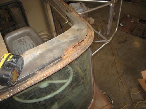

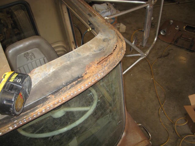

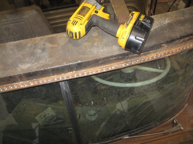

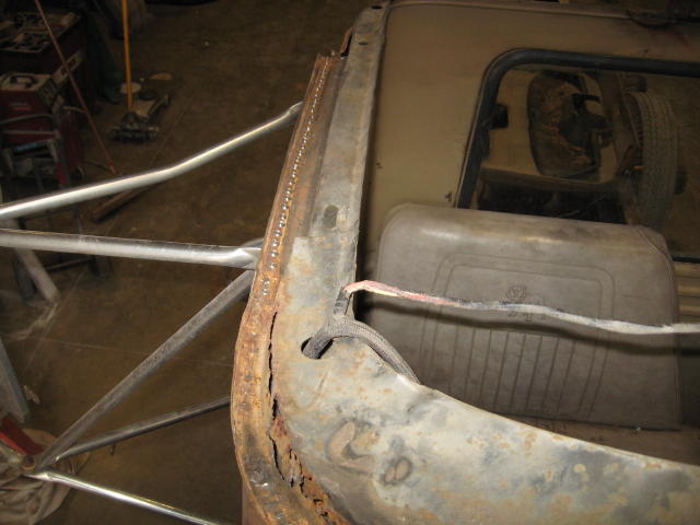

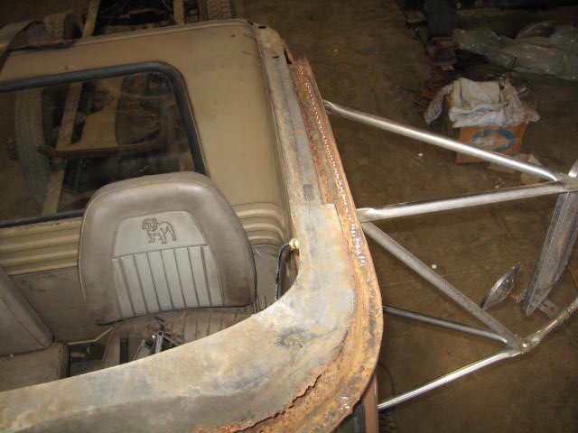

R model roofs are a lot like a Jeep CJ. If you can see rust on the outside. It is much worse on the inside.
This is of course based on my limited experience with the model........
There can be a real can of worms under that skin. The attached photos show common rust areas from both leaks, and roof air units.
Roof skins aren't cheap by any means. I think they run about $600.00 if memory serves. Not too bad of a job just be sure to use a weld through primer, and dump enough rust preventative material into the area from the interior and you'll be fine. Then use a "self leveling" seam sealer in the rain gutter or trough to ensure water doesn't creep under your good work.
You could of course glue the skin down with just a couple of plug welds at all corners but I stick with welding them solid. I've seen too much glue break, or fracture as it does not dry flexible.
