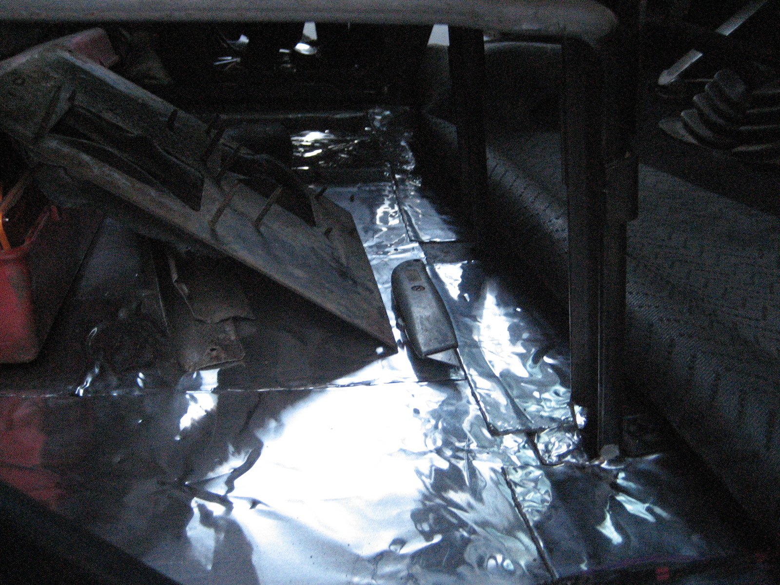

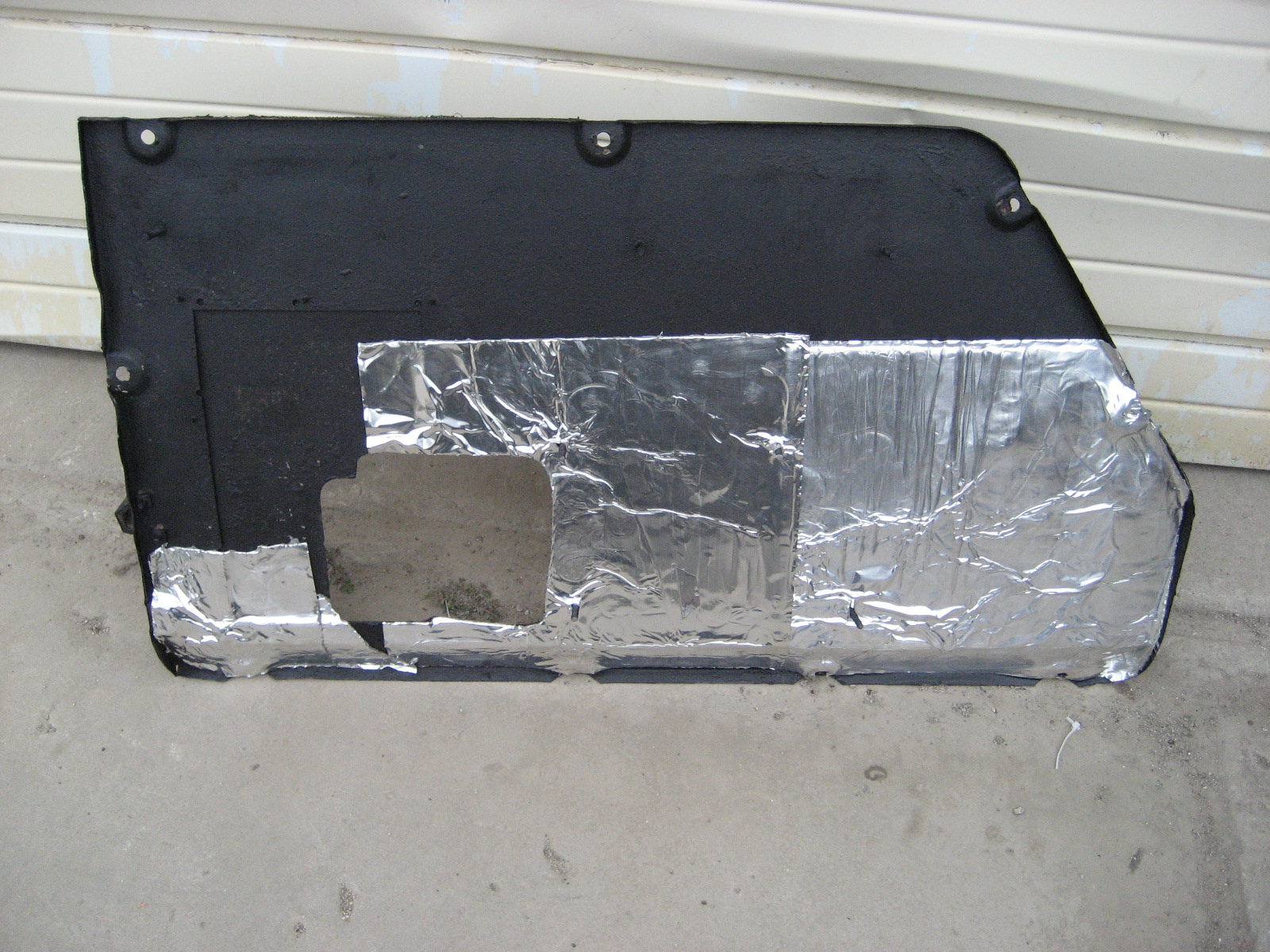

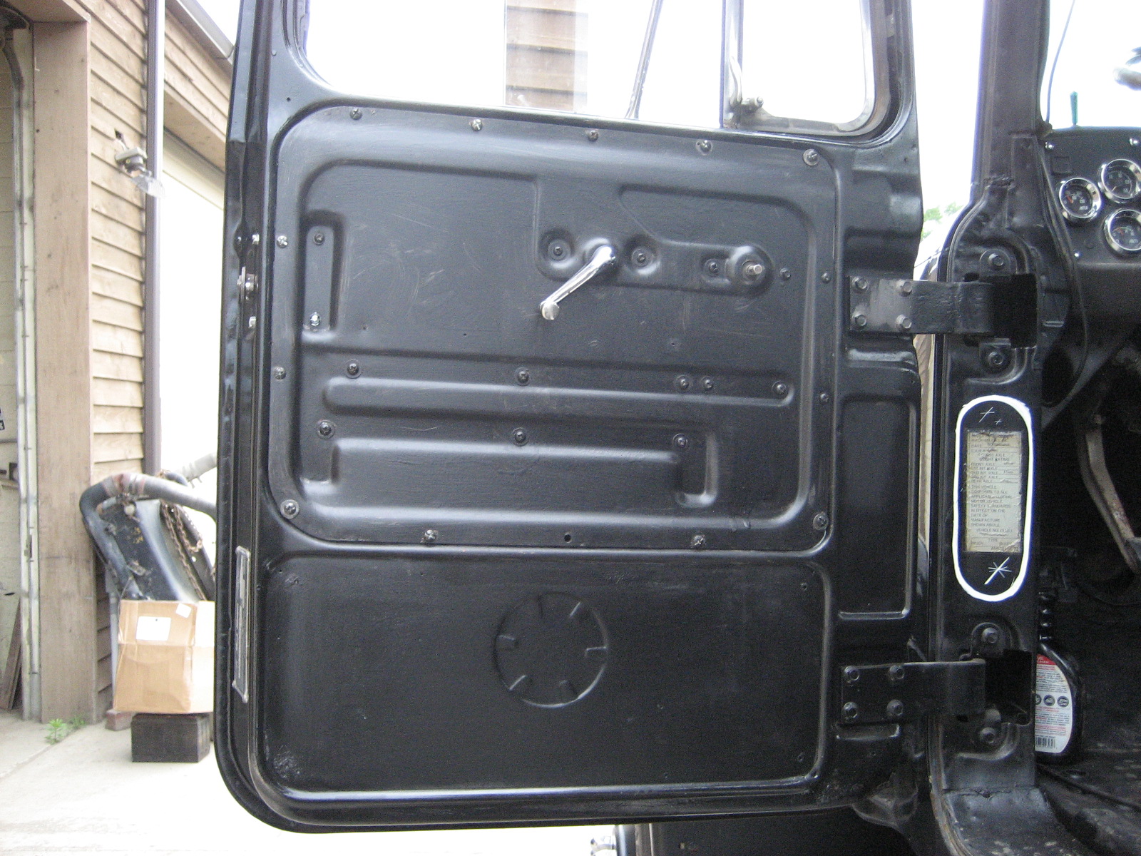

here are the updates on this project
new glass installed on the doors. Rubberized paint, dynamat on both sides of door/floor/firewall along with a 1" thick insulation pad on the underside of floor boards. 1/2" Carpet mat on floor and soon to be on firewall. I really hope all this insulation cuts down sound and keeps it cool inside.

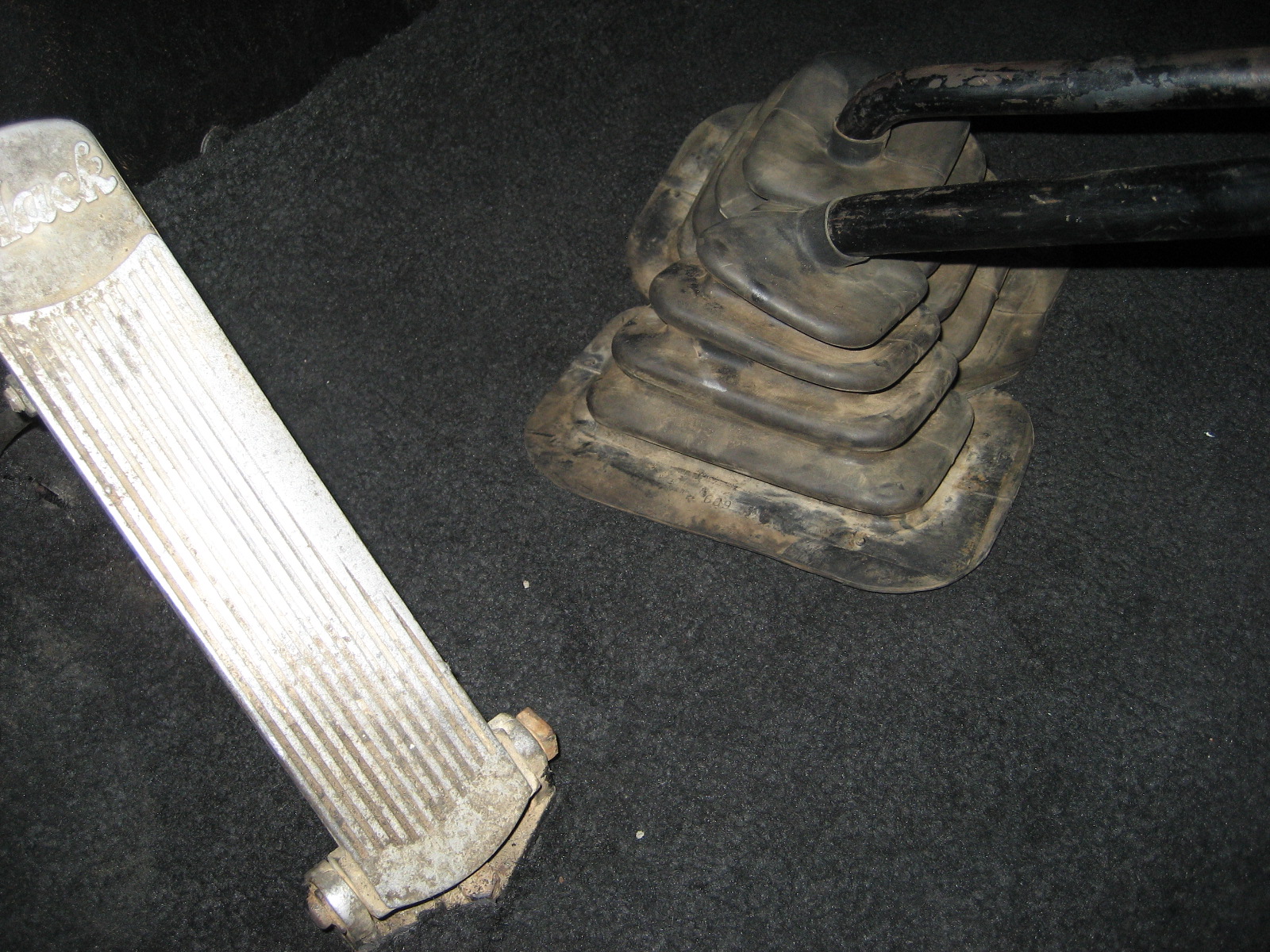

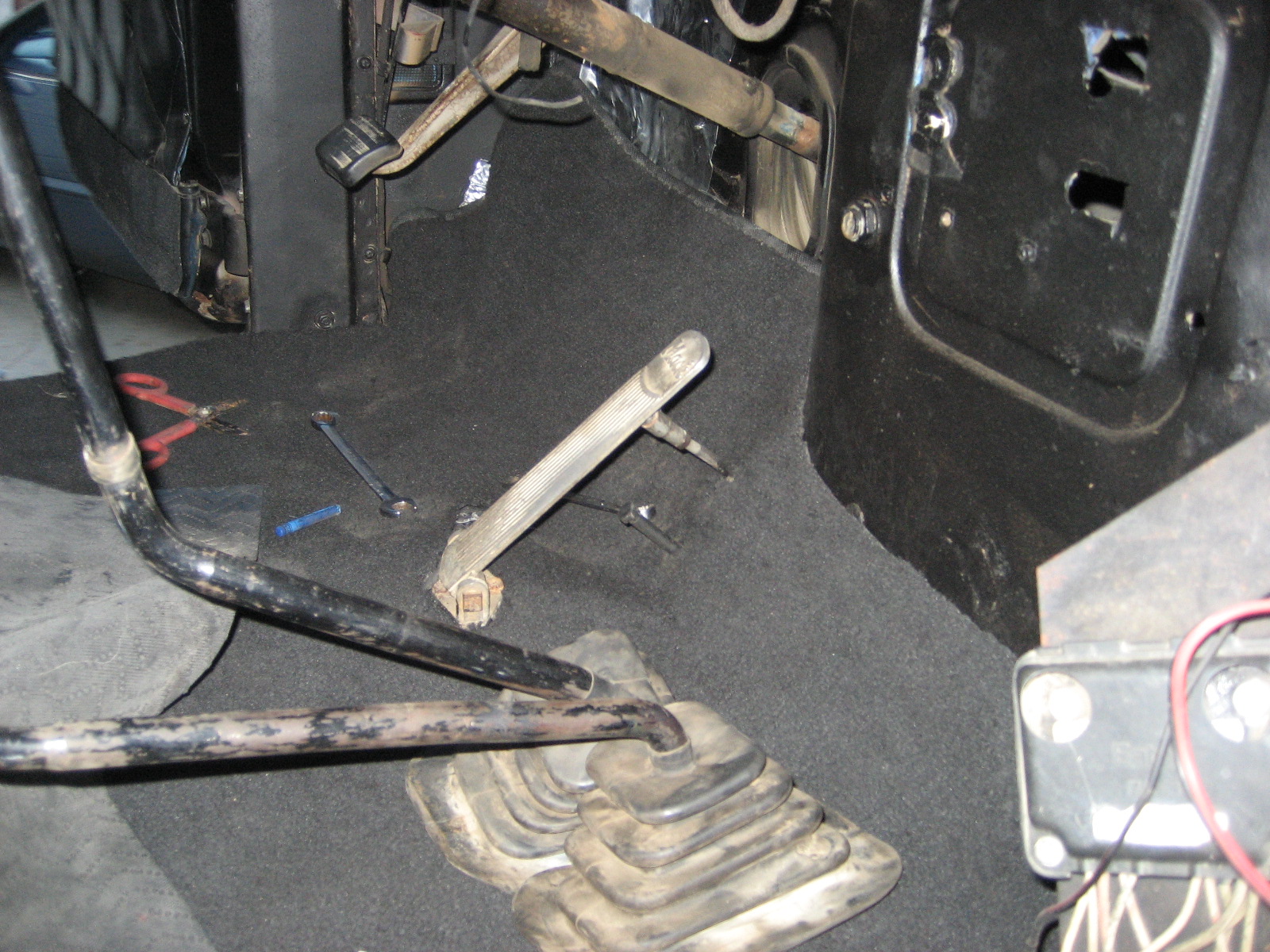

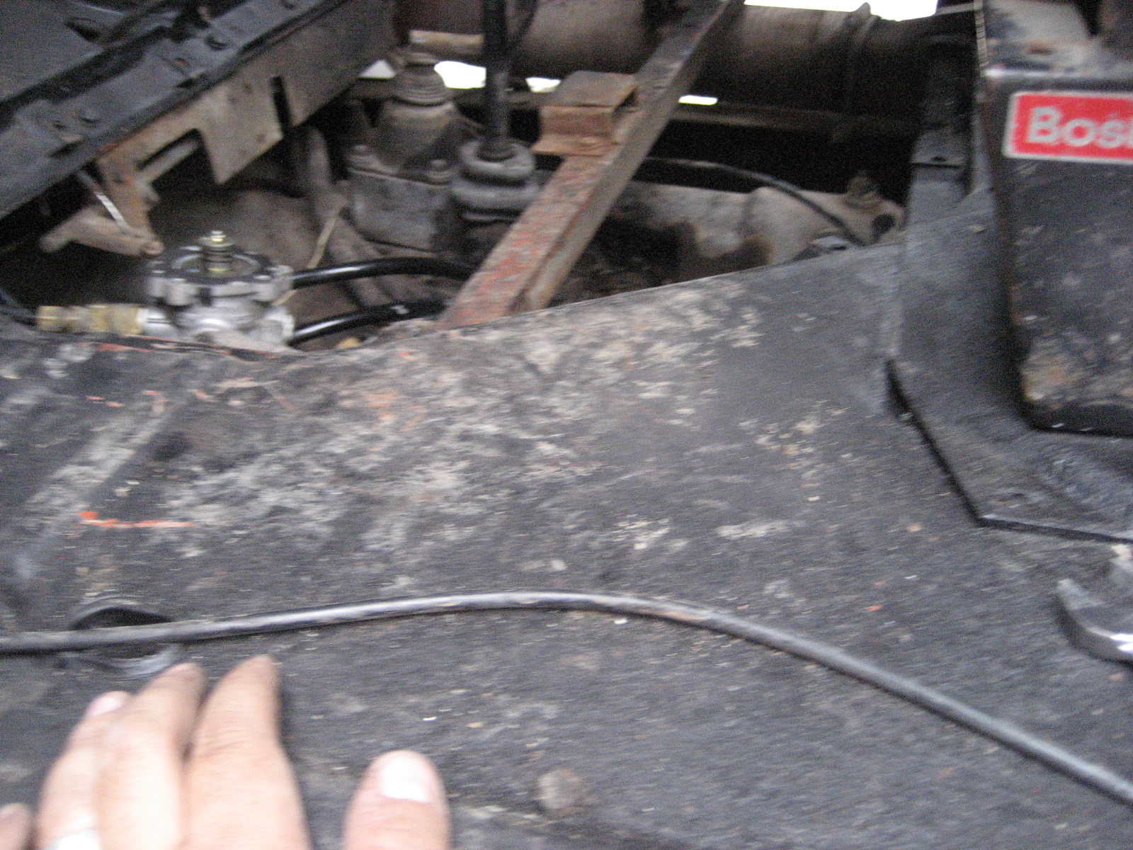

did a little more today.
got the foot valve bolted in and trimed up the carpet. But now it will be coming back out so I can have a Mack Logo sowed into the carpet, and some other little ideas I have .
I added it all up and the floor has 2 layers of dynamat, 1" of insulation. 1/4 sound dead mat, 1/4 carpet.
the fire wall has 2 layers of dynamat and a 1/8 sound dead mat. I will now be making some fire wall panels that can be removed easy for access.
took the truck for a quick spin and it did quiet the truck down pretty good. one more trick I may do is to put a 45" x 45" square of 1" insulation and bolt it to the under side of the hood. And then glue some 12" tall sections to the hood sides.
the truck has factory insulation on the out side of the firewall but its all ratty. I will likely replace that as well. My goal is to just get the vibrations out so that the truck is more comfortable to drive. Air ride cab will be next as that will also save my back. this truck just rides hard and is not fun without a trailer!
