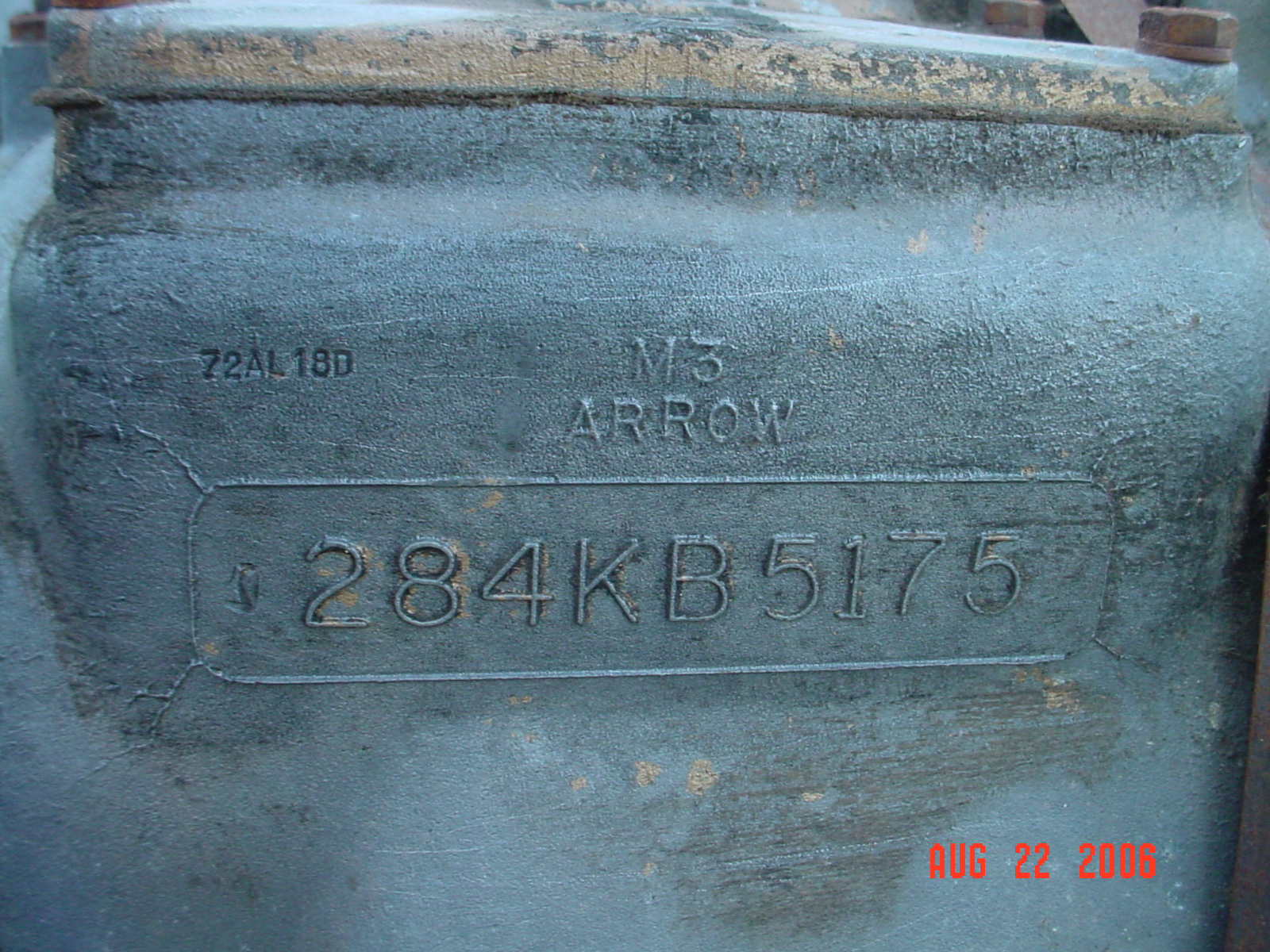

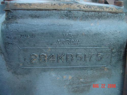

Can someone help me with the transmission ratios for this trans. The only numbers I can see are as seen in the picture. I am told it came out of a mid 80's R model. I am looking to see if I can use it in my B-61 to replace the TR-72. I am hoping it has a .86 final ratio. My TR-72 is 1 to 1 in the final and coupled to the 4.6 rear, my top speed is only 52mph. I am not sure it will even bolt up to my 673. Any help would be greatly appreciated as I can not sipher any of the numbers on the casting to the service manuals that I have. Thanks.

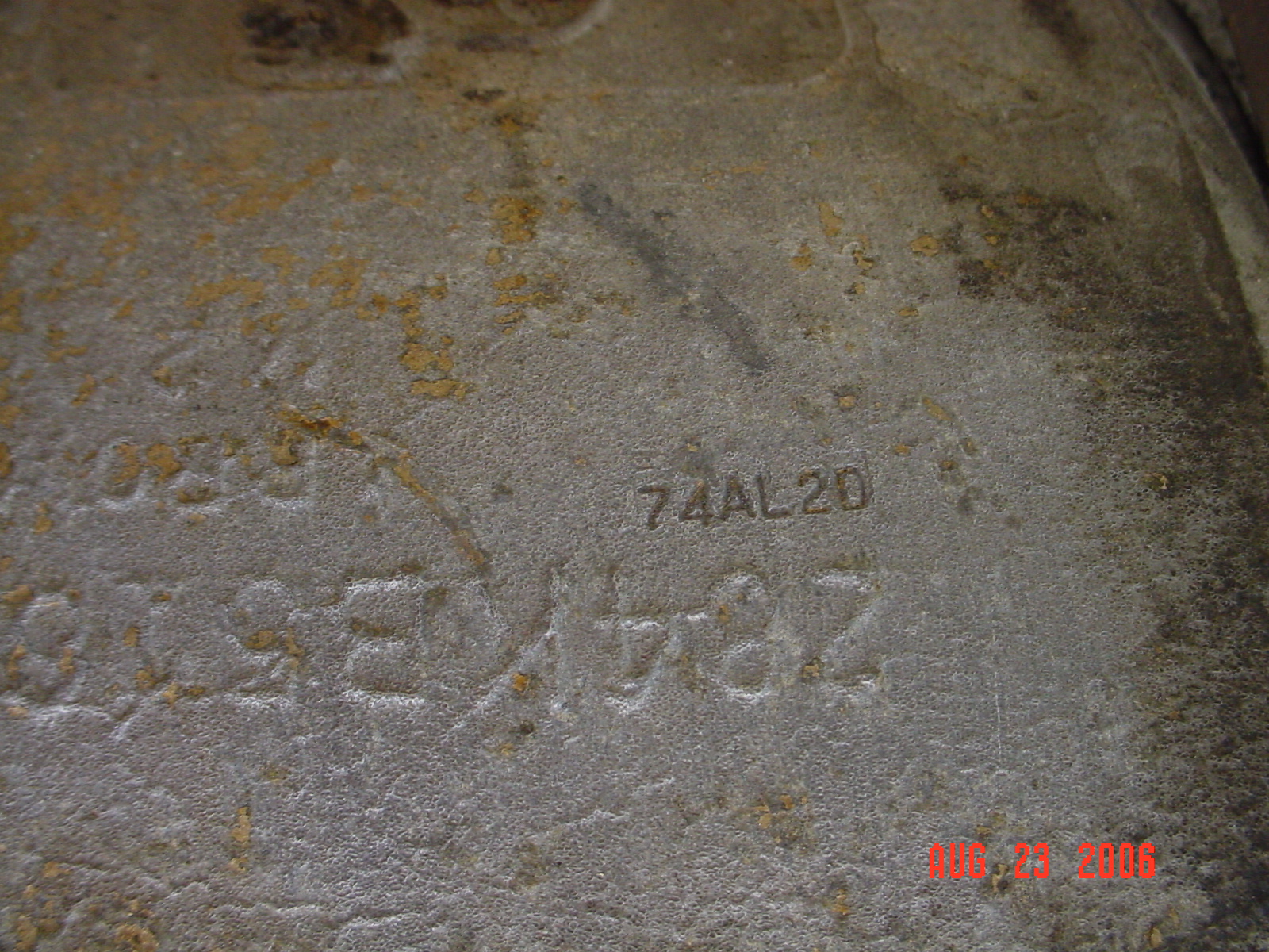

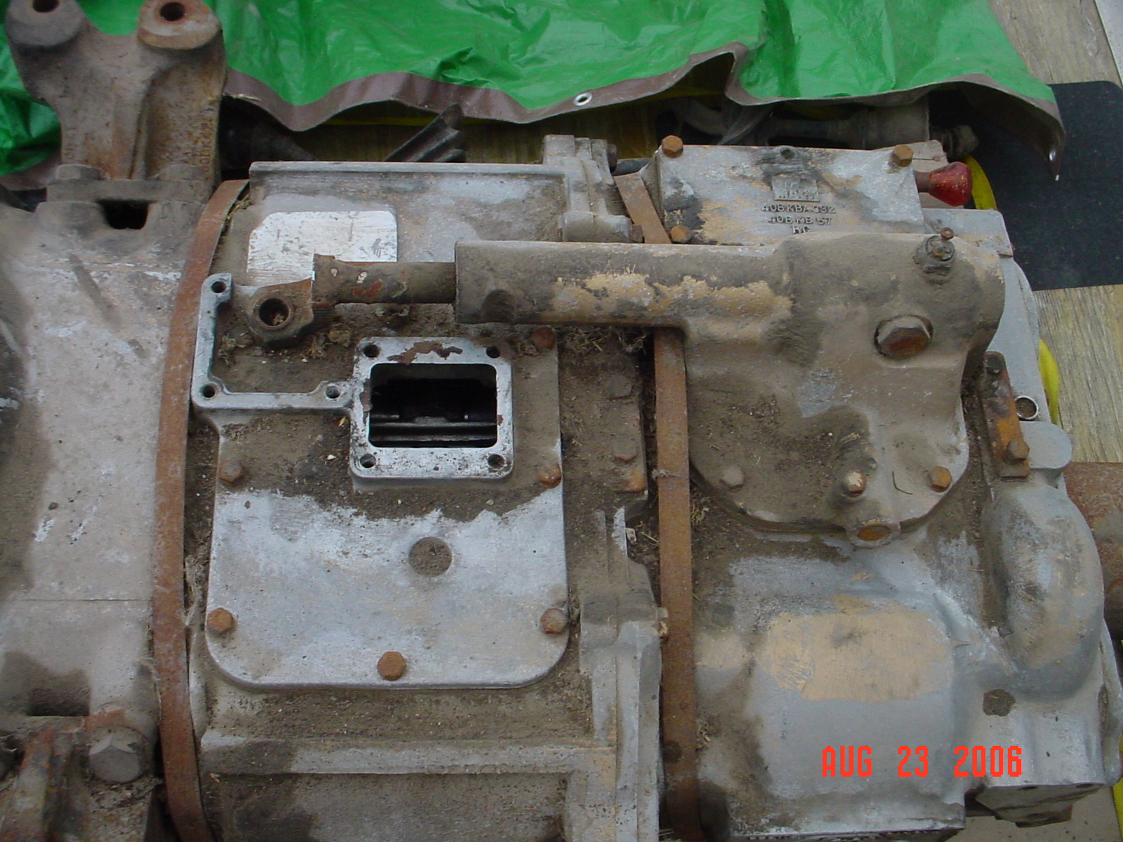

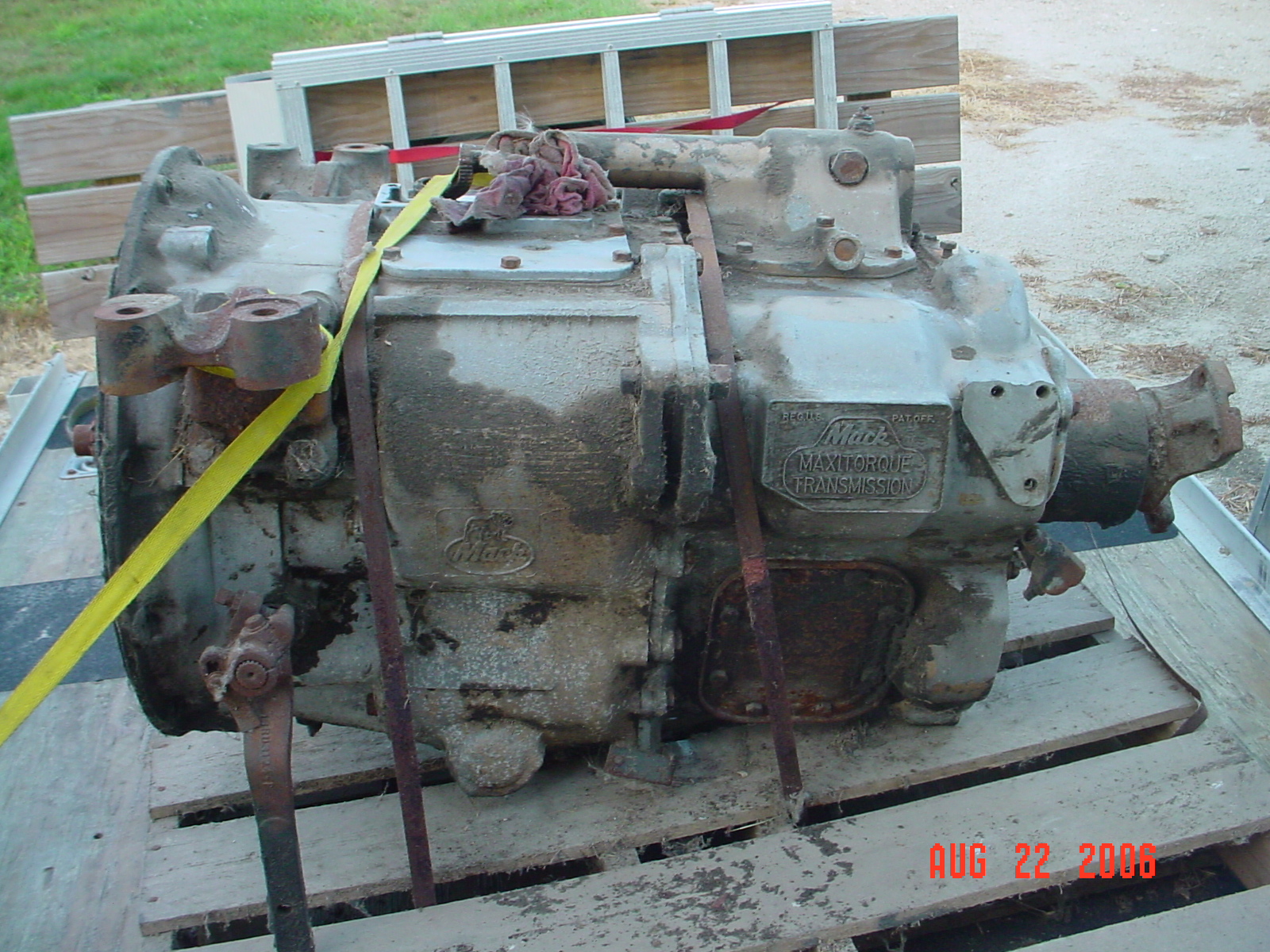

Hi all. It is a 2 stick. I have attached more pics. There are some numbers stamped on each side that are not the same. It has some alum grinded off of the case where the numbers I believe should be. Looks like a coat of gold paint on under the oil and grease.
it looks to be a six speed which has a 1 to 1 last hole. if you can post the 11kb number that is on the case then we can identify it. :chili::thumb:
The KB #'s are on the right rear of the pic of the stick mounts.
408 KBA ?32
408 KB 57
RC
Does that help identify it.
cheers
barry

That trans in the photo is a TRXL 107 or TRXL 1071, both of which have 1.00 to 1.00 (direct drive) ratio in high gear.
The difference between the 107 & 1071 is that the 1071 has a much deeper reduction when the compound is in LO LO, other than that they are the same.
These were known as 6 speeds, because Mack recommended that lo lo on the compound only be used in first gear, then when the compound was in direct the trans was operated like a 5 speed, for a total of 6 actual usable ratios.
(I've cheated quite a few times & used 2nd gear lo lo if necessary)
Reverse gear was also on the compound stick, and you could use any of the 5 main gears while in reverse.
Clean off the area next to the oil filler plug, the model # should be stamped in the case there.

Thanks guys for all the info. I will clean it and check to see if I can get the right numbers. Sounds like it will not give me the lower ratio than 1 to 1 that I am looking for. I will have to start looking into rear carriers with a 4.0 ratio instead. Just thought I'd try the transmission as it was given to me for free. It was in a pile with 2 other single stick 6 speeds collecting dust in my neighbors barn.
