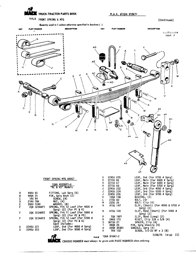

  On 6/24/2010 at 8:59 PM, Barry said:
Hmmm...looks like P5 variation but calls for 11 leaf springs.
Must be a Rockwell 10,500# axle.
Rob

That's what the vin number produced, but you can check the line sheet. Look for the 1QK arrangement. See if is the same as I posted above. 1QK49306P5 If not, I can run the 1QK number from your sheet.
Barry - Watt's Truck Center Parts Manager and BMT Webmaster...1-888-304-MACK
