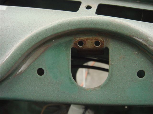

Last night I installed the latch catch with two screws and it still will not catch the lid. I'm wondering if someone had drilled two holes above where metal once was and tried to fix the lid door so it would not fall down? My hopes are for someone to post a photo of their glove box for me to see if I need to cover the area with a piece of metal and drop down and drill two holes lower than the ones you see here?

My lid was stuffed with duct tape for a get me by. I took my g/f for a ride this past week and the lid fell open and luckly her legs were not hit by the lid but came close. So I decided to fix it until I got ready to paint the interior. I've adjusted the lid side to side and up but, it does not fit as it should to cover up the screws at the top that hold the latch.

Cut the damage out, weld some new sheet metal into the area drill and file to perfection. This is a common problem with this setup and the reason a lot of the trucks are missing the door completly.

Rob, that is what was in the back of my thoughts but hoped I would not have to weld in this close area and also has a curved lip where these screws are so high up near this curved area that they show up like a sore thumb even when the door is shut. I'll do it right even if it takes me awhile.

Get you a copper back up plate and clamp it to the backside. Plug weld up the original screw holes, then "noodle" weld additional metal to the lower part of the opening and file off the excess till proper fitment is achieved for the latch. Not too difficult to do really but may take some practice if not used to welding on such thin stock.
Rob
Hey mike,i have done this job myself on a friends B-61, i don't know what your welding capacity/availability is, but this is a pretty straight-forward repair. I used a MIG welder with an angled tip holder,i formed a new piece of sheet metal to mimmic the piece i cut out and it worked like a champ! but, as Rob said, use caution when welding on this thin a metal,its REAL easy to get too hot and burn right through it! (don't ask me how i know that!)..........Mark

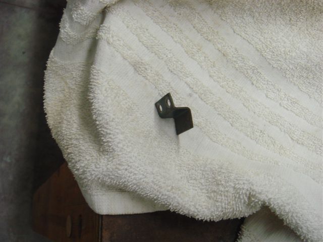

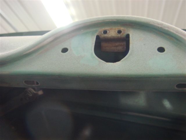

mike - here is couple of pics of mine. aj

i see you said in another post that you had been working on your glovebox. i posted a couple of pics for you and always wondered if you had finished your repair. aj

Very good photo's of your glove box and I appreciate very much, you showing it. The holes on my glove box look to me too high up near the curve of the dash. So i'll weld those shut and make new holes the same size, but lower toward the opening.
