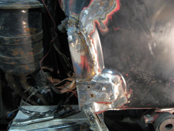

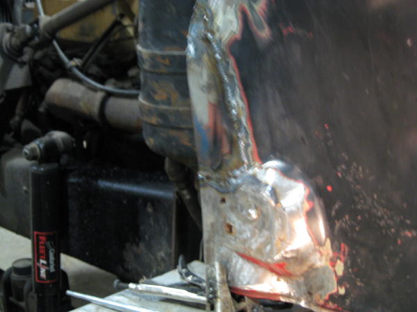

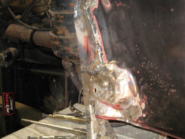

Best I can do with what is stored on this computer. Let me know if you need additional.
Photos of sectioning small area of cab on my R795.
Rob

Hello, thank you. pics are fine, where does that third line go? you have 2 small ones and one large and I see its mounted lower than the pump.
Grant
